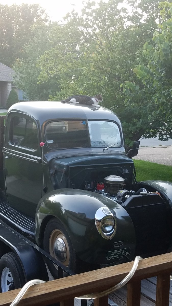

  1. typo41 I had a 62 Buick Electria .I had painted the top white and then the rest of the car metallic blue. My cat back then {Cleo} some how got in the shop and walked on the blue paint {didn't do anything to the blue paint} but left a couple of Blue foot prints on the white top. That was always a hit at the car shows. LOL. Bruce.
