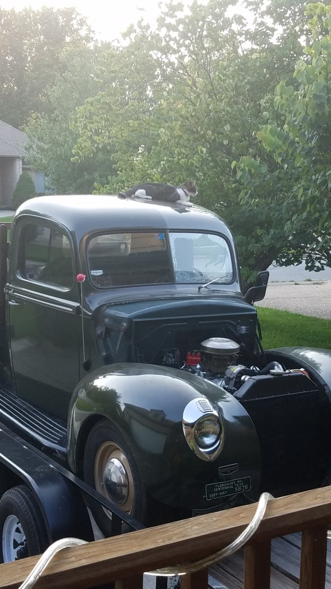

    I have the same problem, everyone of my vehicles have cat slide prints down the windshields
    Speedwrench and bchrismer like this.

  17. The paint on both 40s is already less than stellar, so I'm not too worried about them. Her favorite place to nap seems to be in the driver's seat, but I had the windows rolled up.
