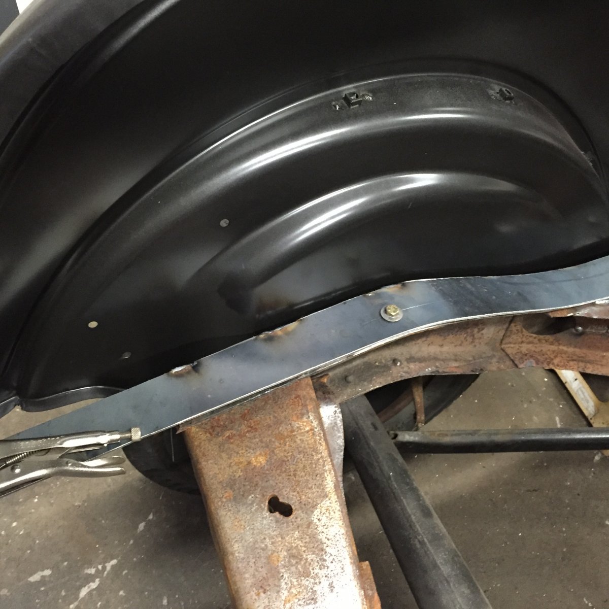

    I can't seem to Load pics in order. Every time I load the them in order, they're in reverse order?

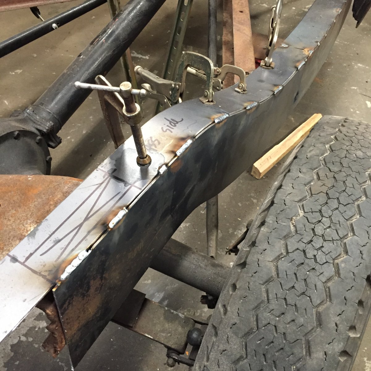

    Anywho, I was able to sneak into the shop today for a few. Finished making the rear subrails and skirts. Bolted them down and mocked the quarters in place.
    Next I'll make the B-pillar mounts so I can bolt the quarters in place.

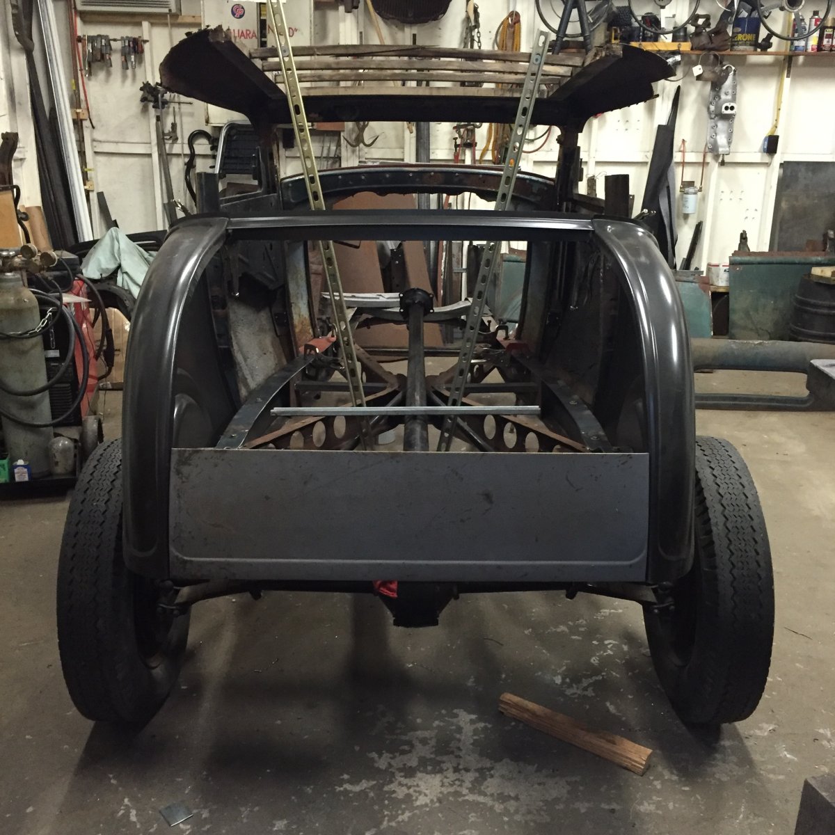

    Quarter panels just clamped into position... The rear ended isn't in position right now so it looks a little funky.

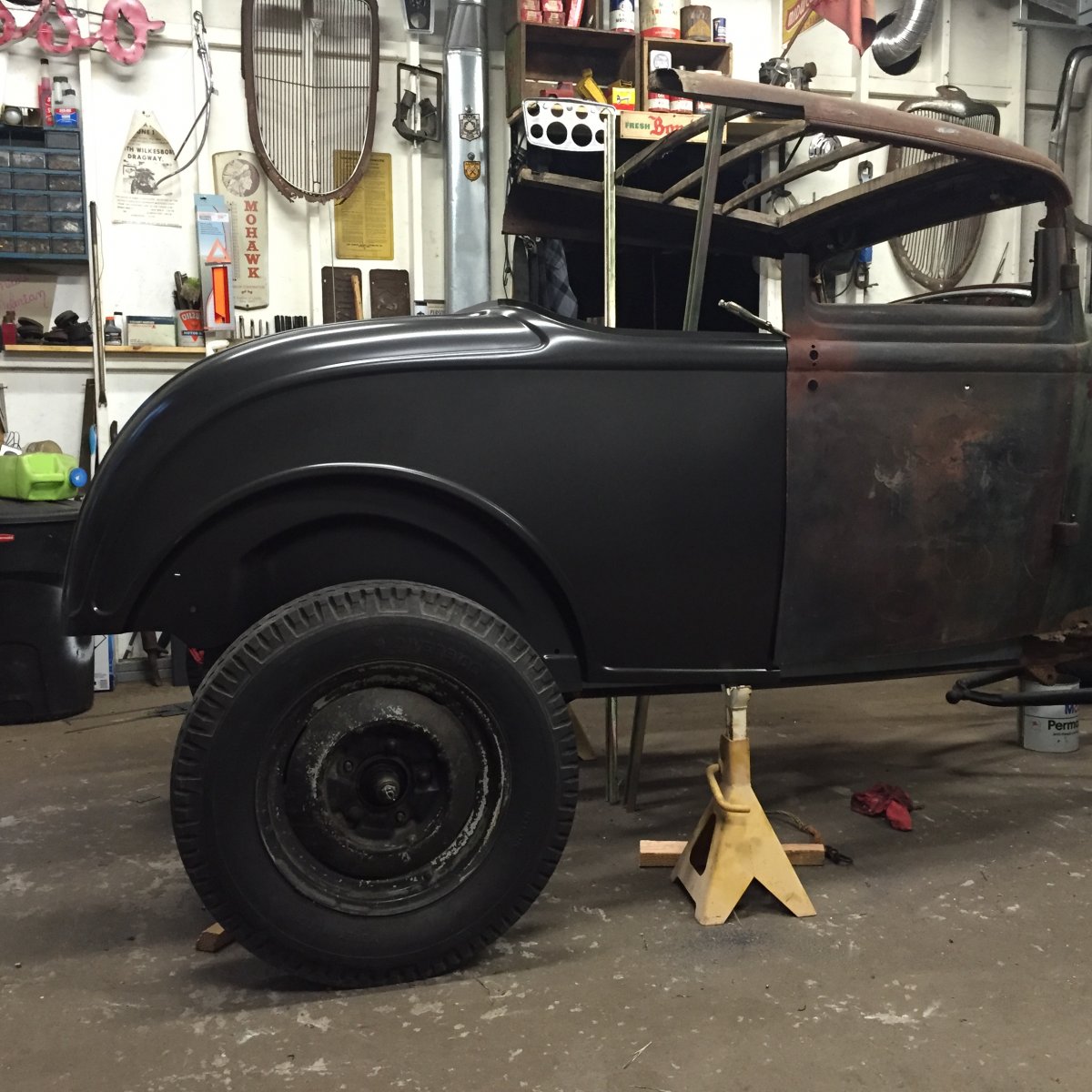

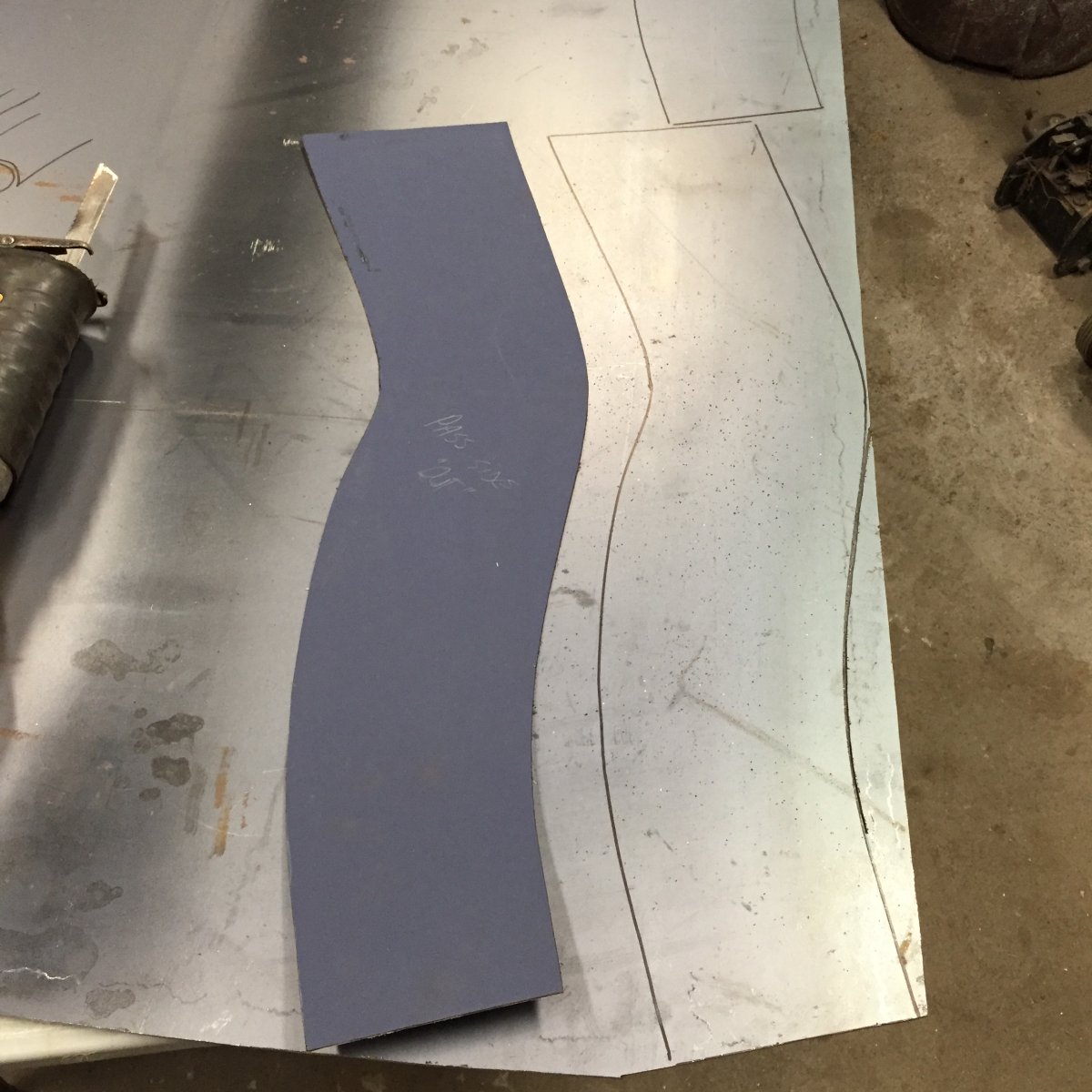

    image.jpeg just some mock up.

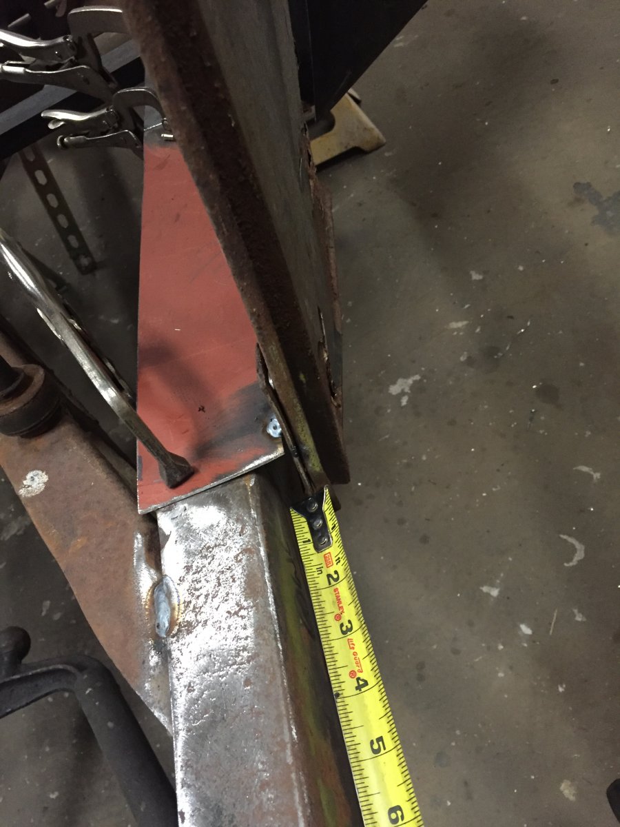

    32 owners..... I'm stuck on one measurement.
    I'm looking for the distance from the cowl band... Not the firewall band.... To the very edge of the front frame horn.
    Like these.

  20. woodbutcher

    Thanks guys. Appreciate you taking the time to
    Measure.

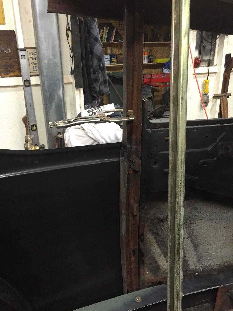

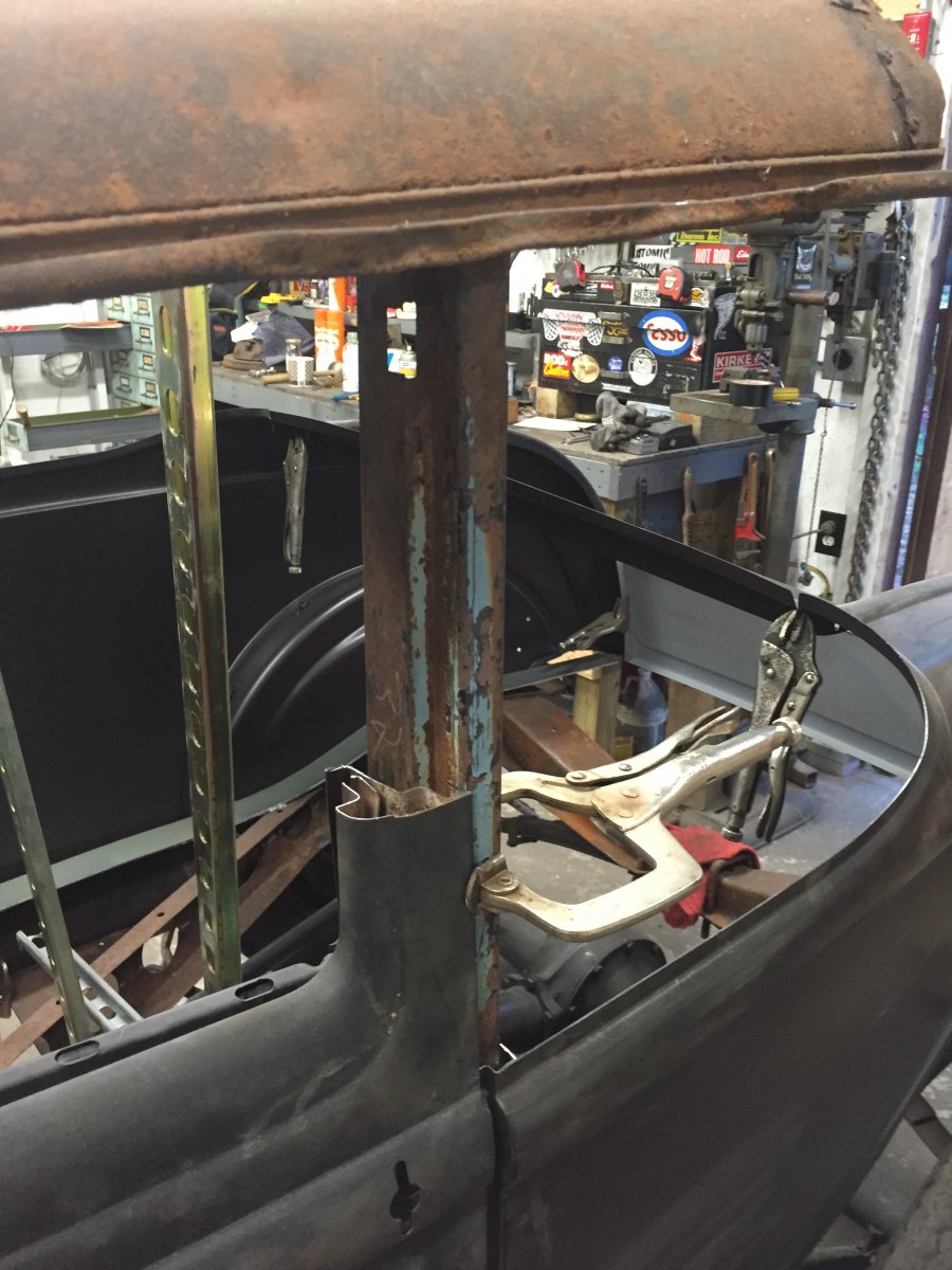

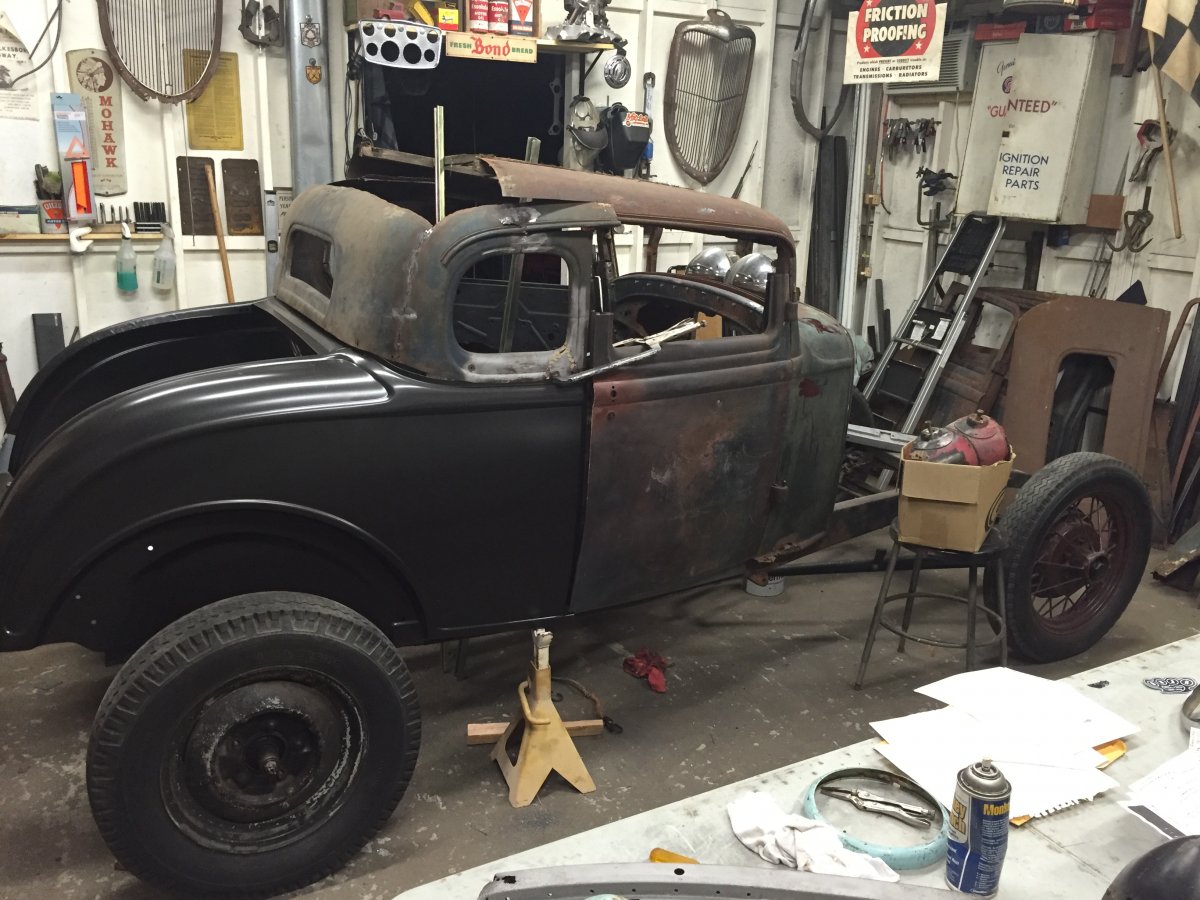

    Alright... So a few questions for the 32 experts.
    Since a stock 32's b-pillars basically sit on top of the frame but slightly outboard... When these cars are Channelled it seems necessary to either slightly spread the pillar outward and down over the frame. I'm sure there's more than one way to do this so if any of you have a suggestion on which is best.... I'm all ears.

    I have to say, the early Fords were built tough.
    It took me the better part of 2 hours to dissect a stock 32 four door sedan B pillar.
    I removed the inner skin so that the upper half of the sedan pillar could be grafted to the lower 5 window pillar. I didn't have the upper half so I had to make due.
