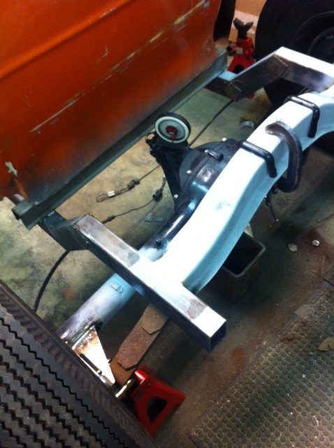

    Got a ton done this weekend!
    Front end pretty much in and done. Still needs shocks, steering, ect.. All in good time.
    Got the rear end spring hangers on and it under the frame too.
    All that equals no stands holding the frame up anymore!
  7. Nice to see that rear end under it. Looks so tough, should be great for roasting tires

  9. Alright. I want my U Bolts back now!
    :rolleyes: :D
    Looks great bud! Now we just need to get you some front tires so you can roll.

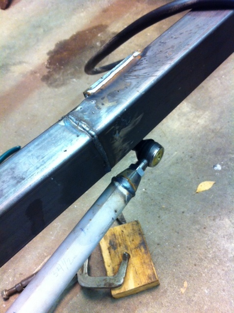

  13. NortonG
    Joined: Dec 26, 2003
    Posts: 2,117
    NortonG
    Weez rules!

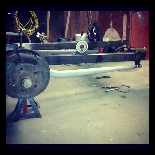

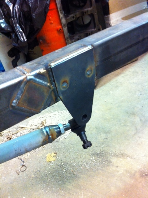

    Heres a better picture of the front bones mounted as well.
    The tie rod ends are tucked up under the frame pretty nicely...

    ....I guess you call that the 'Norton Sweep'.....very cool bones treatment....

    bgbdlinc, those bones are stock late 40's Ford. They have a cool sweep in them stock.
    I like them for more steering clearance.
    Beau, I have a clamp on the front spring to mimic ride height with the weight of the engine and everything on it. I de-arched it and reversed the eyes. Check back in this thread about how I did it. Super easy! It's actually a stock late 40's front spring reworked.

    I saw how you did it. I didn't realize you had it clamped down.
    I'm going to have to pull my spring apart. Mine still looks like a monster truck. my spring is nowhere near the frame, even with a simulated load.

    I'm using a Welders Series flat front crossmember. So, it's got no dip in it at all lowering the front that much more and I de-arched the spring and it's super flat now.
    A bit of a crazy set up but, it should work.

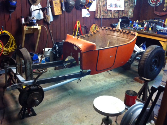

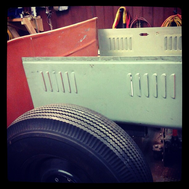

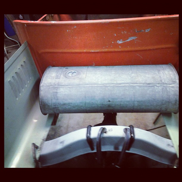

    My Father was getting creative earlier while I wasn't there...
    I think it needs to move down and back a bit.
  23. steel rebel
    Joined: Jun 14, 2006
    Posts: 3,604
    steel rebel
    I don't know I think I might vote with your dad. Look at the Wees photo I posted again. Of course I might be a little prejudice as the guy that started my T mounted the bed pretty high.
    Gary
  24. NortonG
    Posts: 2,117
    NortonG
    Nope, it needs to go down a bit...
    More like this one and less like a "T-bucket"..
