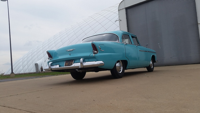

    Just joined. Not easy doing a forum with no computer. Only a phone! Lol. Heres my 55 Belvedere. FB_IMG_1473833586724.jpg

    She is a beauty.

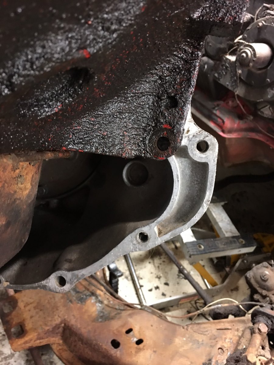

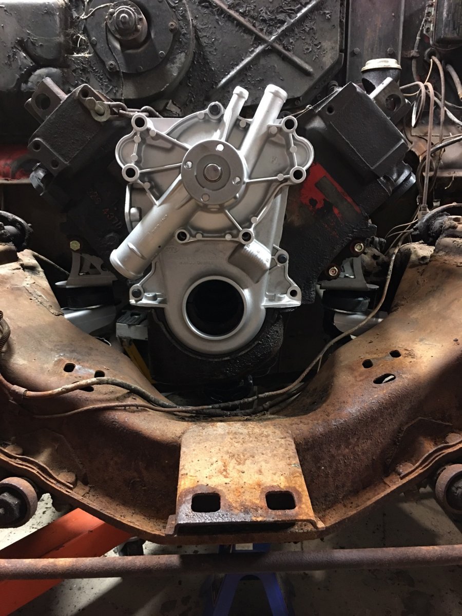

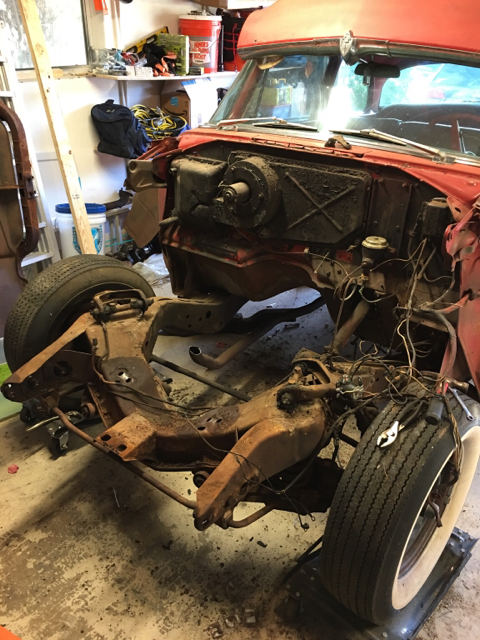

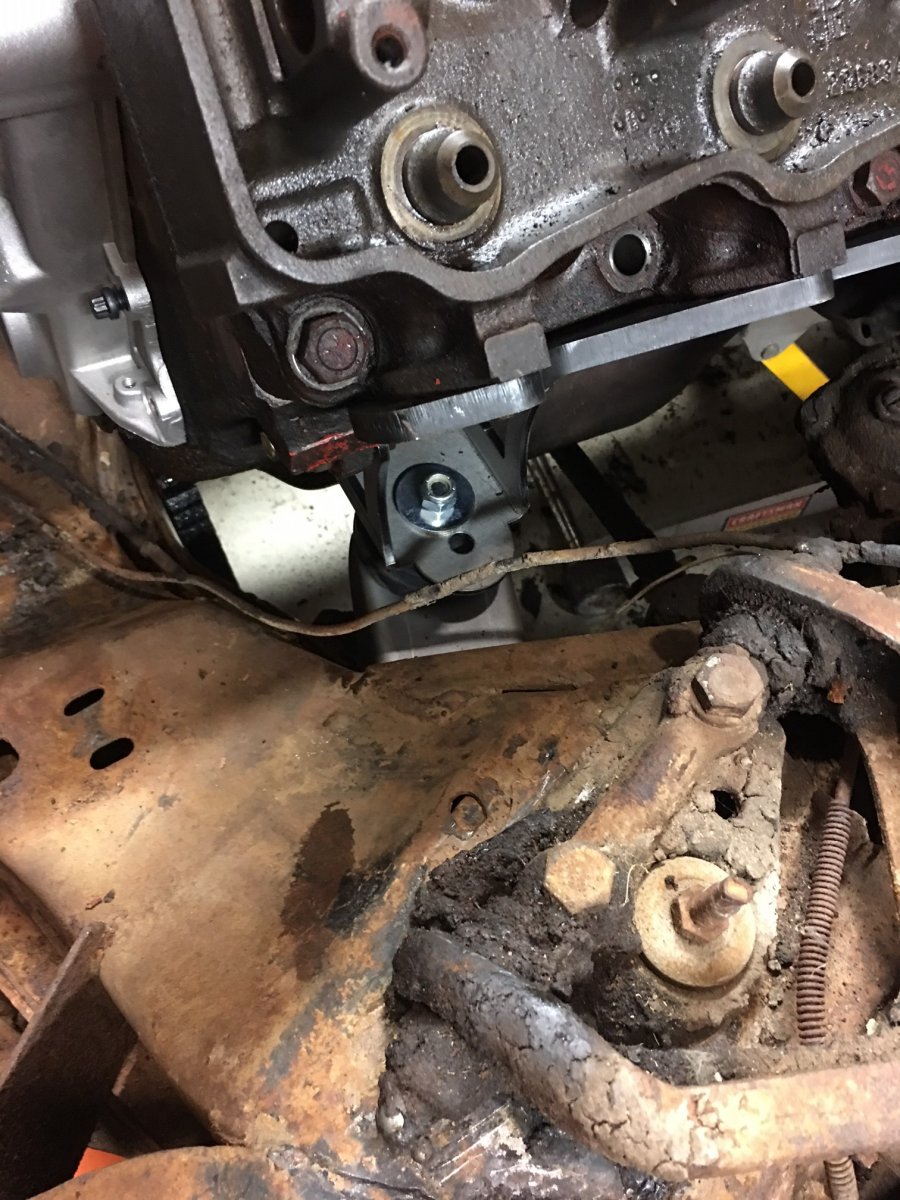

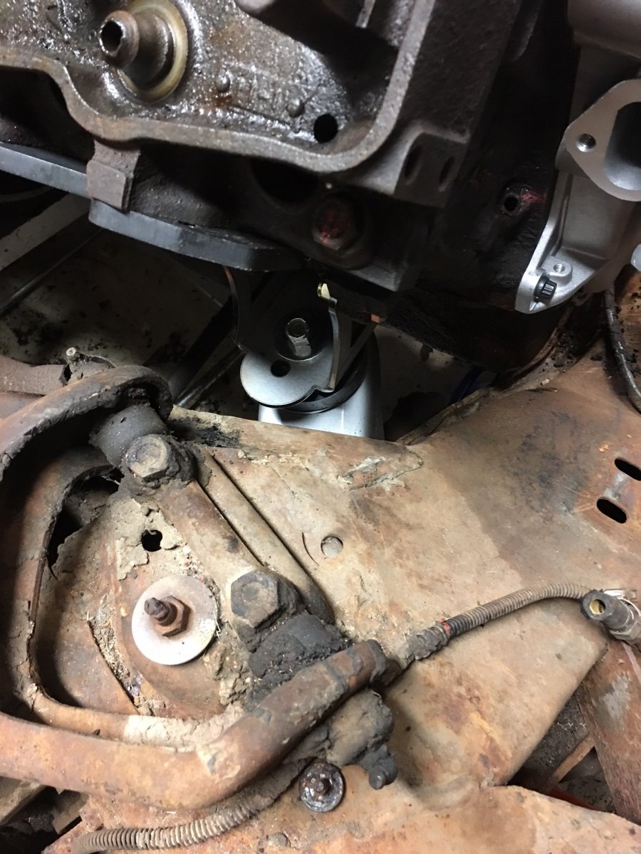

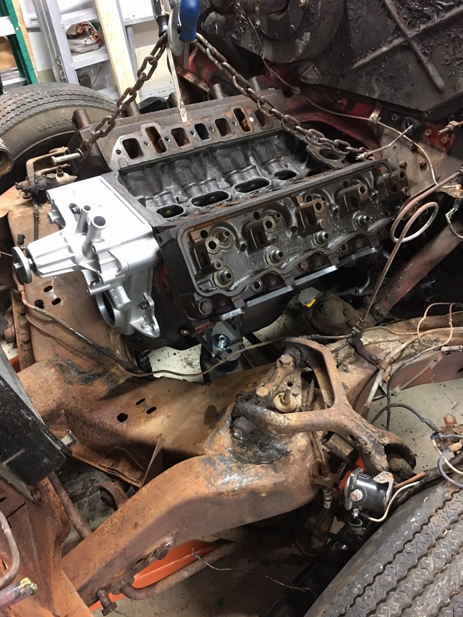

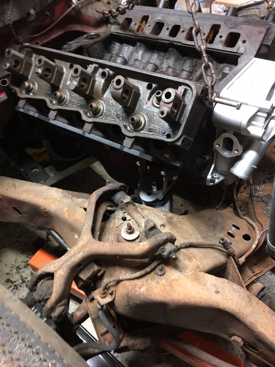

    Well, finally got around to doing some fitting and motor mount mock up for the poly that will end up in my '55 Savoy. The Butch's Cool Stuff motor mount kit really simplified things for me, now I just need to position them and weld them in. I'll be using a 904 trans behind it and the kit came with a trans cross member that will work out well. Only issue for now is that I'll have to do some modification in the starter area as the poly block interferes a bit in that area, but nothing a grinder can't fix. Here's a few pics.

    Thank you for the very nice pics, I haven't got my '56 in the shop yet so it's nice to see where things will go. I'm taking a different route, 5.2 FI magnum (way outside of my comfort circle)!

    In my opinion. Best to go ahead and put on the pan, the crank and the harmonic balancer and pulley along with the steering linkage...there are lots of spots that could interfere...I've been there and done that.
