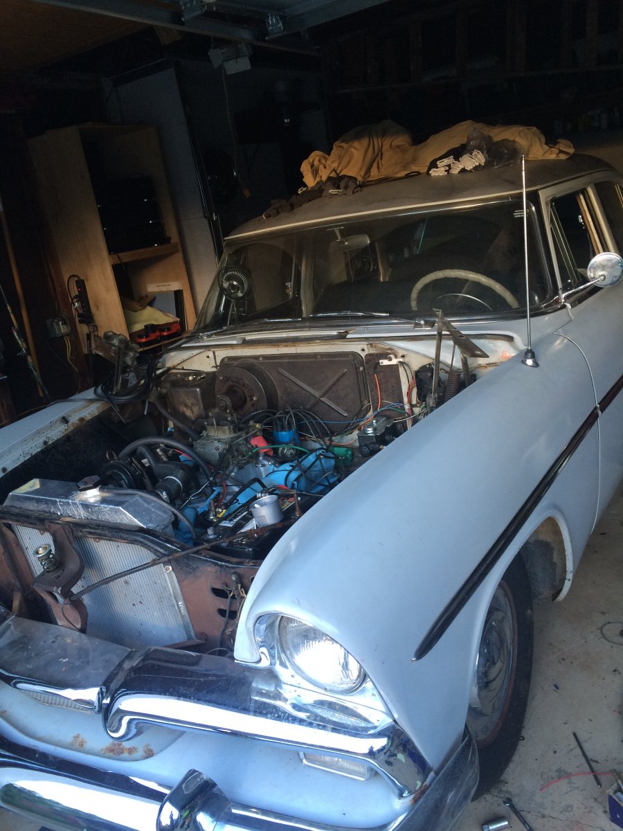

  5. JonnyZ72
    Joined: Nov 27, 2012
    Posts: 45
    JonnyZ72
    Yeah, I bought it on eBay. It fit perfectly & works well, it also has a trans cooler in the radiator.
    The car was a 3 on the tree I home made a linkage & detent to use the original column shifter.

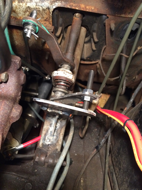

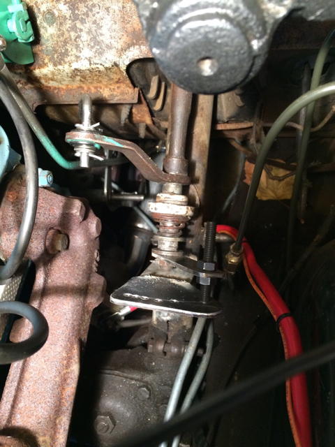

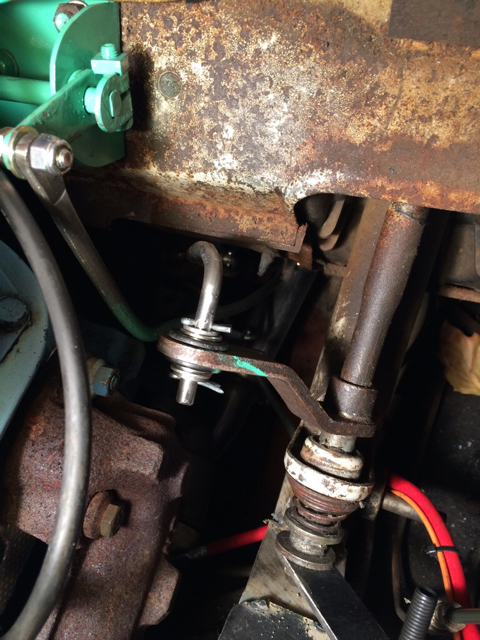

  12. JonnyZ72
    Posts: 45
    JonnyZ72
    These are photos of what I did to use the stock column 3 on the tree shifter. Which I then made shift linkage using mostly original parts (reversing the column spring etc). It works well.

    My welds are shitty (flux core weld) . It's a bit ugly but it works great! & I didn't have to mount a floor shifter. & it was next to free! Pull the lever at you select a gear & go!
