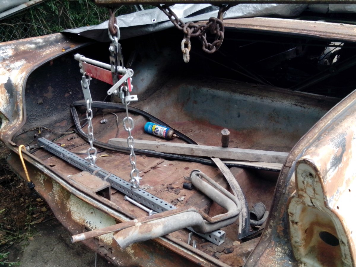

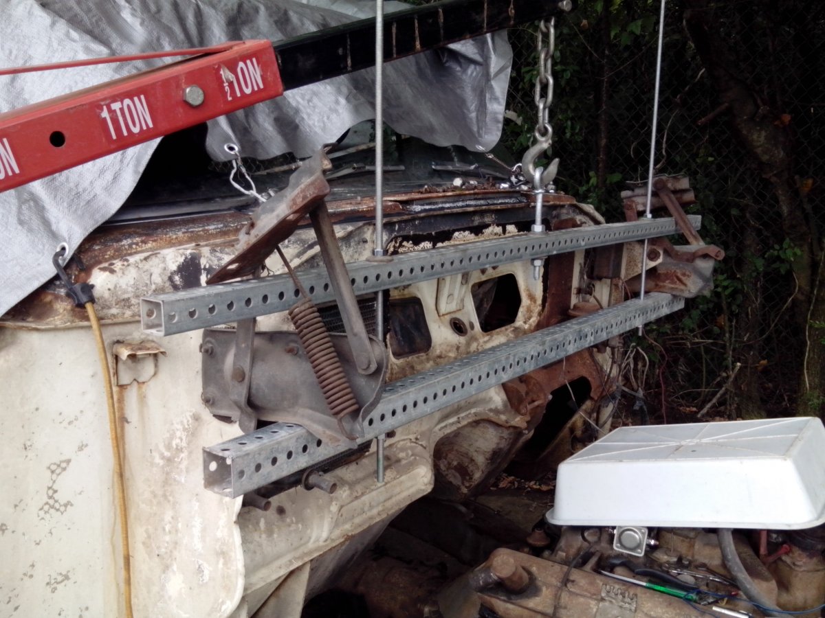

  2. Where it was located - in an open field - was surrounded by junk yards - most of them fenced in. We called it the "bottoms" as it was in flood land right near one of the little forks of the great Trinity river. It's near the intersection of hwy 1382 and Camp Wisdom which is about a mile off of I-20 in southern Dallas. There are still a few grandfather yards in there but the developers have a hold of the rest of the lots.
    Okay I was lucky - sweated bullets for a few years while it sat - the factory tach just sitting there. ALL the trim was off - and just sticking out the back window - even all the factory Fury hub caps were there ! They along with the gold side trim were/are aluminum - so was glad a scrapper didn't get them. The chore trim with all the points were there as well - main thing Fury was the chrome ring that goes on the deluxe steering wheel.
    Anyway was lucky to have my hands on and buy lots of parts cars over the years - with only a little sadness there.
    It had a 354 hemi with an auto in it which had thrown a rod. So already have a nice 277 3sp OD in it now and it yard drives. It was an original three on tree Fury which I have yet to see another - most were auto's.
    Tor into it.....wait until youse guys see the 56 D-500....another small challenge.....oh I'm a 1956 too !

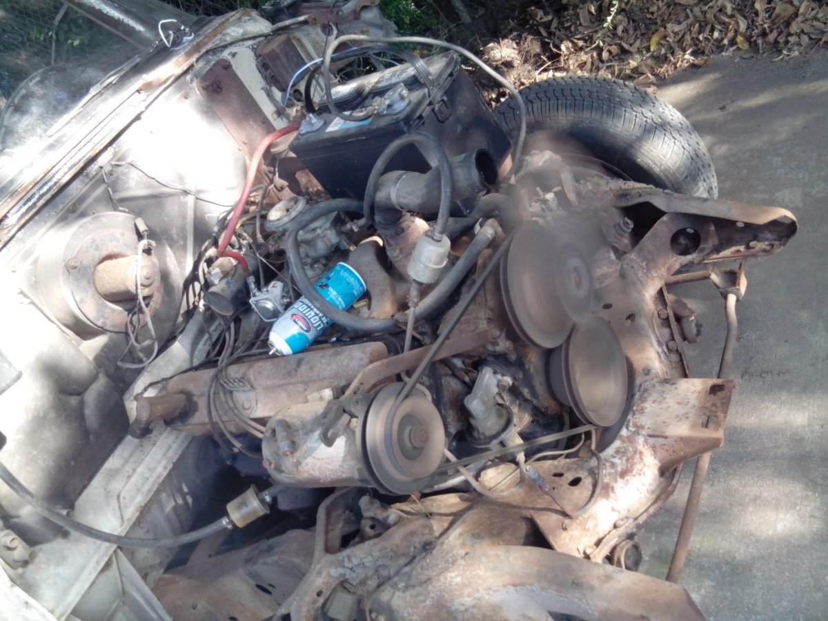

  3. Wanted maybe to show a thing or two about the motors and frame for those doing engine swaps -
    This oil pan came out in 1964 - on the 273 motors - put into A-body mopars and was carried well up into the 70's on the 318 in Darts and other A-Bodies - it should clear those pesky tie rods - but not a 360 pan as they are different. Here a shot of the factory motor mounts - if they were good enough for a hemi back then - finding a NOS set on Ebay would maybe get you going on a V/8 swap. I'll show the Dodge little Red Ram mount later...as the early 53/54 mount will work on the 55/56 frame.

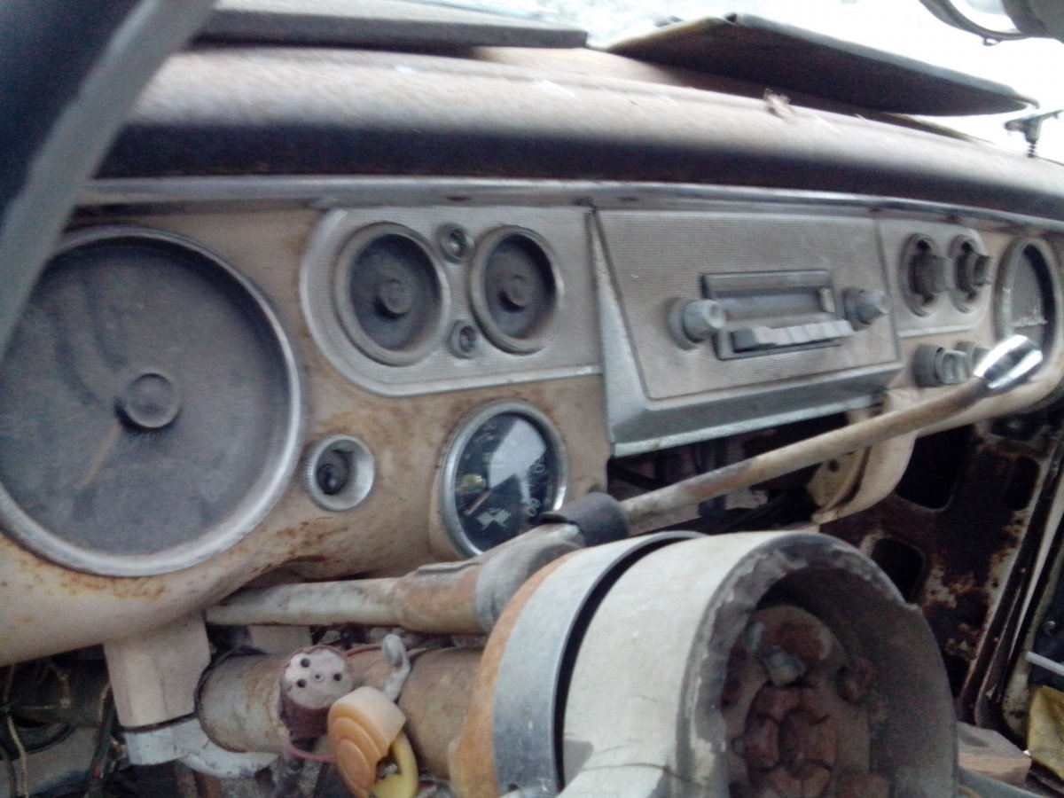

  4. oh...if you didn't know it's a 1956 Fury....last ran about 1977 - they had painted it black with the gold trim - kinda like Smokey and the Bandit ? Funny bought one other car repainted black with gold stripes that was parked in the early 80's. Factory tach - my other bad habit - Studebakers - were the only other family sedan offering standard factory tach's - in the Golden Hawk. The original seats and side panels still have the Fury fabric underneath the black covers they put over them.

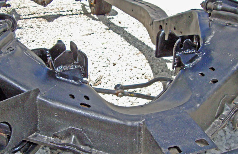

    After I priced replacement motor mounts for my '56 Plymouth, I decided to change them to a more modern standard design that is far less expensive, and available anywhere. I was quoted $450 for a set of stock mounts that had to be sent out to be rebuilt. I got the later model mounts from Rockauto for $16.
    The parts I used for the spool mounts were cut from a late model Ram and welded to the '56 frame.
    There are a few more pictures on my blog: http://56plymouth.blogspot.com/
