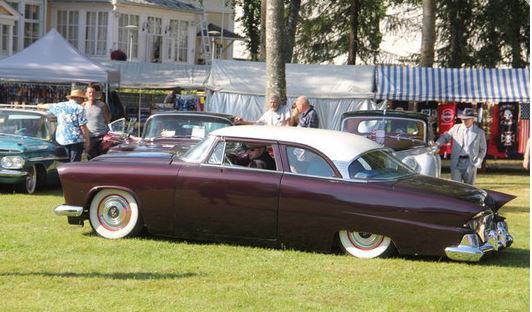

    Here's a 55 DeSoto which I will get tomorrow. Built by Hamber DeS about 11 years ago. Includes a sharp 291 Hemi and lots of body mods.

    OK! You have a sharp ride right there! You must post more pictures than that mister.

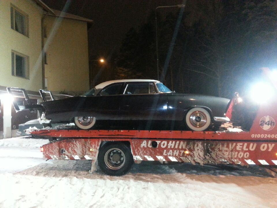

    Thanks. I like it too. I will post more photos when I get the baby home.

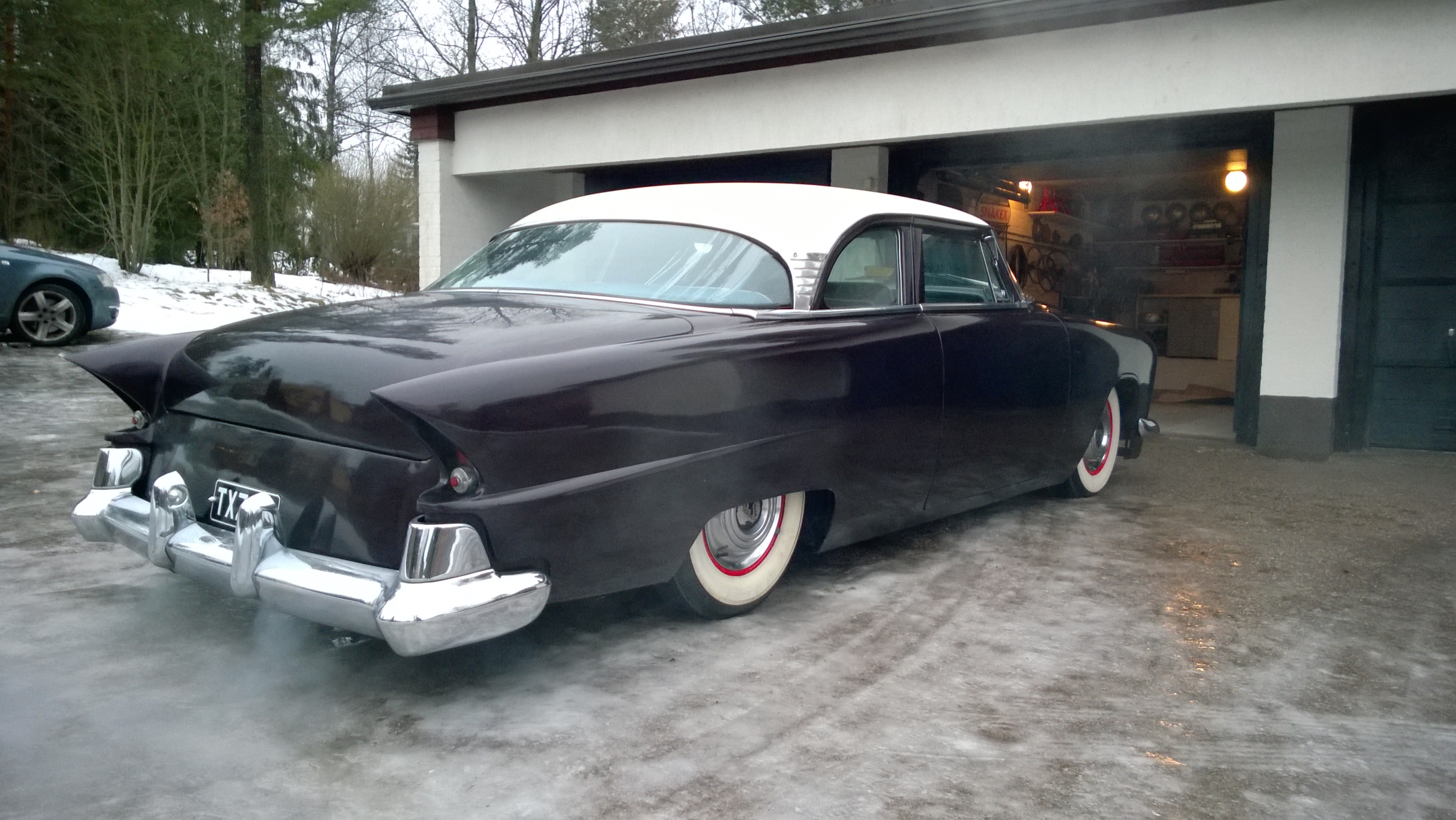

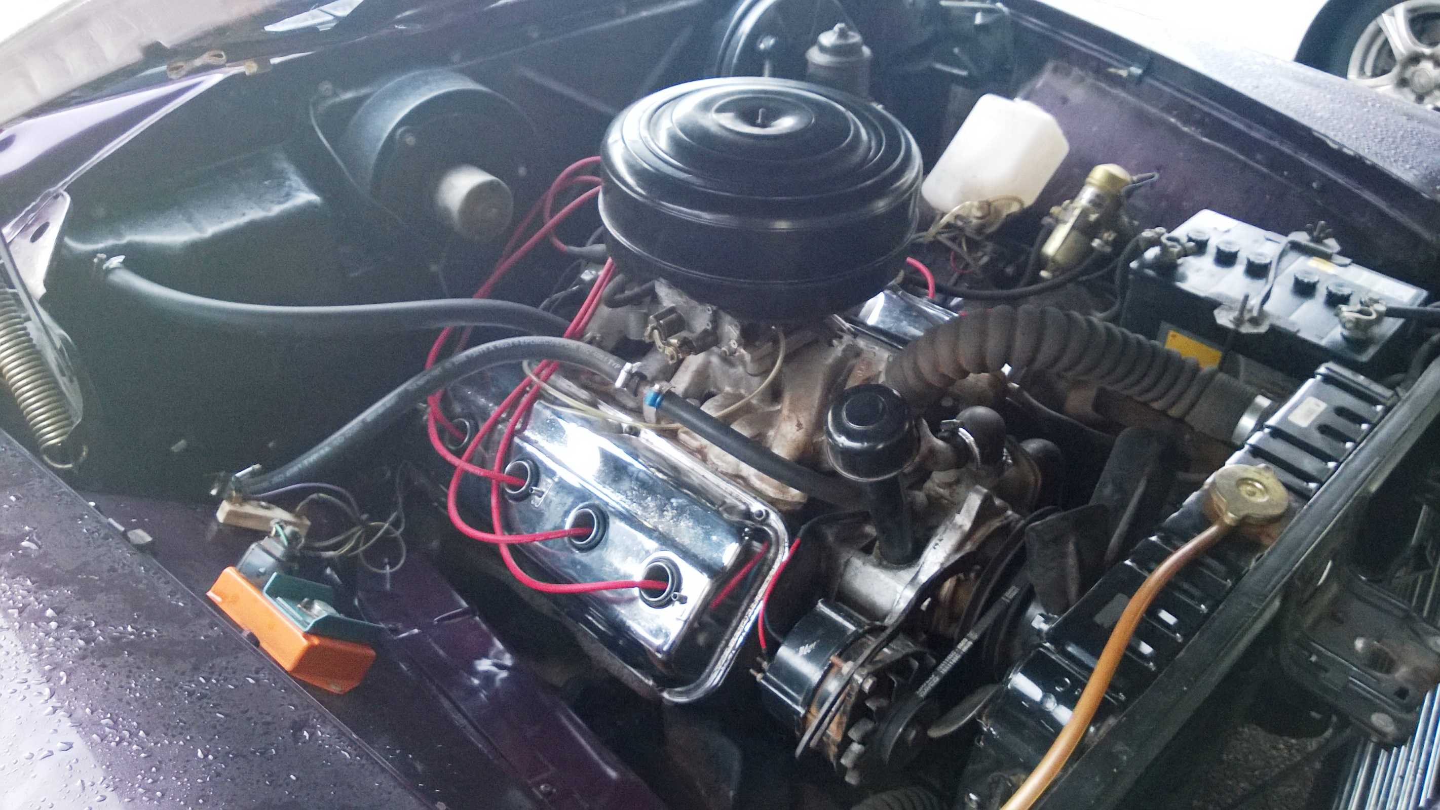

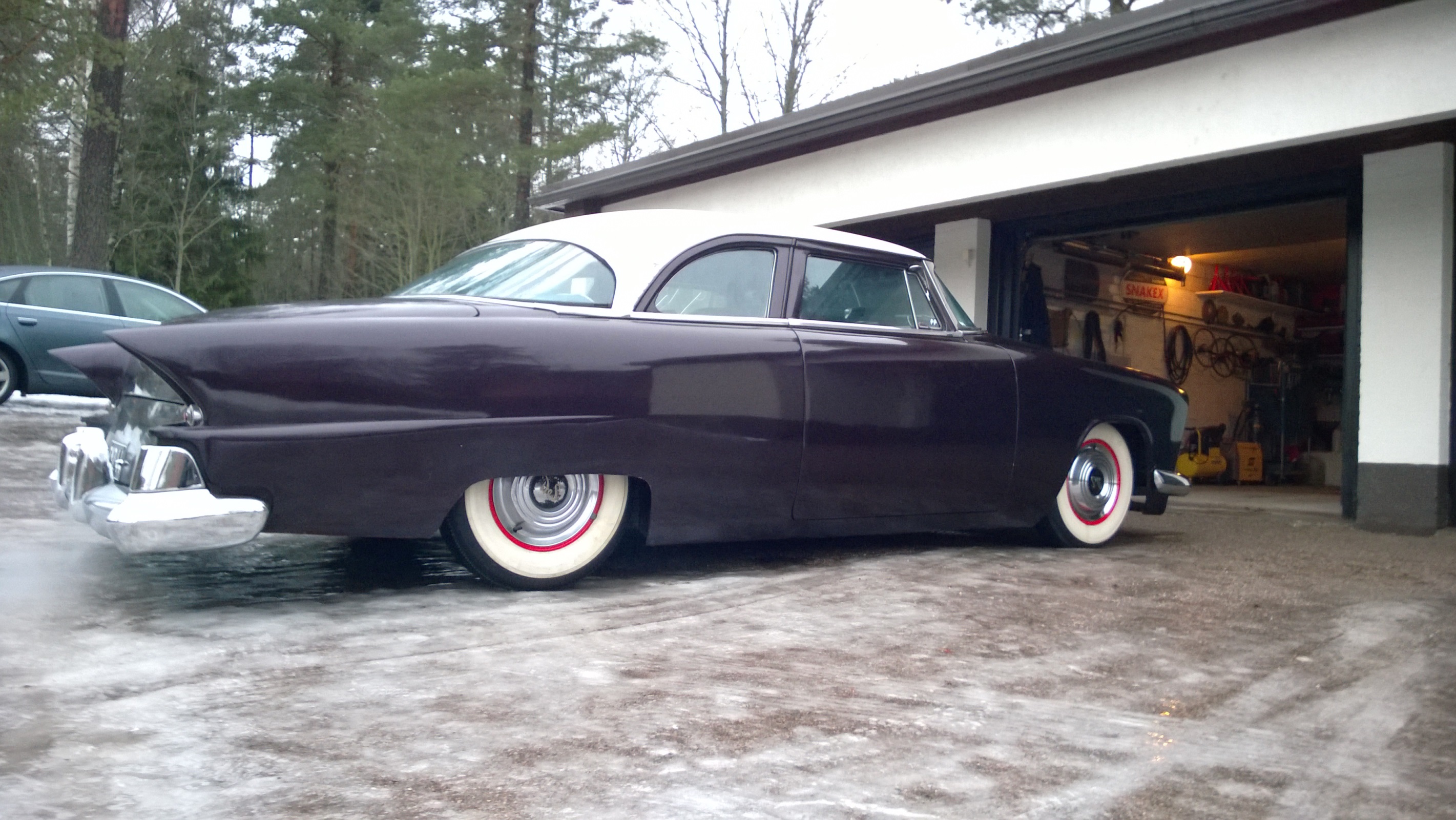

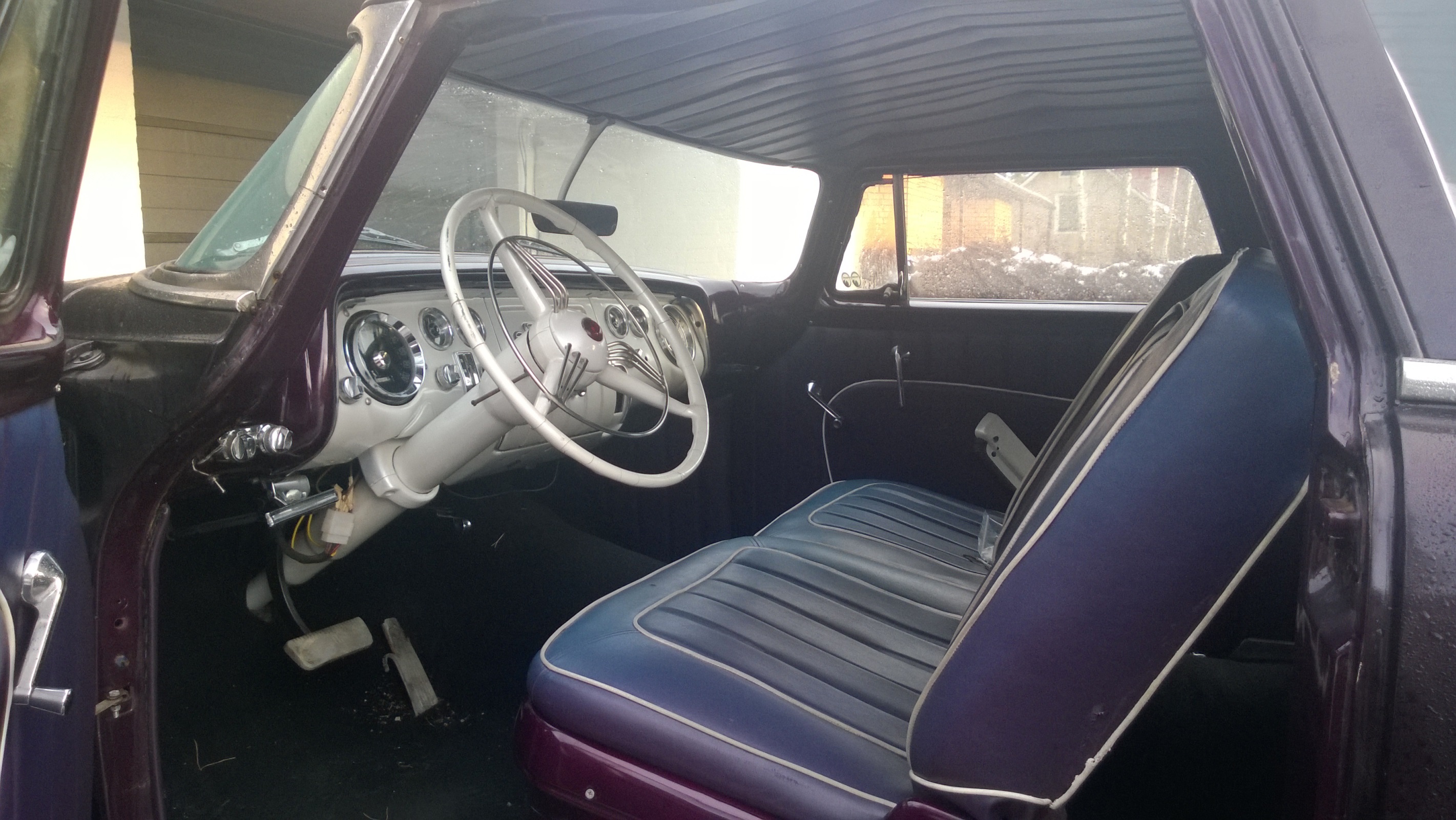

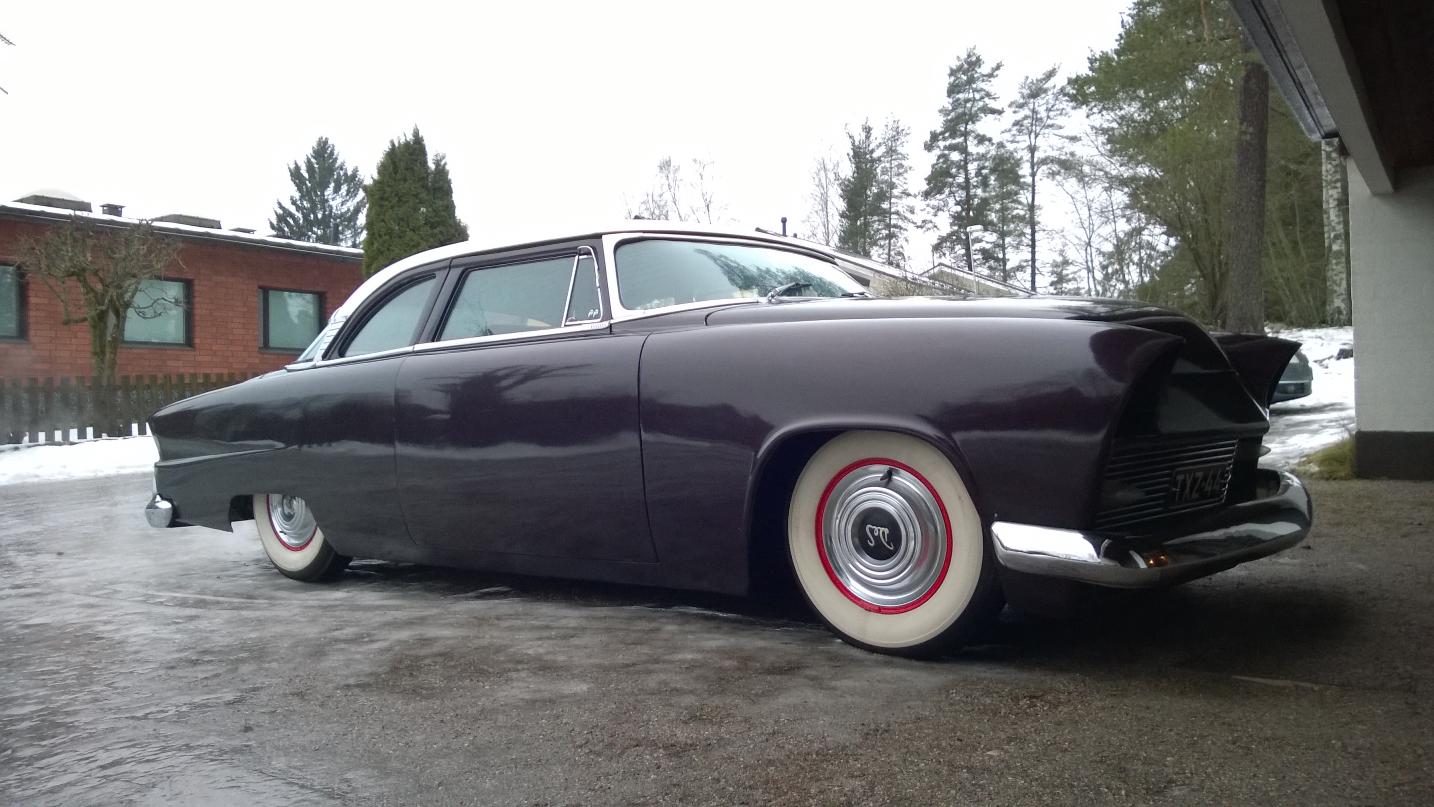

    Got my baby home and cleaned it up. Hemi runs like a dream. Can't believe this car was built 12 years ago, it's still in amazing condition! I'm happy!

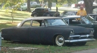

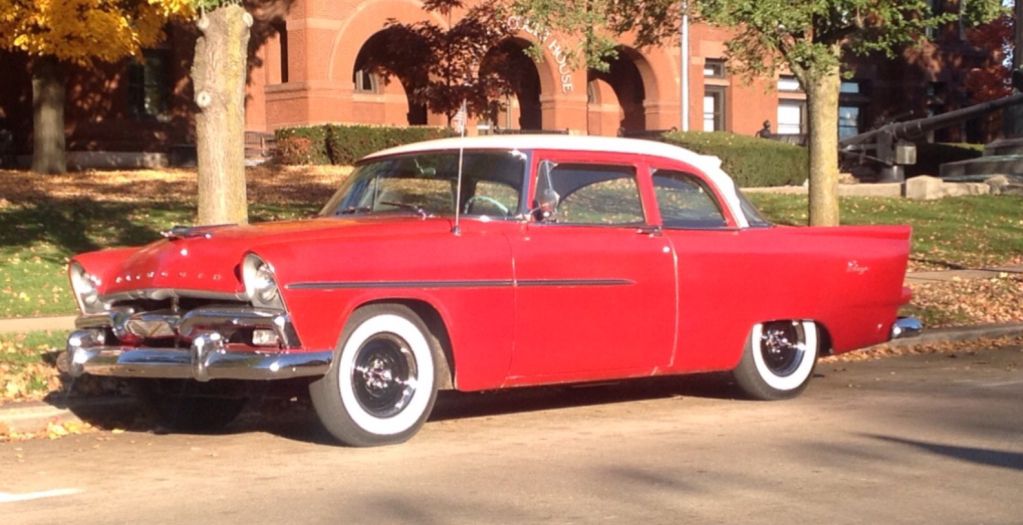

    So I posted this pic about 15 months back when I got my Plaza.
    Here is how it looks now. Wheels and tires make all the difference.

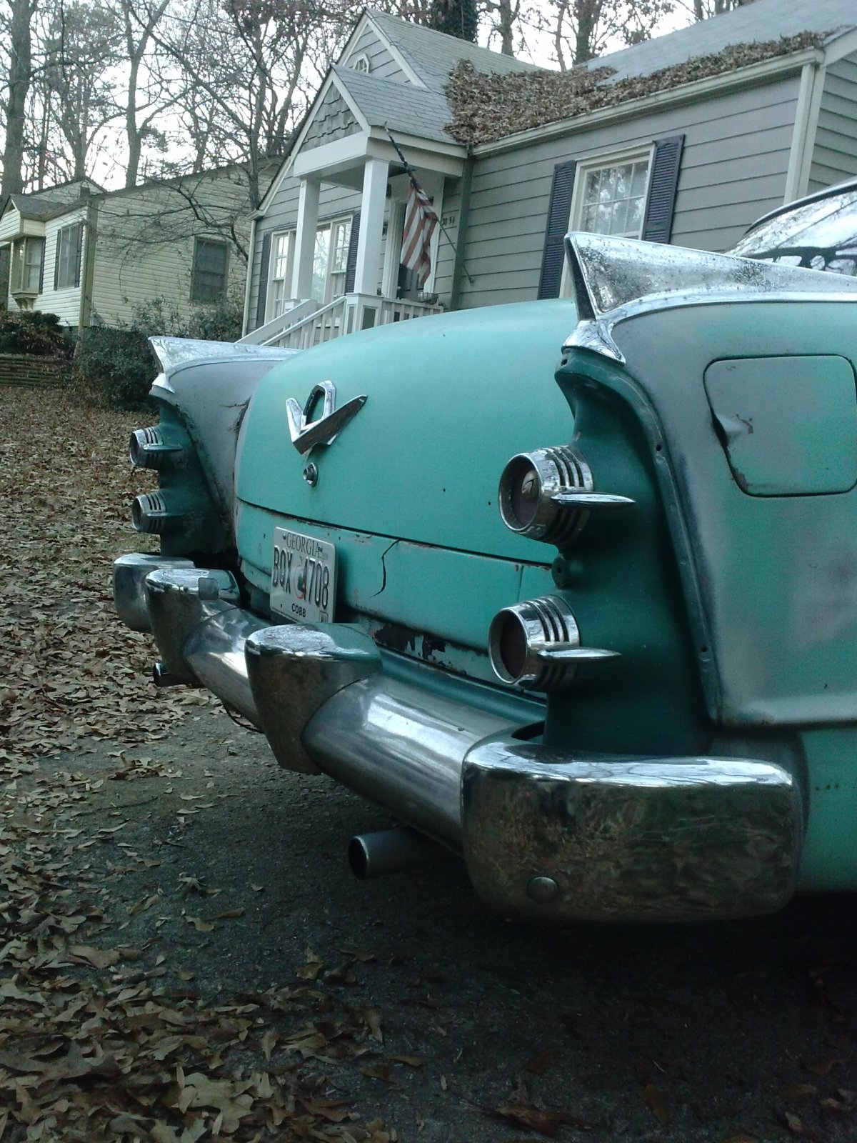

    Here's a couple of pics of my 55 custom royal 4 door sedan daily driver, this car has a 270 Hemi with a 904 torque flight and 4 wheel disc brakes, unfortunately I had a little mishap the other day, a guy pull out and stopped across my lanes of traffic waiting for the opposite side traffic to clear causing me to slam on the brakes and skid sideways across a couple of curbs, wiping out the left rocker panel and the bottom of both left doors as well as destroying both rims and bending the left axle. I had another axle and I'm fixing the other mechanical issues from the wreck and I ordered a new rocker panel. The last pic was taken after the wreck. BTW, if anybody out there has a pair of 55 dodge driver side doors somewhere in the South East let me know...

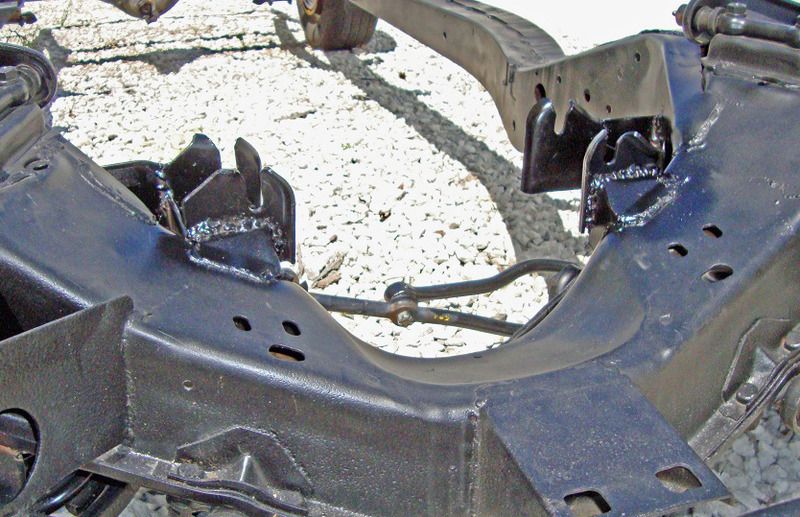

    I was going back through the old posts and the motor mount issue seems to arise periodically, so here's another way to skin a cat using later model, inexpensive Mopar spool mounts. When searching for '56 OEM parts I found nothing cheaper than $400 for a set. The common Mopar spool mounts were less than $20 a pair from Rockauto, and the brackets that were cut from a 2000-something Ram were $30 from a local yard.
