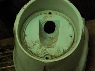

    Backup light mod for 1956 Plymouth and Plodge.
    In most cases when you get your 56 the backup light lens will be broken from the farmer helping you load your car with his fork lift tractor (whoops).
    When I started looking for new lens, the only ones available where reproduction ones at $ 40.00 each, but the listing said not for wagons, and when I asked why, the answer was less than enlightening. Plan B, I remembered from a past life that an aftermarket back up light looked very similar, so out with the measuring tools and internet catalogues.
    Turns out the Grote 62021 (Chrome-Plated Bezel) or 62011 (Gray Bezel) with the bezel removed was very close to the same OD as the 56 and that is what I used. ($ 26.00 pair)
    I see today lens from 20.00 a pair (used) to almost $ 200.00, to late, I’m done!
    My Suburban must have been the economy model; taillight lenses but no wiring or bulbs or sockets, the Grote unit comes with a base, a socket, and bulb (soon to be replaced with a LED) that with a little grinding fits right in.
    Pic 1. Broken oem lens
    Pic 2. New / old lens
    Pic 3. Old / new lens
    Pic 4. Trimming required
    Pic 5. Trimming done and new mounting holes marked
    Pic 6. Drilling mounting holes
    Pic 7. Drilling lamp plate
    Pic 8. Mounted
    Pic 9 & 10 Done.

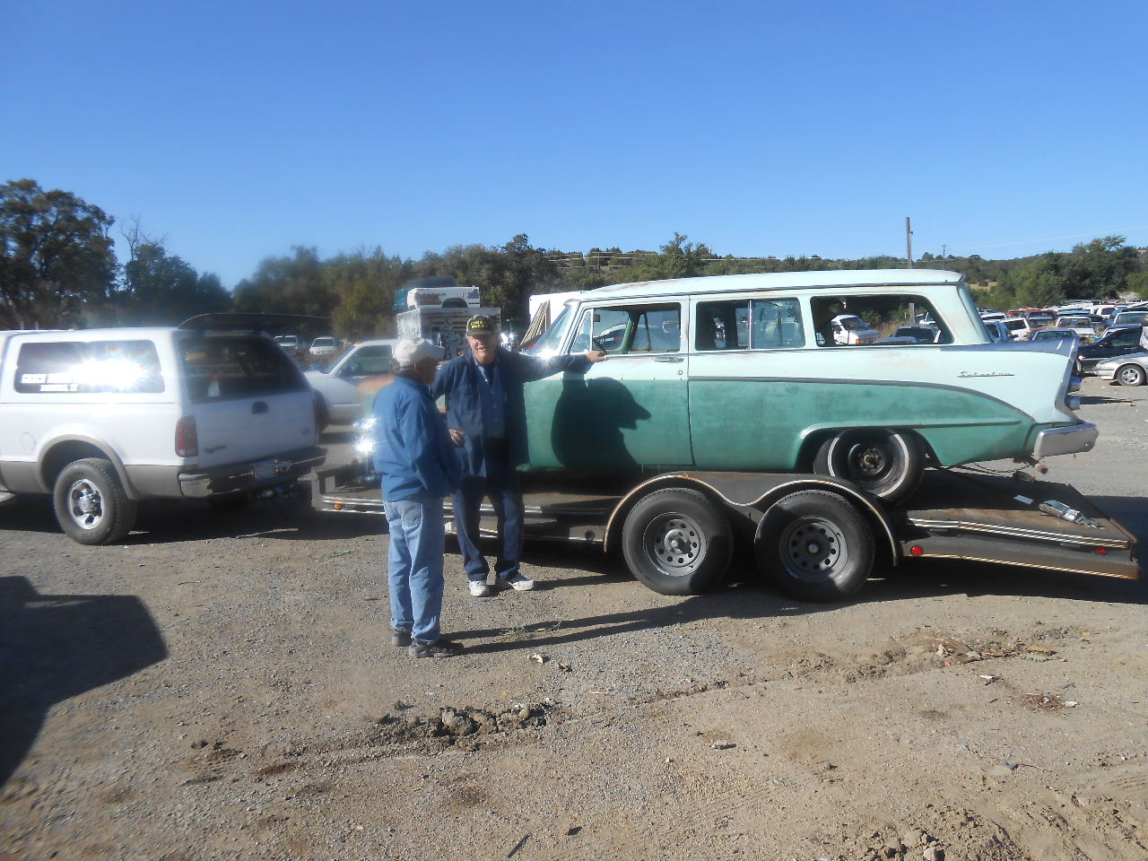

  27. Last weekend I brought home a '56 Coronet Suburban 2 dr station wagon. V8 w/ Powerflite. Salvage yard car from New Mexico. All the glass had been shot up. Much work ahead.
  28. impala4speed
    Joined: Jan 31, 2010
    Posts: 204
    impala4speed
    Never seen one of these before. That is really cool.

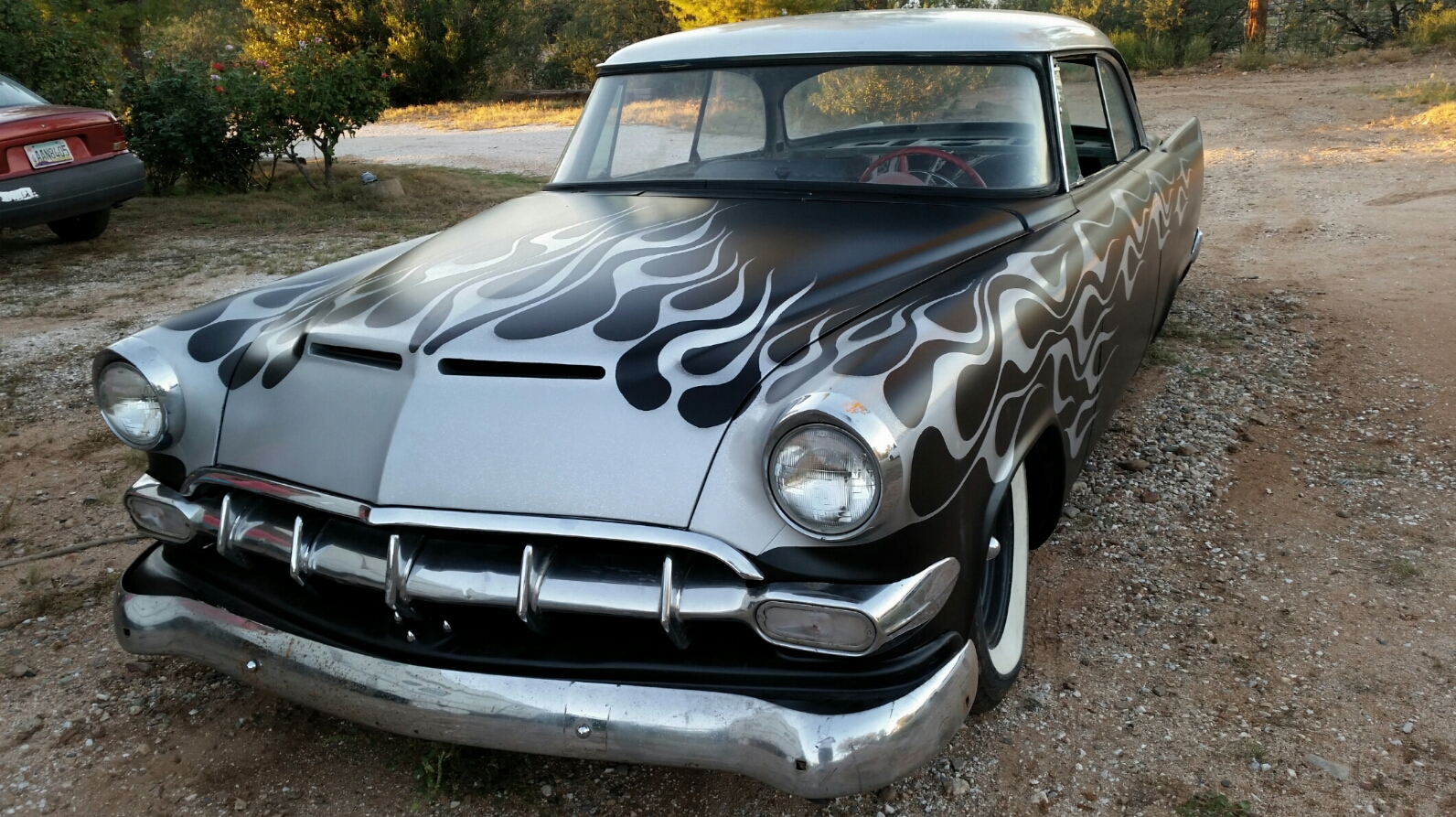

    Have been busy with paint and body the last few weeks. 2014-10-13 00.23.40.jpg
