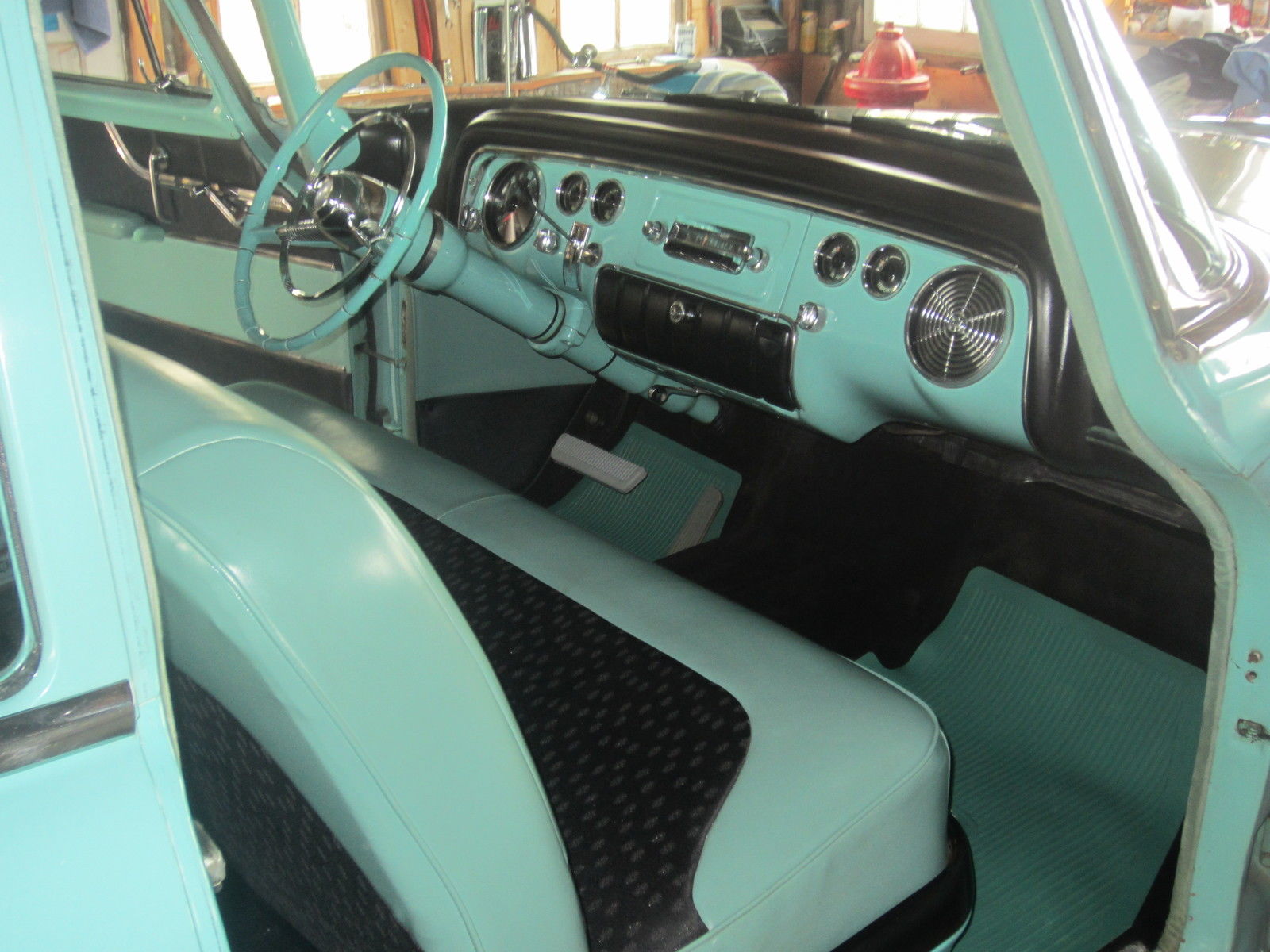

    Hi All,
    Extremely neat site. I had a V-8 Overdrive '55 Plaza Club Sedan in high school and have spent several years trying to find another one. Guess I'm trying to recapture my youth. Anyway I scored this nice little Belvedere a while back. Nice complete car, but I am searching for a donor to replace the little flathead 6 and PowerFlite tranny. I'm thinking 340 or 360. Heard too many stories about trying to shoehorn in a Big Block with running electric fans on the front of the radiator and cutting out transmission humps, and moving steering boxes. Have found a 2003 Dakota RT with a Magnum 360, heavy duty 4 speed automatic and disc brakes all around. Got a beefy posi rear end too. I might have struck gold for lots of great donor parts for the '55. I'm posting a picture from 50 years ago of me and my high school '55 and a couple of my new ride.
    Again, great site and I'll be spouting off every now and then. :)

    Montanabill---Nice score on the 55 Belvedere. Also nice ride in high school. The LA series motors are not too bad to swqap in to your 55. I am running a 340 in my 55 Belevedere Suburban with a 727 auto and 8 3/4 rear. If you decide to go that route, pm me and I will give you some more details on my swap.

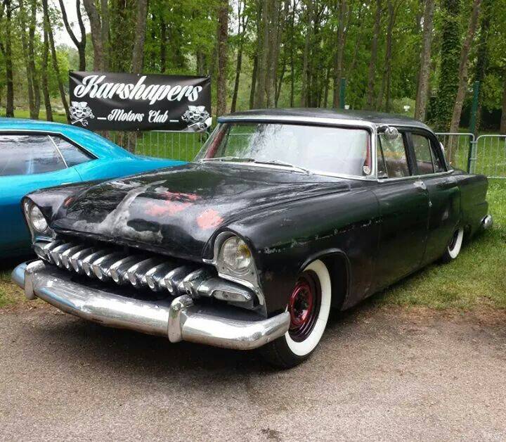

    Has anyone every seen a 55 dodge with the desoto diplomat front end? I really like how they look and most of it is standard Plymouth parts. 1403295853611.jpg

  21. yes....looking at the one above - it looks like a stock 55 Desota grille.....the second grill choice of customizmer's....think the 1954 Desota grille is # 1 choice.....correct me guys if I'm wrong on the year's....

    Yeah it looks like a 55 desoto grill. I know guys like the 52 a lot for customs as well. I would like to see if that front end has made it onto a dodge but I can't find anything.

    That looks like an export model 55 Desoto which was based on a 55 Plymouth frame and body with a unique Desoto front and Desoto badging. The grilles are not the same as a US domestic Desoto -note the grille has 11 teeth where the US one will have either 7 or 9 teeth. If the back has 55 Plymouth taillights and the dash is Plymouth its definitely an export model called a Diplomat - For a Mopar they were sort of common down here in New Zealand and Australia. They all had a firewall badge saying they were export models from Detroit.

    Hey 35desoto, thanks. Yeah its a Plymouth with a different grill. I would try to find a diplomat grill but if a regular desoto grill fits I might do that. They would be easier to find.

    SOME of the parts off a American Desoto will fit and some are unique to the Plymouth based export model. The bezel around the headlight is Plymouth, the parking light is Desoto and the stainless frame the teeth sit on and the teeth are unique I think yet your Teeth seem to have a dimple in the leading edge which our ones did not have. Yours looks to be complete so why change? The only pieces I can see missing are the chrome ones that go along the leading edge of the bonnet and they are Plymouth. Good cars in their day and fine cruisers now
