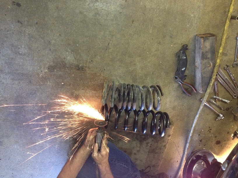

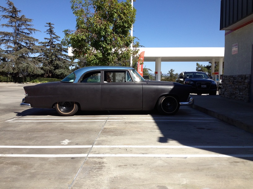

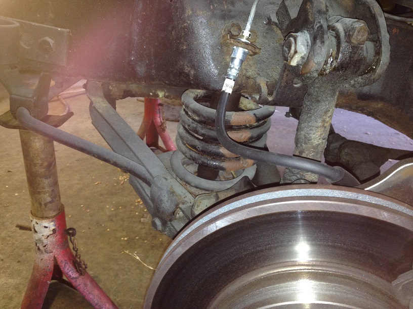

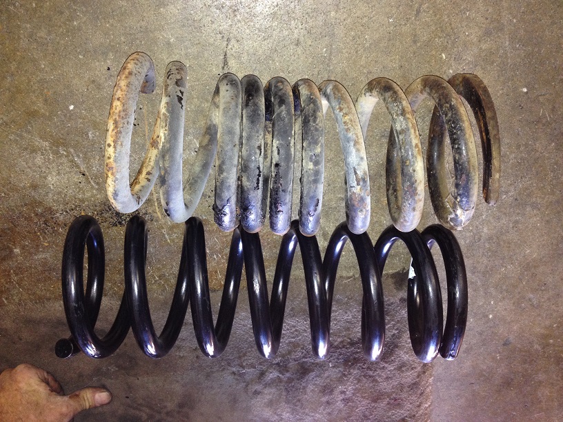

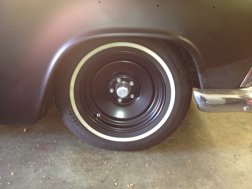

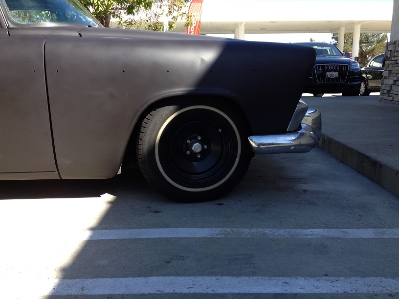

    Change out my front springs recently. I ordered them from Andy Bernbaum auto parts www.oldmoparts.com. I tried Eaton but they have nothing or specs to make replacements. Previous owner had heated the coils to lower it. The car road horrible might as well had no springs. we cut a full coil and check the height with wheels / tires back on. It sat a little high and we took our measurements. Drivers side was higher so we cut off a little more to get it leveled out. Afterwards I went for a cruise and im happy.
    1st. picture shows how she sat before and last picture shows with new springs.
