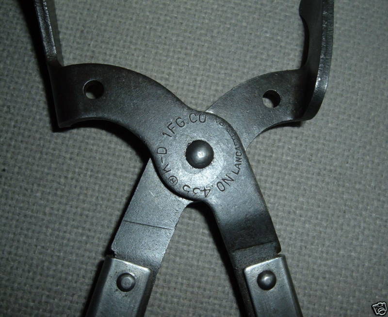

    Hi All, i am trying to strip my 1955 Dodge kingsway 4dr sedan, i am struggling to find out how to take the door cards off. i cant seem to find out how to take the window winders and door opener off, can anyone help please?
    Thanks

    I have a Chrysler and a DeSoto. 55 & 56. They have a weird spring type clip that holds the handles on. Chrysler had a special unobtanium tool for removing them which I don't have. I did manage to get mine off eventually. I'm trying to remember how I did it. I have a Chrysler shop manual that shows it. I will try to look it up for you later today and hopefull scan it and post it. My scanner has been acting up so I'm not sure I can. May have to take a picture of it. Whatever, I'll try to post it as soon as I can.

    Someone still carries the tool, but I forget where I recently saw it. I've always removed them with a flat screwdriver.

    Yeah, I think I got mine off with a scredriver also. The trick is to figure out which side to push against to relieve the tension of the spring clip.
    I can't find my shop manual right now, so I can't post a pic. Maybe someone else on here has one.
    OK, I found a pic of the old KD tool for this job. I hope it loads.
