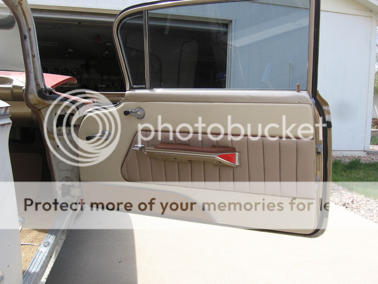

    At the last weekend end of April, just before we were to leave for the SK500, we took the car to our upholsterer for him to sew up our door panels and install the windlacing and headliner…and, as it is, we didn'’t get to go to the SK500 (for the second year in a row) due to a family emergency and the weather around here (and no, we didn'’t plan on driving the wagon to Dewey), we would have driven our Cadillacs - we don’t quite know that much about the wagon …yet… to take it on a 13 hour one way trip.
    Anyway, here’s a quik tutorial on how our upholsterer does door panels:
    Glues Landau foam down on the plastic panel board I made and trims it out for the fabric section and the carpet striker.
    Then trims out the fabric after laying out the pleats with chalk. Once trimmed out he sews the pleats.
    Then glues the pleated fabric to foam, in this case he doubled the thickness of the foam so it would match the depth of the Landau foam already on the panel. Then he glues that to a backer board. While that’'s drying, he sews up the brown welting that will trim the area.
    After the glue dries, he'’ll take the welting and staple it to the fabric covered backer board. Once that’'s done, he positions the pleated fabric piece to the panel and glues the hell out of the backside of it…and then he’ll staple the back side so it doesn'’t come loose. In this shot you can see the carpet striker already in place with a small piece of chrome dividing it…we did this simply because the vinyl is so light that when you exit the car, most times your foot will hit the vinyl at that exact spot as you swing your leg out and leave a scuffmark on the vinyl…the carpet striker prevents that.
    Once everything is in place, we’'ll snap the door panel in place, adjust it a bit via the hidden clips, the door molding trim, the handles and armrest and viola, the door panels are done…. FWIW, it took five hours to do the driver’s side door panel (the first one we did) …basically we had to figure out HOW to do the panel (that I could see in my head…!!!) The other three door panels were put together in under two hours each. It’s no wonder ‘upholstery’ is not cheap…,it'’s all in the prep…!!!

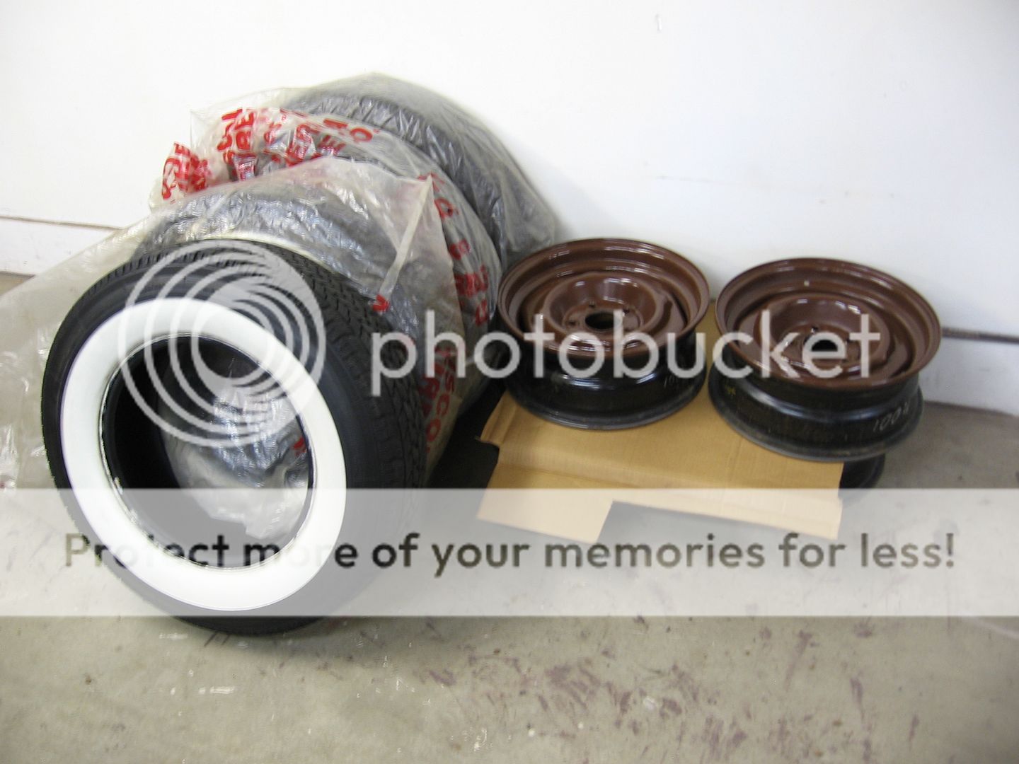

    Now I have a dilemma, …I picked up a set of near-new wide whitewalls from a friend, picked up a set of 15” steel wheels and painted them brown (to match the brown welting in the seats -that's why...!!!) …so the question is which would you run: the wide whites/hubcaps or the 5-spokes…??? Guess I can always put the car up for sale with the buyer’'s choice of wheels/tires.
    Out on the highway, we determined the rear-end is a 3:70, …a bit much on the highway but I have a 3:55 laying in my shed that I think I'’ll put in….I had a 3:08 3rd member but ended up selling it about six-eight months ago, …should have kept it but I think ideally a 3:36 would be the best. Guess I’ll have to go to my favorite junk yard and pick one up.
