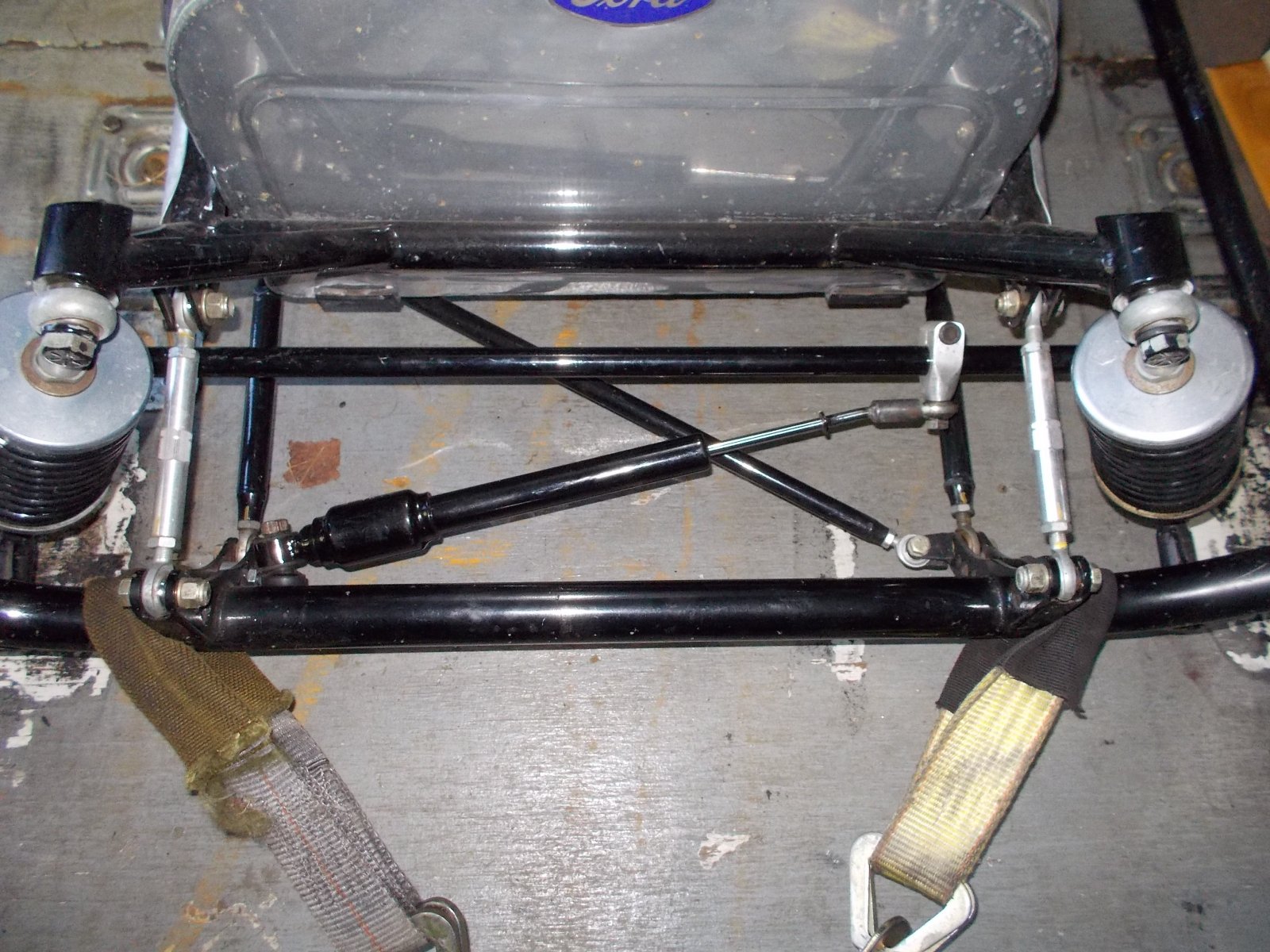

    Second, install a steering damper. I use a Fiero damper on a '33 Willys with seven degrees of caster and have no issues.
    I recently installed a VW damper in a '23 T altered roadster and it cured the death wobble there too.

    Got one on tierod bar. I'll shoot for 7 deg caster, sitting at about 2deg with shorter front tires. I also need to limit front axle drop with new shocks. I believe that this could be another factor.

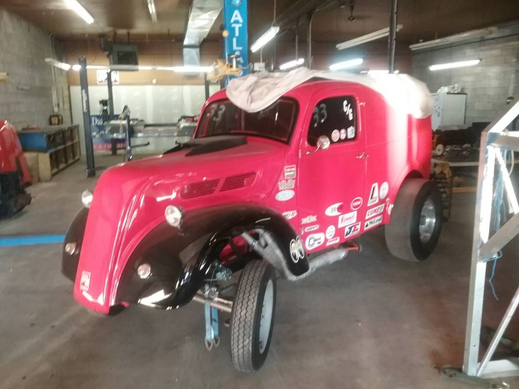

    Finally, getting over flu... Put car on jack stands, only 35deg F.
    Removed friction shocks, going back to std hyd shocks on front axle.
    After looking at front axle, going to try to crank some caster out of hair pin adjusters.
    The X Spring pivots on bat wings, so my concern of binding cross spring is nill.

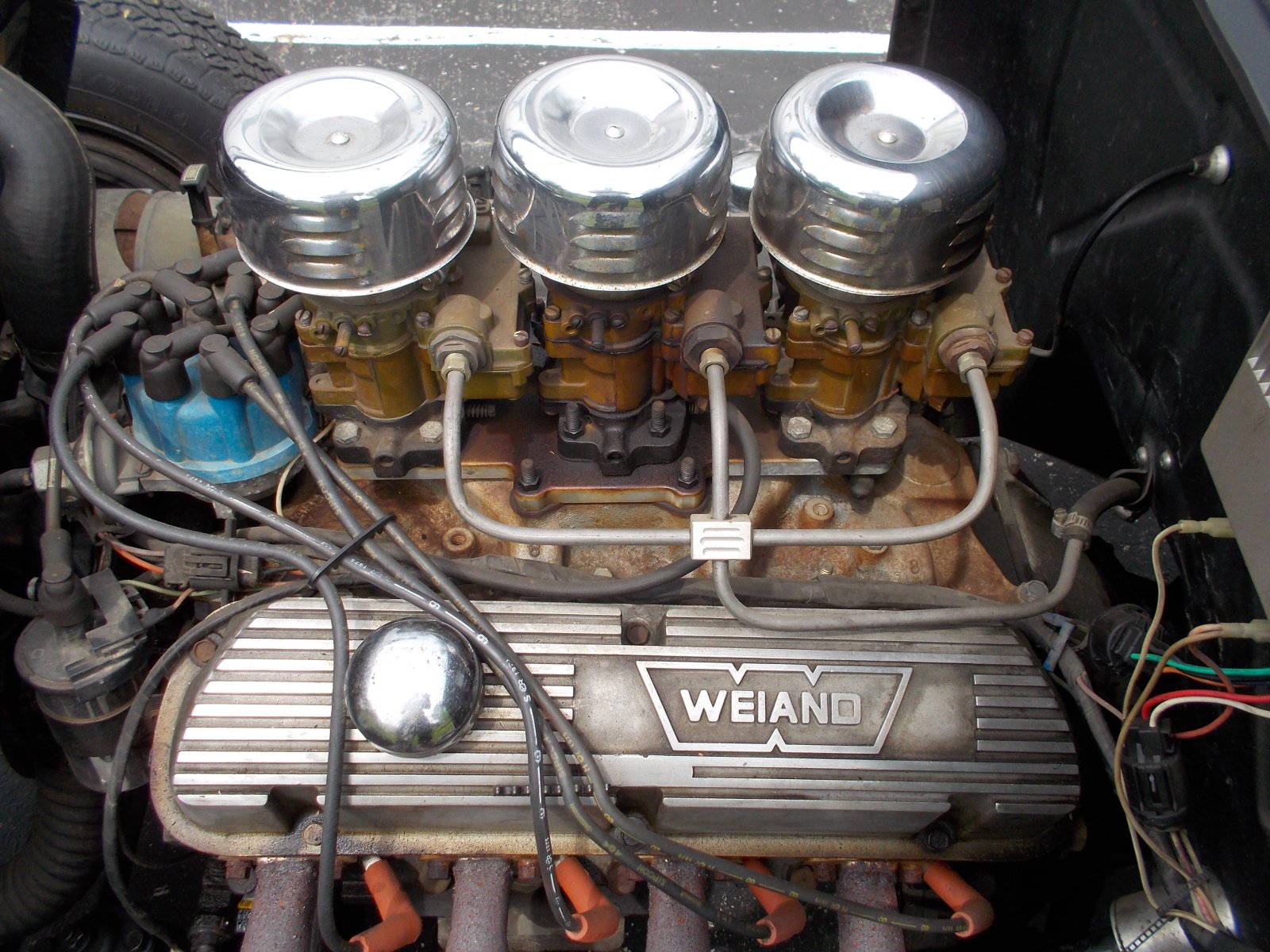

    A single plane 2V intake is kinda a rarity. Is that a manifold for some type of limited circle track racing?
    My Hot Tub has a 2V intake (disguised as a tri-power) and it runs great.
