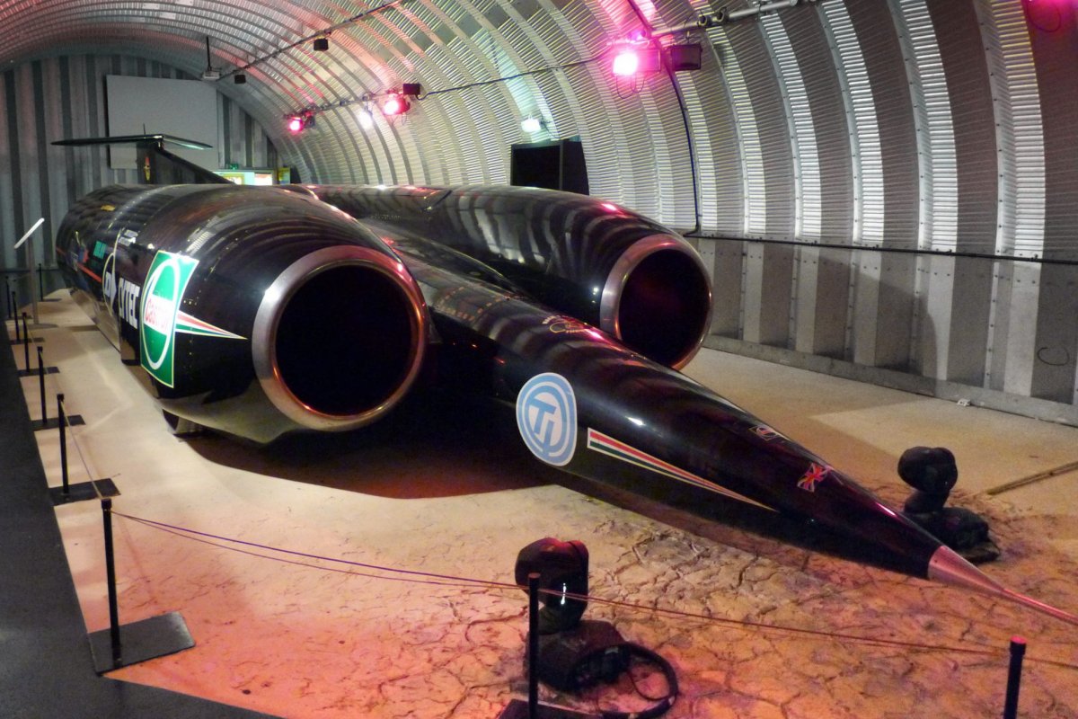

    Hey on another note I thought I would share this from Hemming Online! More than 20 years after it became the first car to set the world land-speed record in excess of the speed of sound, ThrustSSC not only still holds the record, it’s also still racking up accolades after the Institution of Mechanical Engineers presented the jet car with its Engineering Heritage Award.

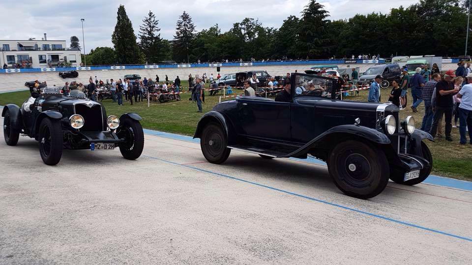

    Here's some shots that were just shared with me of a friend , Steffen from Germany, having some fun with his 1929 Chevrolet.... 40758231_10217255641173622_7494293756254879744_o.jpeg 41413756_10156543130748771_462555999115411456_o.jpeg 40632803_10217255645653734_8342115580316221440_o.jpeg 36028634_10216684778262406_3034558204676669440_n.jpeg 36569253_10216751944381517_3761696442767376384_o.jpeg 40570631_10217231525410743_25457104387047424_n.jpeg 42085868_10217389236673426_7563023115710627840_n.jpeg

    Enjoyed seeing these photos of vintage Chevrolets!!

    Rudestude, Thanks for posting those here. They belong here I wish Steffen could tell us about them.

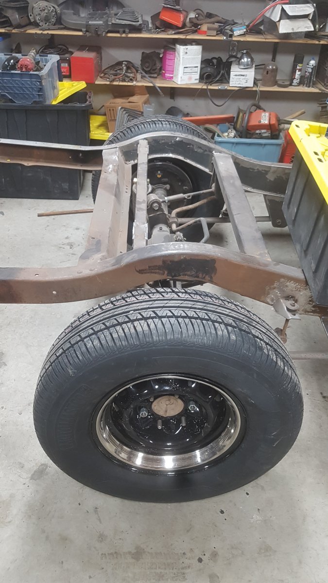

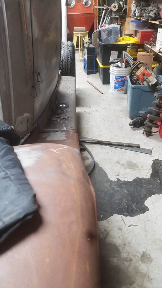

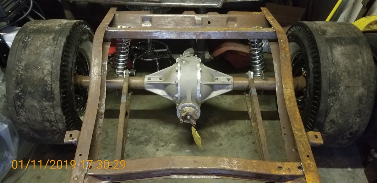

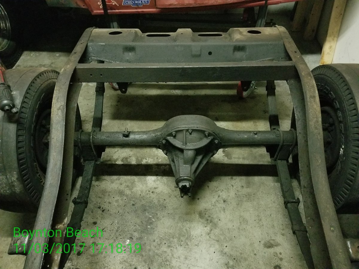

    C'mon Paul... Your ''55 - '64 Chevy rear is 60", the most popular rear to drop in an early hot rod. Look at my photos of the two rears in my chassis. Figure there's a few inches of the body just wider than the frame as well. My inside backing plate to backing plate on the QCR is 52/53" to check and see if the body would rub on the tires. I'll know if this will be an issue once the body goes back on to check if my QCR needs to be repositioned so the tire is perfectly centered in the wheel well.

    I said 61" is too wide. 55-64 works okay with the right wheel, and the narrowest I've run in a 31-32 was 55.5" and with a 8" reversed rim and it looked great. My current project will be 53.5" with an eight inch halibrand style known as a trick 8", with 2.25 bs. I think the 56.5-58 inch would be best for a std. offset rim.

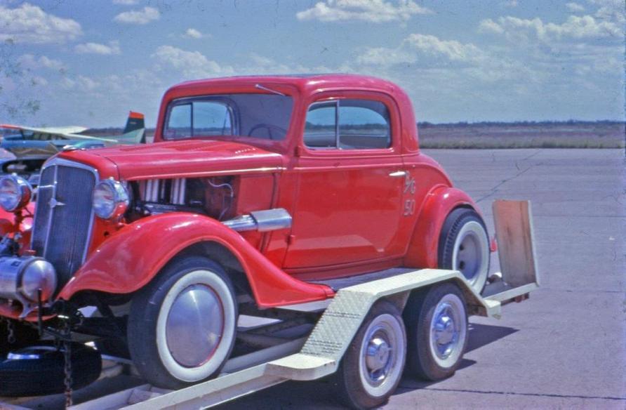

    Looks like this thread needs a bump, so......Is this car Cool, or what!!! Not sure if it's a 34 Master, or a 34 - 35 Standard, though.

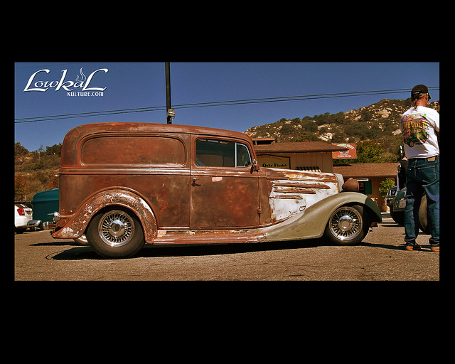

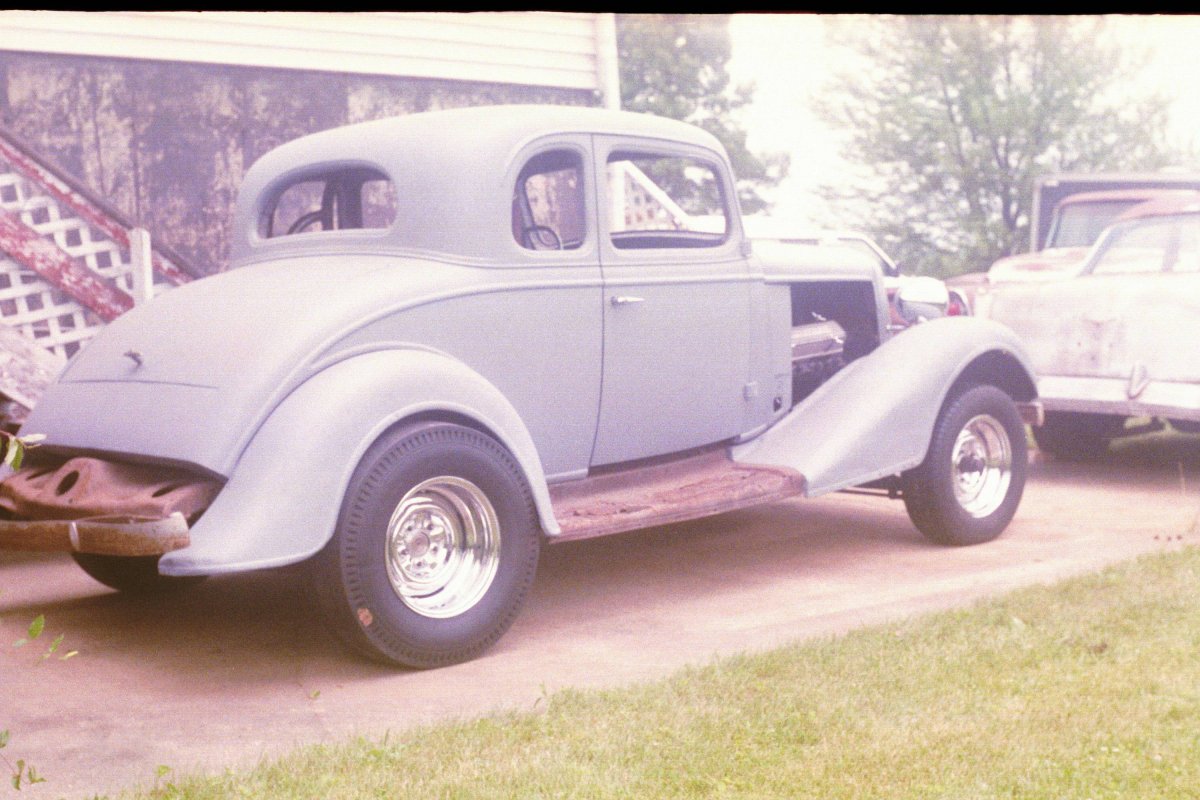

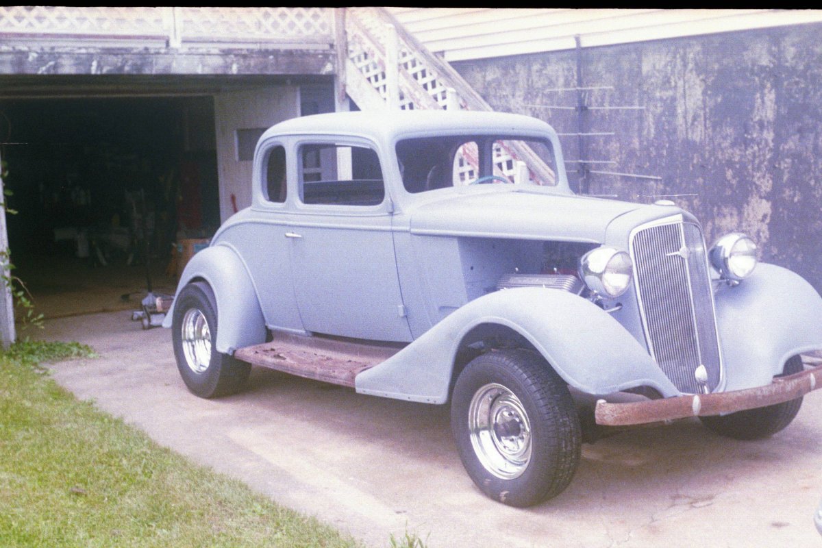

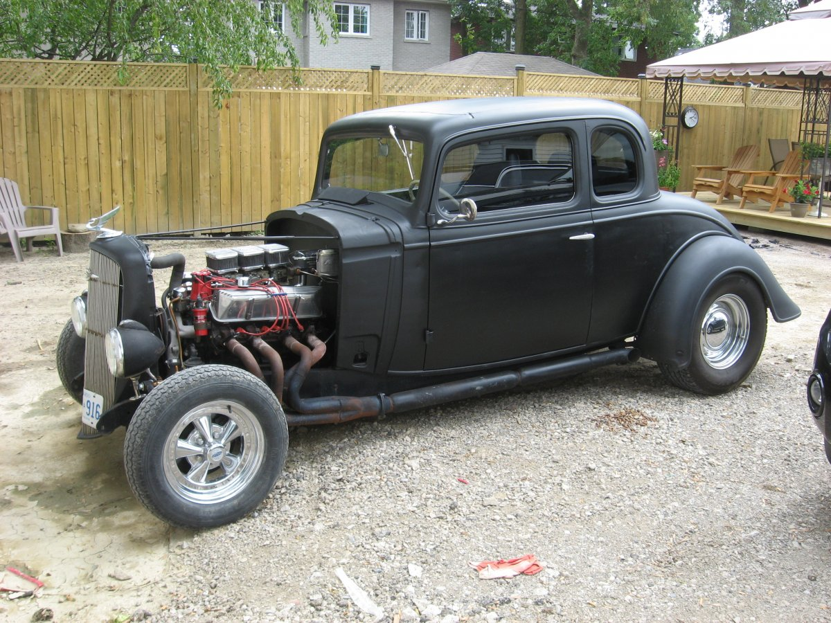

    34 master note rear fender.jpg chevrolet-delivery-1934-9.jpg joes 34 master.png its a 1934-1935 Chevrolet STANDARD series, using the rear fender as a visible guide.
    The rollover on the side is a lot more on a master. As shown by these 3 picture examples.
    Hope this red car made it back to the street
    mike lynch

    Much needed bump, thank you Torkwrench. The body is so stock, just modifying the frame to accommodate the horsepower coming from an injected small block Chevy? Smokin' SWEET!!!!

    Yes, the red coupe looks like it was a well built, high quality car for the time. Looks like the window garnish moldings were even chrome plated. From the reflection, in the doors, it appears to be a very straight car.
    This is partly why I wasn't sure if it was a 34 Master, or a 34 - 35 Standard. Thought that perhaps the rear fenders had been nicely radiused.
    The rear fenders on my 34 Master will have to be radiused, to run the cheater slicks. The plan is to trim off the fender reveal, and move it up for more tire clearance. This would result in a similar look, to the rear fenders on the red coupe.

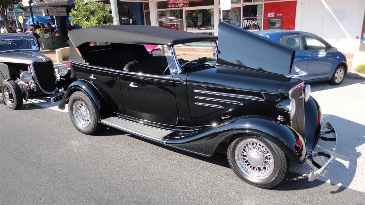

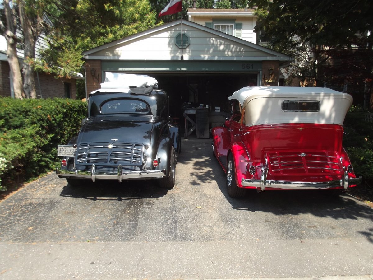

    Don't think I posted these before, this a local GMH (Holden) Chevy coupe. Bolt on sheet metal (Hoods, fenders will swap over) however body shells and doors are totally different to Fishers and won't interchange.

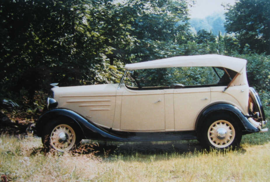

    Also, here's another local GMH '35 phaeton. Ozzie cars don't have that pressing above the fender in the 1/4's and feature a spear on cowl rather than a single line pressing. Also Ozzie phaetons didn't have that side pressing in rear 1/4's that extended down from top of door to tailpan area. Also note that the top irons pivot in from different locations on the rear 1/4's

    tan coloured car is a 35 touring usa built and the red one is mine also usa built. I like the way the Holden top irons sit even with body as opposed to USA built where top irons mount and fold over the outside of the quarter.
    Droopy door handles will get fixed this spring with new ones from a 1930 ford 2 door touring, interesting they ( Chevrolet open cars ) have ford parts. I already have them so when I install the new ones will take apart the original and see what color the spring is inside and see if I can find them as spares.
    I solved the droopy & dumb looking low door handle issue on my roadster build by welding up the hole.

  28. Thanks, Torkwrench, for that bump. That red coop is definitely kool!! My first thot seeing the fully chrome headlites was that it was a 3W Master, but I agree seeing the rear fender from that angle that it appears to be a Standard. A look from the rear wud likely provide a more definite clue, yet that's not always possible. Going on what we can see and the fact that a 3W Master coopay was a fairly rare car with only about 18k made, I'd have to say it's a '34/'35 Standard.

    in that 34 master picture with the slicks on it, does not need the rear fenders radius'd needs a rear wheel without the large positive offset and in they come, inside the fender.
