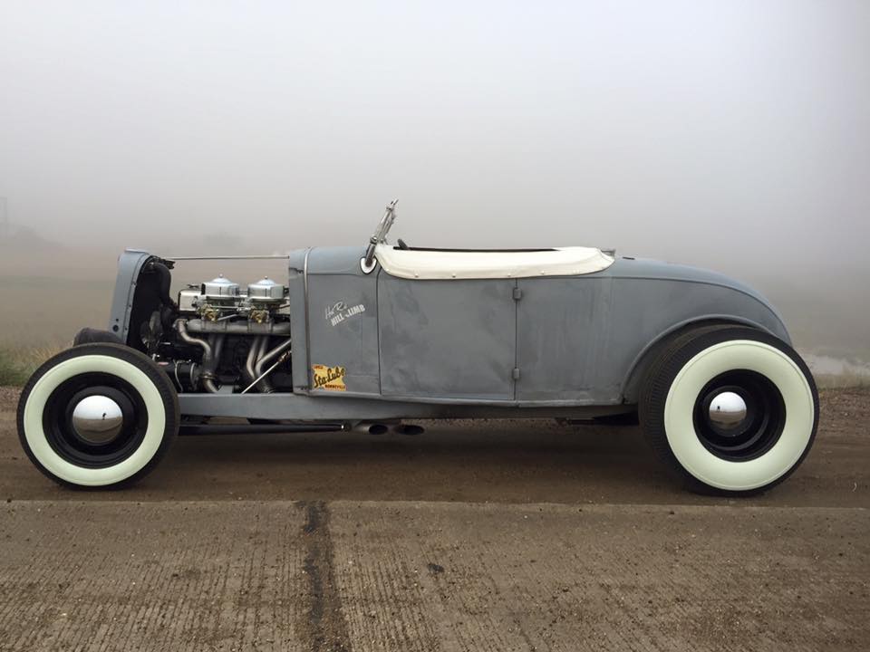

    image.jpg Great conversation guys. I too went with a Ford front end setup up on my Chevy roadster for a variety of reasons and grafted on a set of Model A frame horns up front.
    Also, for boxing...I boxed my frame ('30/'31) the entire way with 3/16" which I'm glad I did.

    Joined: Aug 14, 2009

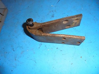

    35 tub A.jpg 1929---1935 Chevrolet roadster, phaeton , roadster pickup 29-32 all used a hidden hinge system. You could move a metal tab and lift the door off the hinge pins, an interesting design to give you a jeep like look.
    The hinges your showing in the picture , are like a ford or a fisher bodied Chevrolet , where the hinges are exposed on the outside. Notice the touring has no visable stock hinge system as does a roadster. Notice on tub how low on door stock door handle is, UUUUUUUUUUGGGGGH !!!

    yup those are GM fisher body closed car hinges. Do the job for turning into suicide doors. No wonder they sell well on ebay when they appear.
    here is a picture of 1929---1935 Chevrolet OPEN CAR door strikers locks and door hinges. Interesting that the door strikers are actually 1929 or 30 ford **2 door touring** a one year only ford design that Chevrolet used or ford copied just for the one year ????? I got them from a 2 man shop in new England that does ford open car repo parts .

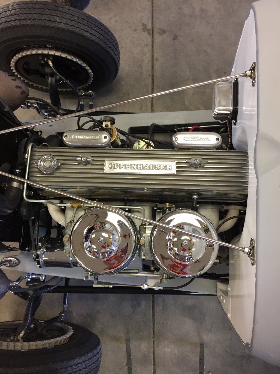

    Was just studying the side shot picture of your car and focusing in on the DUAL TRI-Y HEADERS, that is very trick, twin carbs on tricky looking intake and other stuff. Front axle and spring ??? Steering type. ?? Dash and gauges ?? Steering wheel. Seating and looks like a 34-35 chev standard series radshell and grill. Headlights are the gotta have them guide sealed beams.
    How about MORE pictures of your lakes style roadster. That way we will not get anybody moaning about not enough period correct stuff.

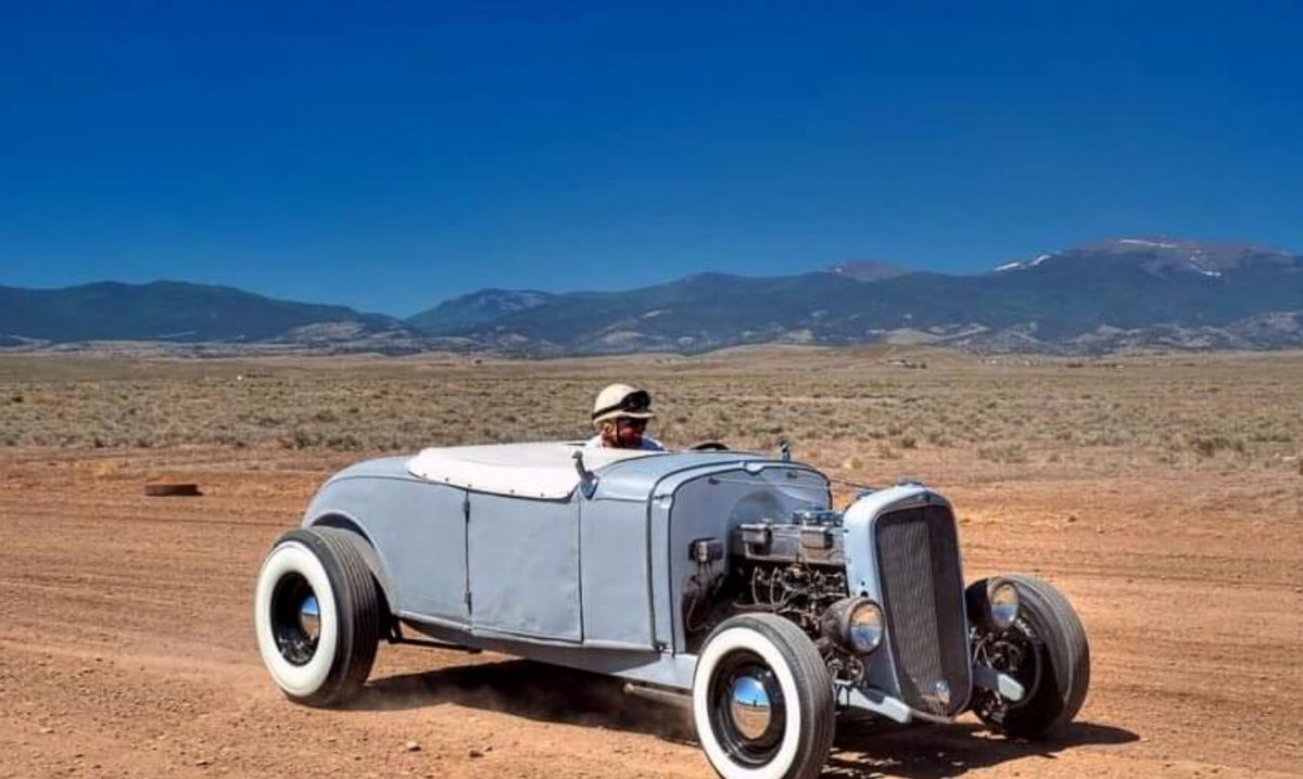

    @madmike3434 I ended up using a Model A cross member, monoleaf spring with a 4" dropped axle. I bought this car body and frame from a restorer who had it since the 80's and decided the body was too far down the hot rod path to restore so it was perfect for what I wanted to do with it.
    It's 292 Chevy 6 with an adapter to run an early style valve cover. Those are early Clifford headers along with the intake both of which they don't make anymore. It's vega cross-steered with a Bell 3 spoke wheel. Dash is pretty simple with some gennie winged SW gauges and not much else. No radio, heater, wipers, turn signals, etc...just a bare bones hot rod.
    Standard grill shell like you mentioned - I mocked it up with a '31 Chevy grill shell but it didn't fit the look I was after.
    Here's a few more pictures.

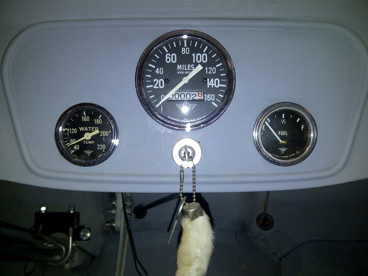

    IMG-20130422-00638.jpg wb5.jpg 19 Point Inspection.jpg new engine 1.jpg New Engine 2.jpg HRHC 2018.jpg DSC_0171.jpg
    It's a fun little car and I plan to finish it someday but right now I'm having a blast enjoying it as it is.

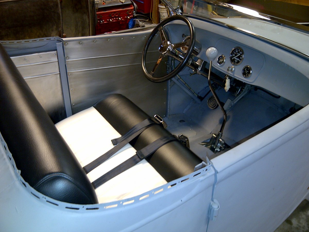

    great pictures........lots to look at and admire. Gas line shows skill to get it right, buick aluminum finned drums are a high light. 2 holley 2 barrels wasn't expecting that. A 292 gmc, blow a 239 ford v8 into the weeds .
    The 34-35 standard rad shell suits the car much more than stock 30-31. But it maybe a 33 rad shell if the chrome trim ring is part of the rad shell stamping ???
    You could make a pattern out of flat plywood to produce a wooden seat surround from top of the inside aluminum wrapping around. I made mine out of 7/8" thick northern ash in one piece using wallpaper steamers. Better to make out of 1/4" strips and laminated them together in a jig. Gives a bit more finish look to the car and stiffens up the body.
    The rumble seat lid on the car is ROADSTER ONLY . The panel above it is not welded shut on either side , nor is the panel below the trunk lid. They are nailed to the substructure wood.
