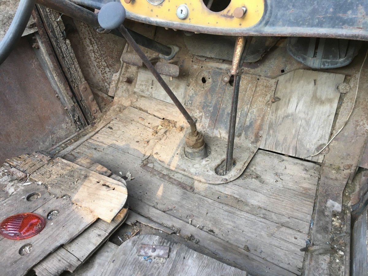

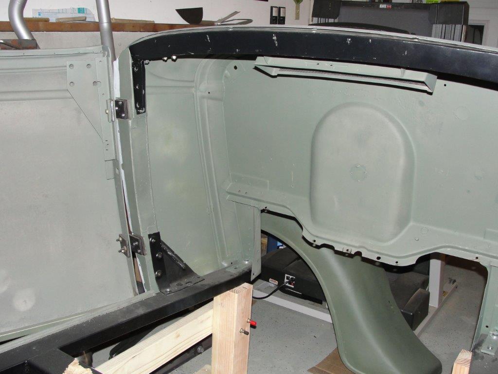

  18. madmike3434
    Joined: Aug 14, 2009
    Posts: 691
    madmike3434
    here is a well done 33 I believe cabriolet fisher body firewall, should show you all the detail on firewall panel you need to see.. The square holes near the bottom lip are gm CAGED NUTS 1/4 or 5/16.
    mgtstumpy, Fern 54, nunattax and 4 others like this.

    from georgia
    Thanks I see where they butchered mine

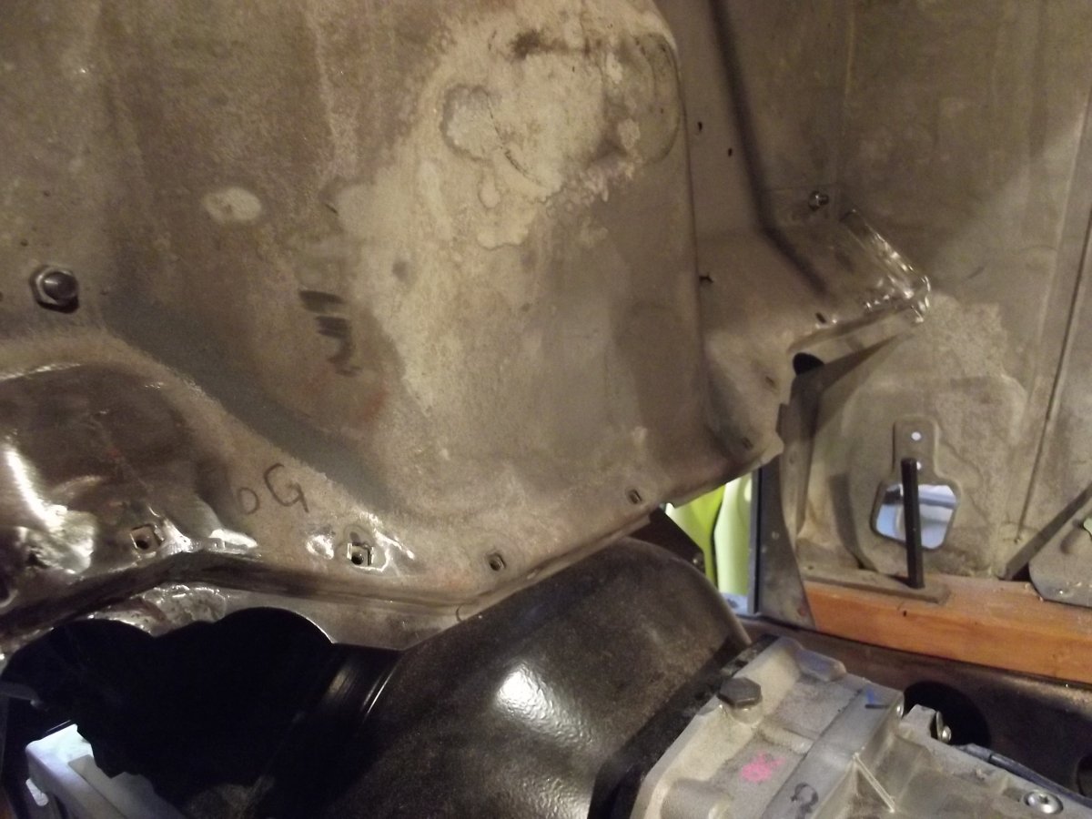

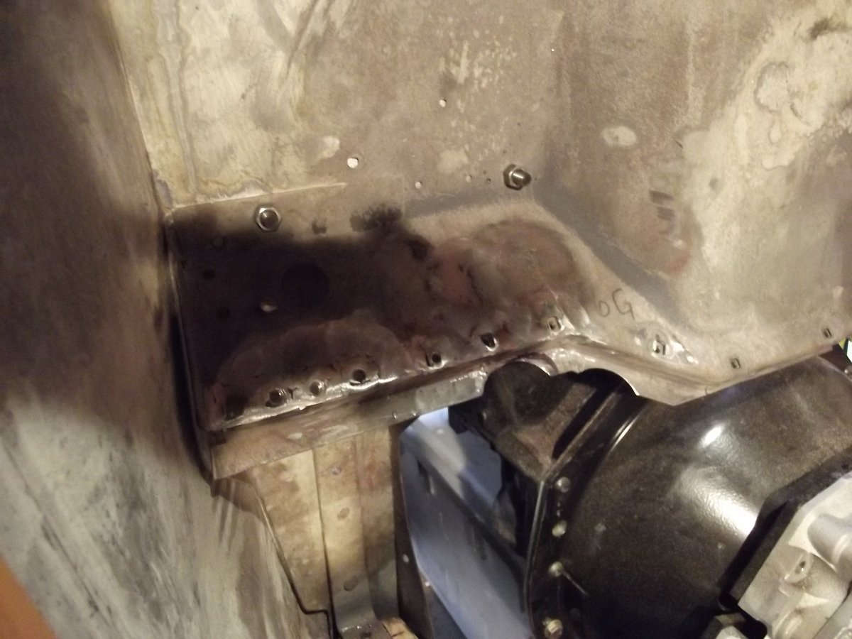

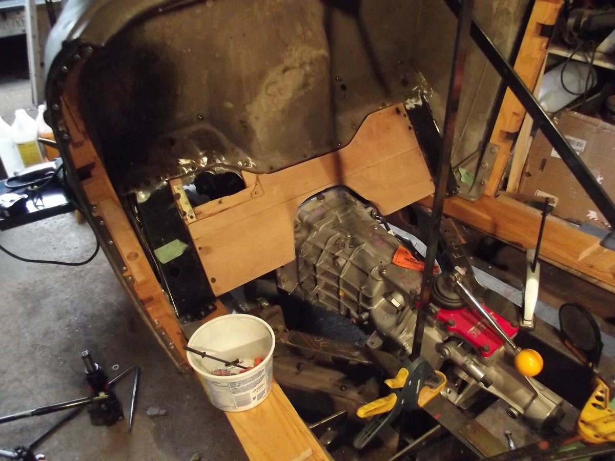

  23. flatmotor40
    Joined: Apr 14, 2010
    Posts: 556
    flatmotor40
    from georgia

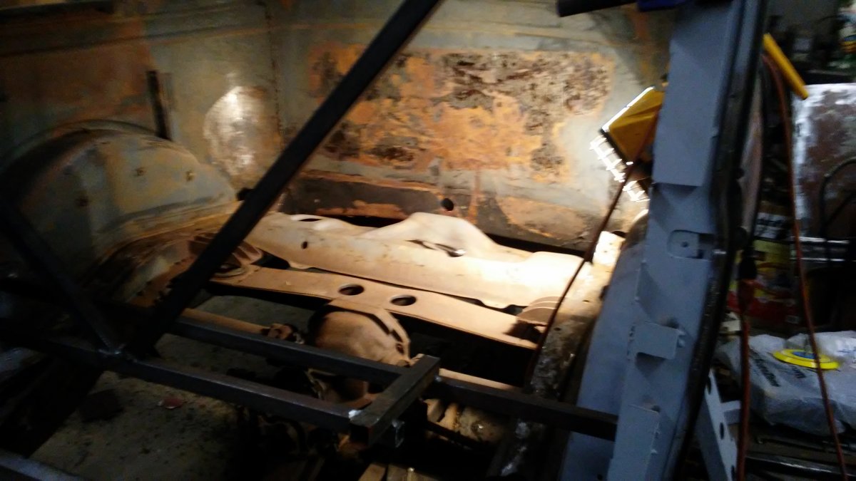

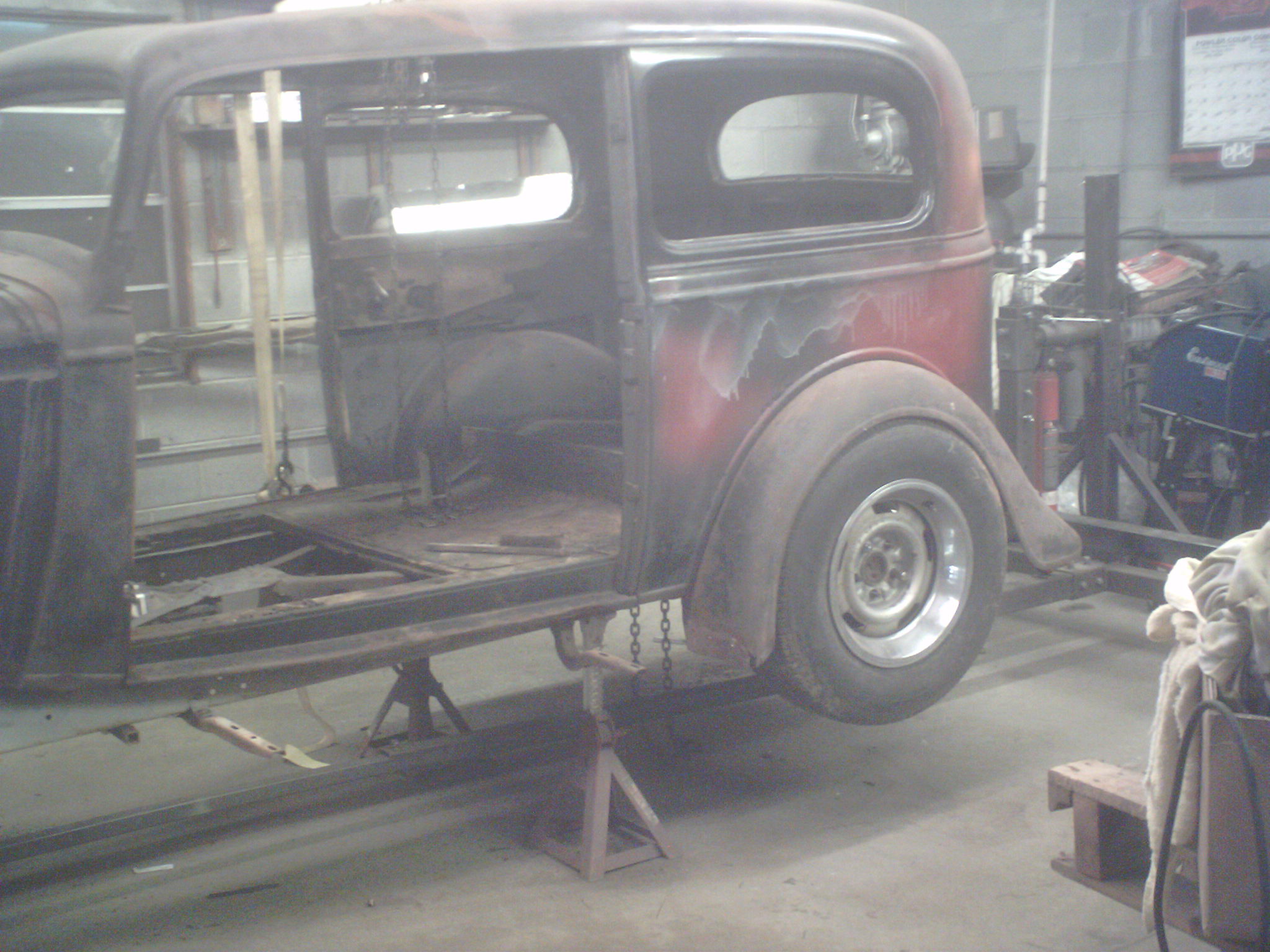

  24. madmike3434
    Posts: 691
    madmike3434
    FLATMOTOR 40, what body style are you working on in the pictures. The back panel appears to be square for some reason.
    I see by the cardstock that what you seem to be missing is the L & R foot floor risers that gives the correct angle for the floor boards. I may have another set ?
    mike

  25. flatmotor40
    Posts: 556
    flatmotor40
    from georgia
    It is ma standard 2dr sedan just layed the floor in not welded yet.I got the car and it was chopped up here and there.Cut the back half floor out last week and the wood at the back was gone with rot so replacing with metal as I have done all the other with metal but not welded in yet.Using 14 ga for all metal inside.Have done the doors and installed the power window units because the regulators that came with it was junk.Have days I can see how to weld and other days I have to stay away.Having eye troubles these days.But after welding and machining for some 45 yrs or so my regu lar job before retirement I guess I need to take it easy.

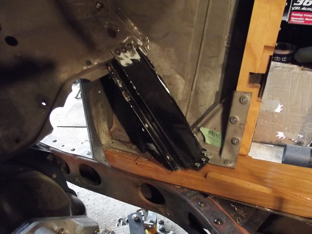

    Posts: 556
    flatmotor40
    from georgia

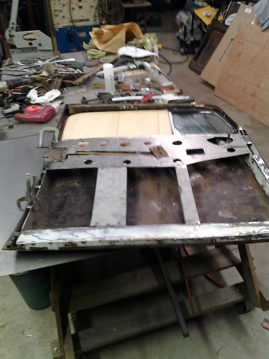

  27. madmike3434
    Posts: 691
    madmike3434
    looks good, you put in a lot of time in fabbing the sheet metal for door.

  28. flatmotor40
    Posts: 556
    flatmotor40
    from georgia
    Thanks it mounts the power window firm.Working on rear floor now sometime when I feel like it.Have 3 more cars to drive while I work on it
