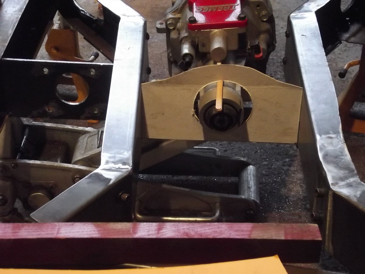

  1. what is the procedure to get the tranny out, once all the cross members are in and the body is on?

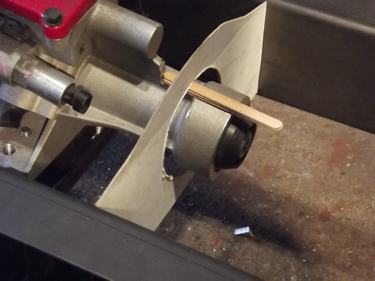

    MIKE ROUSE , I wasn't taking offense at your suggestion, I was asking for your input. After all , we all need help and direction, nobody can see all the sides at once and it helps to have input from others. Like a bunch of guys working away and one says something that just makes total sense , and how come I didn't think of that. ? More brains than one.
    I was going to add another cross piece like the one around the trans end with large hole, back maybe 8--10 ". Like you suggest I already have in stock some 10 gauge plate to bolt too the top x member area and another to be made for the bottom. All attached with grade 8--9 button head allen heads.
    Question , why place a round pipe in the hole that sits around the trans tail.?
    If the hole is 4 1/2 " round and I can find a pipe that size, should I make the pipe insert the same material thickness as the plate, about 4 gauge or 3/16 " , or drop down to 10 gauge about 1/8 "thickness..
    How long should this pipe insert be. ????

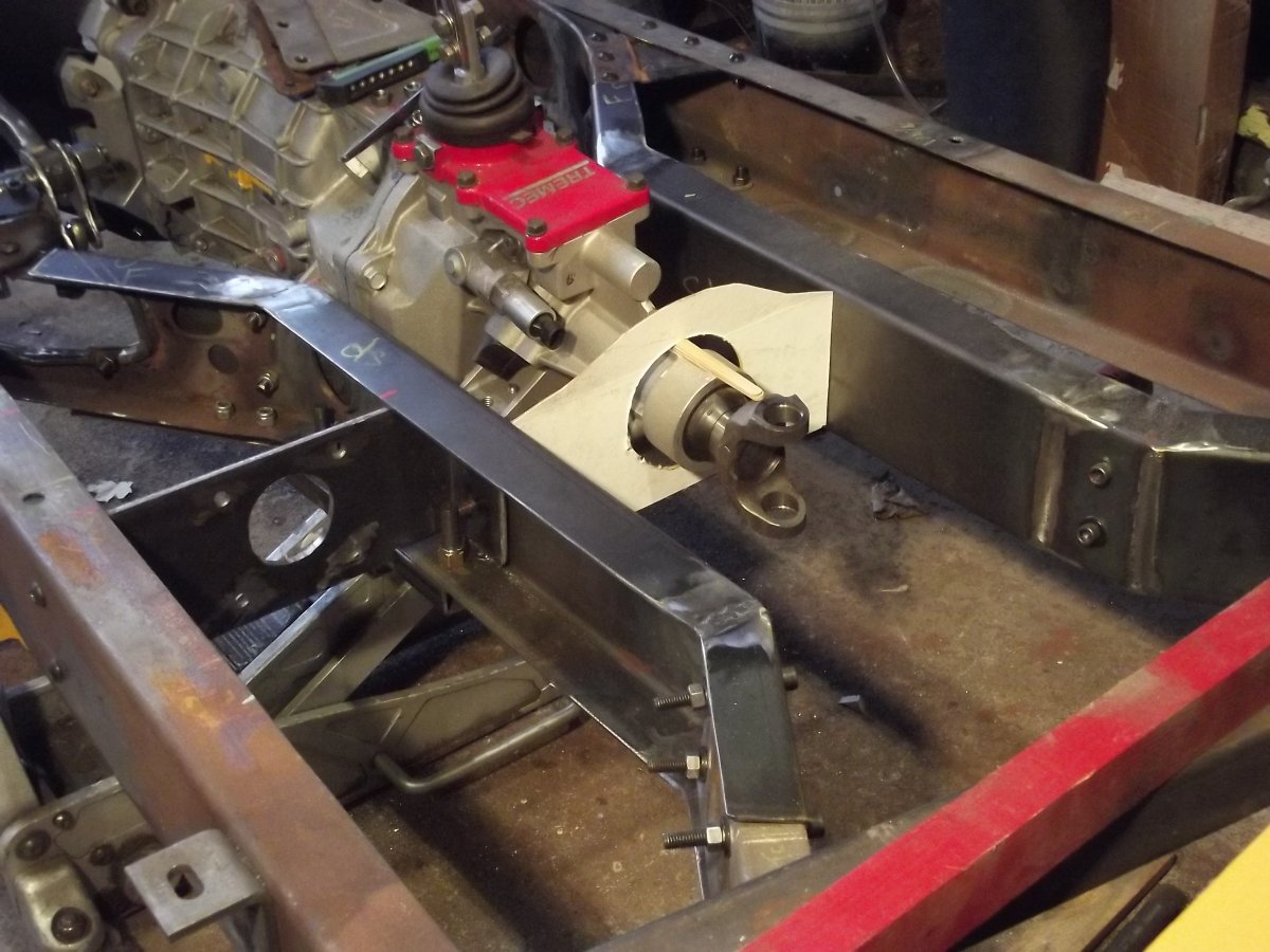

    TB33........hopefully just undo the lower trans mount I made and remove and also the bracketry behind the trans which will be removable also. Doing it this way because of below with 700R4.
    My 35 coupe the stock X member system will not allow me to remove the 700R4 from the motor. just not enough room to pull backwards or lower tail shaft thru the X even with the center plate removed.
    As can be seen of my coupe chassis.

    I would suggest adding a plate at the top and bottom that bolts in. This will be easier to remove the transmission if needed and it will add more strength for the torsional forces that run through the cross member.

    MATT, that's exactly what I was planning to do and I have the 10 gauge sheet already purchased to do it. Was going to go up a little farther on the sides and the rear area. Will make patterns in cardstock and see how it looks and if the extended legs make any sense.
    Question , what computer programming do you need to be able to do the RED GRAPH on top of the frame picture.
    thank you for your input...................mike lynch

    Mike. The pipe was to increase the torsional rigidity of the cross member. It may be overkill.
    I think Matt’s idea of large plates bolted top and bottom is a mor practical solution. With the consideration of access to the transmission removable bottom plate would be best. Also looks like the way Chevrolet solved the torque problem except they riveted it in place.

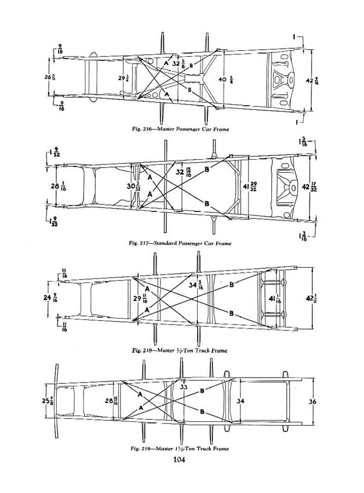

    34 Chev chassis.jpg mike rouse ... as you can see by the frame stock pictures they were really figuring that 60 hp engine was going to tear it up, LMAO They put 186 -----3/8" rivets to hold it together, plus the gussets in the front and rear x member corners. Was quite an elaborate setup considering that the 34 standard frame was just a K style cross member further back.
    Prior to installing the ZZ4 350 , I ran a 1957 olds 371 punched out 1/8 with 1/4" stroker crank and backed up with 55 olds 4 speed auto. Would carry the wheels in first gear and slicks. Torque used to scare me, it would pull strong to one side, before straightening out. Ran mid to high 12 at 115--120 mph.
    The old frame out of my coupe is whats going under the roadster that's pictured in the mods. Never twisted a quarter panel or any other sheet metal.
    MIKE ROUSE, thanks for your input, if I end up south this year, will call and make a pop in.
    Pictured is a diagram of 34 std frame as comparison to why its a lot weaker.

    Mad Mike, great minds think alike :) I used a program called Fast Stone to take the screenshot and mark up. I work for a structural engineering firm and use this a lot to communicate ideas. Snagit is another program that is similar in function.
    I think your idea of going farther out on the sides and to the rear is great. More strength!

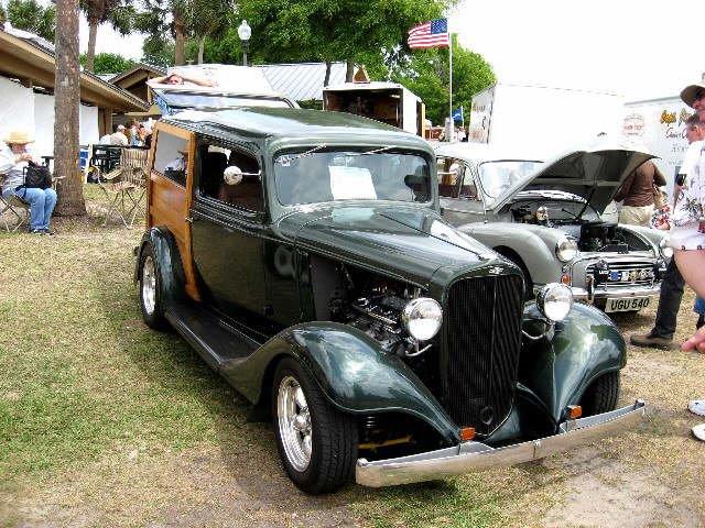

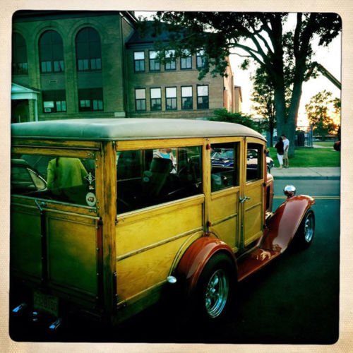

    ran into this picture of a 33 coach chevy, STANDARD SERIES , with the back half converted to a woodie. Only picture I have.

  20. Six Ball
    Joined: Oct 8, 2007
    Posts: 5,839
    Six Ball
    from Nevada
    Nice. I like the Morris Minor too. I had a little Morris woodie in the 60s. It was really fun car.
  21. Chuck Craig
    Joined: Jun 11, 2016
    Posts: 284
    Chuck Craig
    from Ocala FL
    The woody is a first for me also.

    wo9578a.jpg wo9578b.jpg CHUCK, chevy woodies of the 33--35 era were made on truck chassis and produced by Hercules Campbell a supplier of special truck bodies to GM and also the roadster and phaeton bodies.
    I have somewhere pictures of a MINN build of a 34 chev std coach with custom woodie body from windshield firewall back.. He really did a good job. Car got sold to a calif buyer few years ago.
    pictures of 33--35 woodies, these were built for the USA government for Forestry Dept. , that's why so rarely seen.
