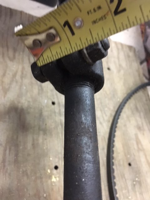

    IMG_2333.JPG IMG_2334.JPG IMG_2335 (1).JPG this is what I pulled off my 30 coupe

    its not a part that I run into when searching ebay for Chevrolet stuff.
    Just went for a search on ebay USA and typed in..........1930 Chevrolet tie rod end clamp.
    Search using ADVANCED .
    was a few for sale but has a stud on end, not hole like your showing
    went back to ebay and searched 1932 Chevrolet tie rod end..........found a couple of them, price a little crazy
    mike lynch
  3. Thanks guys. I just said screw it, and got the ball joint style. Now the just remove the ballstud...
  4. And taper the hole . 7 degrees ???

    I was thinking that too, might be easier to just purchase the tie rod ends with taper and take the clamps off , which is really what he has mislaid.

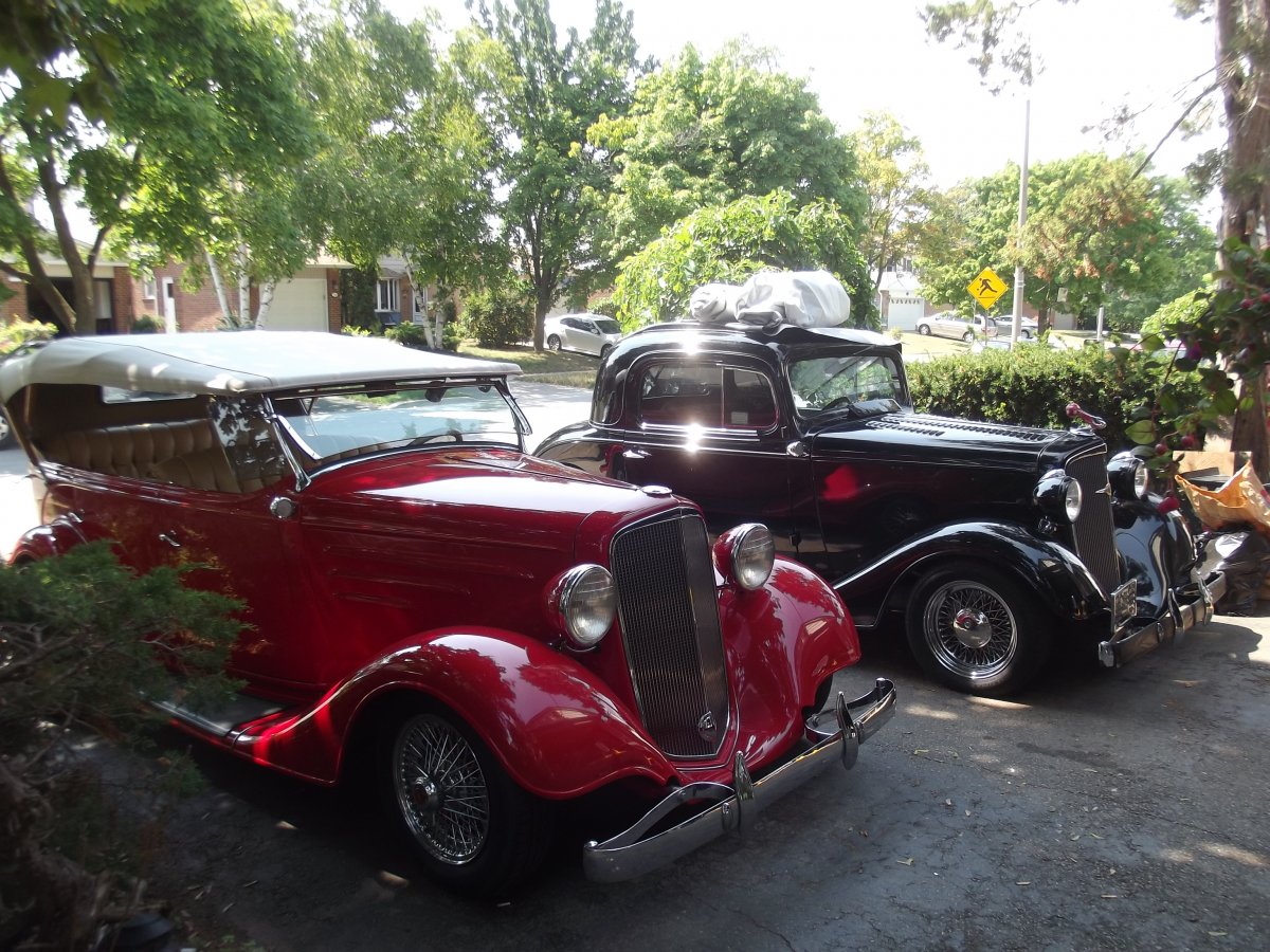

    1935 CHEVROLET MASTER............was at a local cruise nite tonight and a reader of this section recognized my phaeton and asked me if knew where he could get a a 1935 master left front fender. He just got a 35 master shipped to him and it had 2 left front fenders. So I guess he is either up for outright buying one or swapping one his lefts.
    Got anything
