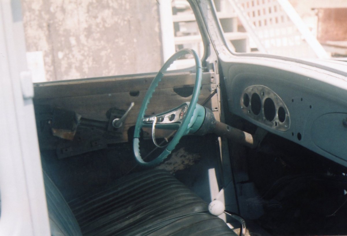

    Fortunately, my original rockers were in really good condition. They just haven't been reinstalled since the steel floor and sub rails were put in. Here are some before and after interior photos.

    E-GODS... What a mess on those "before" photos! You're coming along REAL well Torkwrench! Dig that Impala steering wheel bigtime! With your Master dash, the passenger side is a glove box?

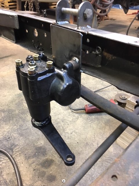

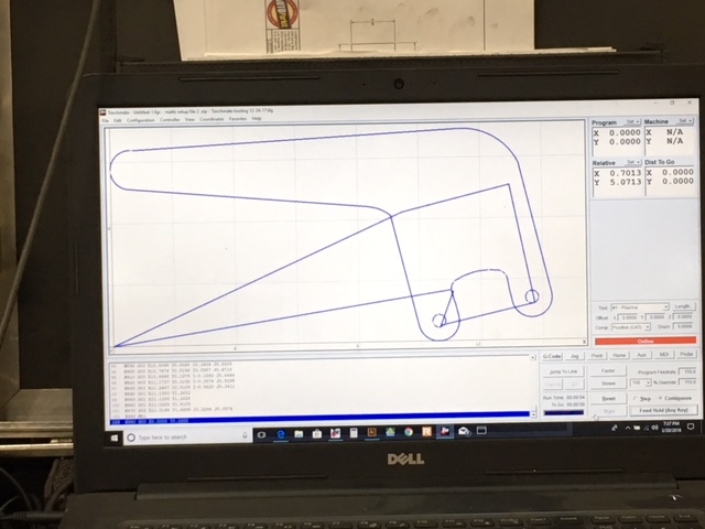

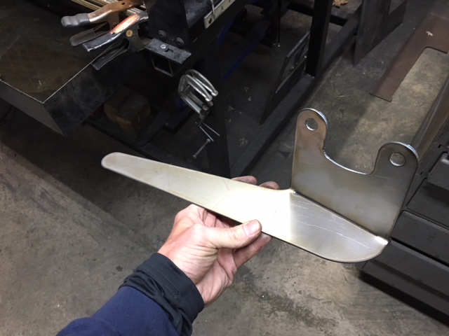

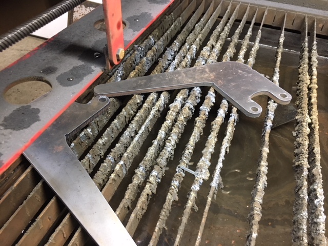

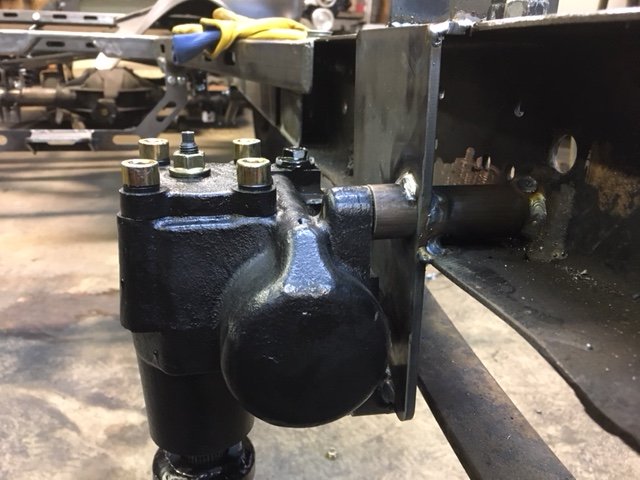

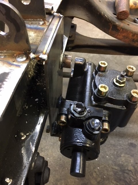

    Spent the night getting steering box mount made and made new steering arms have steel cut but have to take to a bigger press to make the bend then we can start mocking up steering and finish the final shape of the steering arms.
    IMG_1837.JPG IMG_1843.JPG IMG_1846.JPG IMG_1850.JPG IMG_1851.JPG IMG_1854.JPG
    Torkwrench likes this.

    Your chassis is really shaping up nicely JGR - are you going with the cross steering setup?

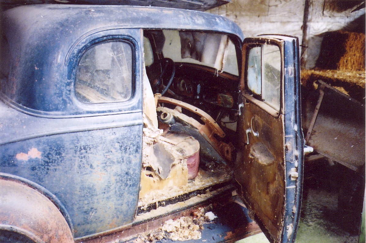

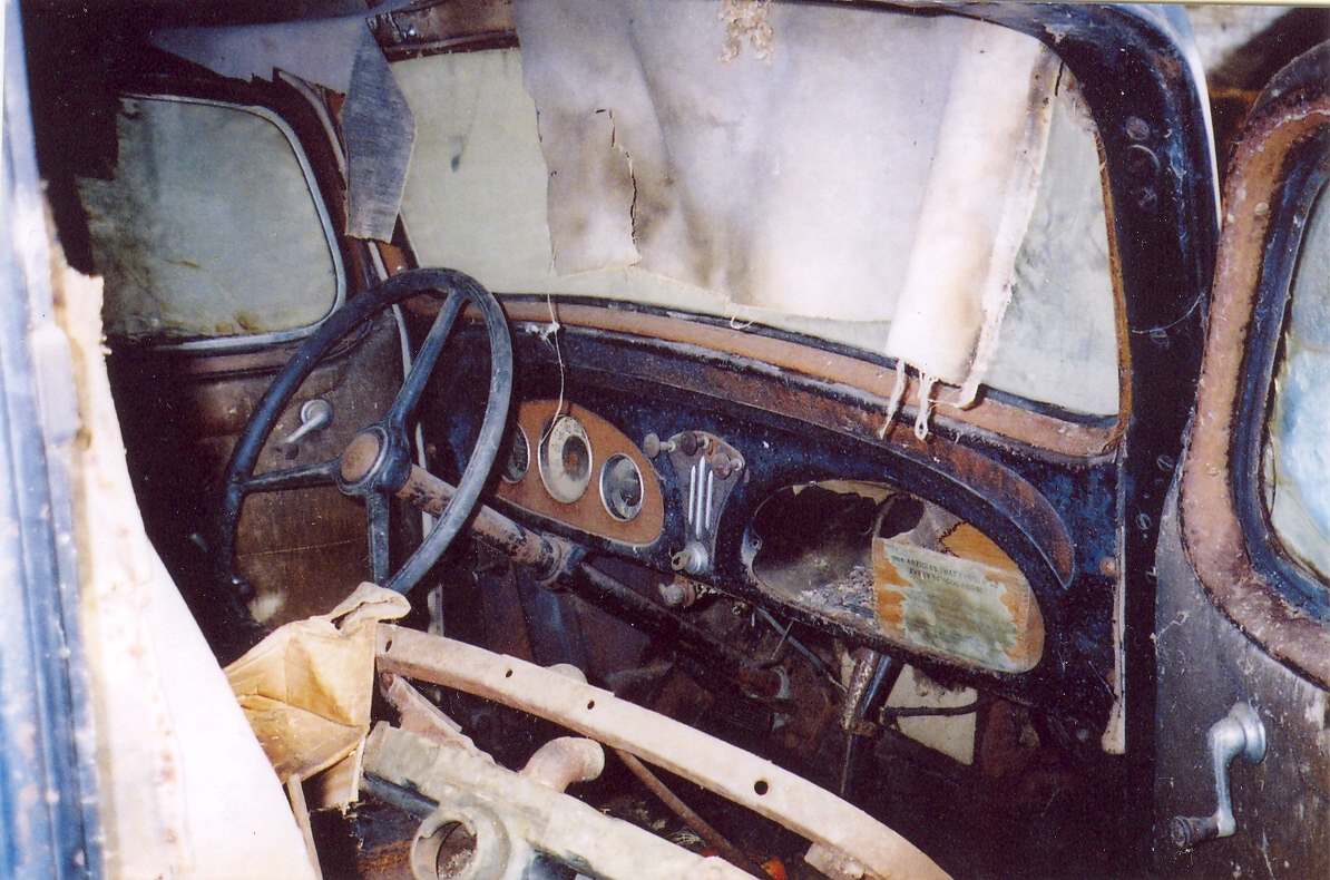

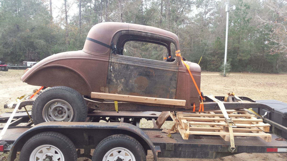

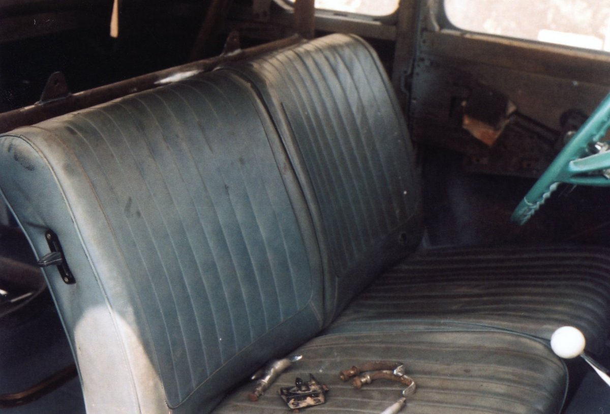

    Yeah, it was pretty nasty inside. Not sure what all was living in there. Mice? Rats? Raccoons? Possums? Fortunately the previous owner, (a good friend of mine), cleaned it all out when he bought it from his Father-In-Law. His wife's family had owned the car from about 1959 to 2005. Before that it was owned by a Joe Newcomer in Princeton ILL. When I bought it, (in 2008), it had been partially disassembled.
    The passenger side is a glove box, but the door was missing. Have since found another door. By the way, if anyone with a 34 Master wants a pushbutton style latch for their glove box door, one from a mid 1960's IH Scout practically bolts right in. That's what I used in mine.
    Yes, it was a very solid car, when I bought it. The only really rusty areas was the taillight area of the right rear fender, and the bottom corner of the grill shell. The engine was pulled in the early 1960's for a rebuild that never happened. As a result, the grill and shell sat upright on the floor for about 40 years.
    About the only parts that were missing were the glove box door, radiator cap, hubcaps, and taillights. Have since found a nice grill & shell, glove box door, right rear fender, and radiator cap. Plan to use 53 Buick taillights. The running boards were junk, but I bought some steel, "smoothie style" ones, that I plan to use with running board mats.
    Here are some more photos. The first two are from when the P.O. bought it, and the last three are what it looked like when I bought it.

    Yes Vega Power box with cross steer, was a pain to fit in but once we made new motor mounts should all work. Of course when I get to headers and steering linkage may have to get creative we will see.

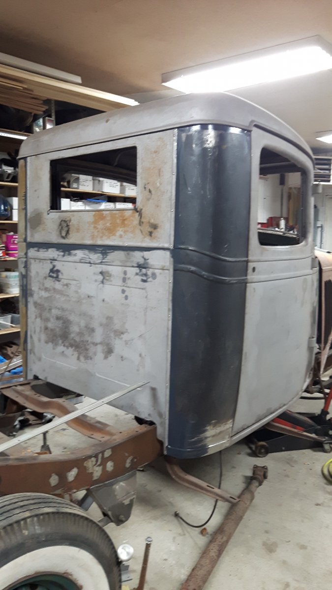

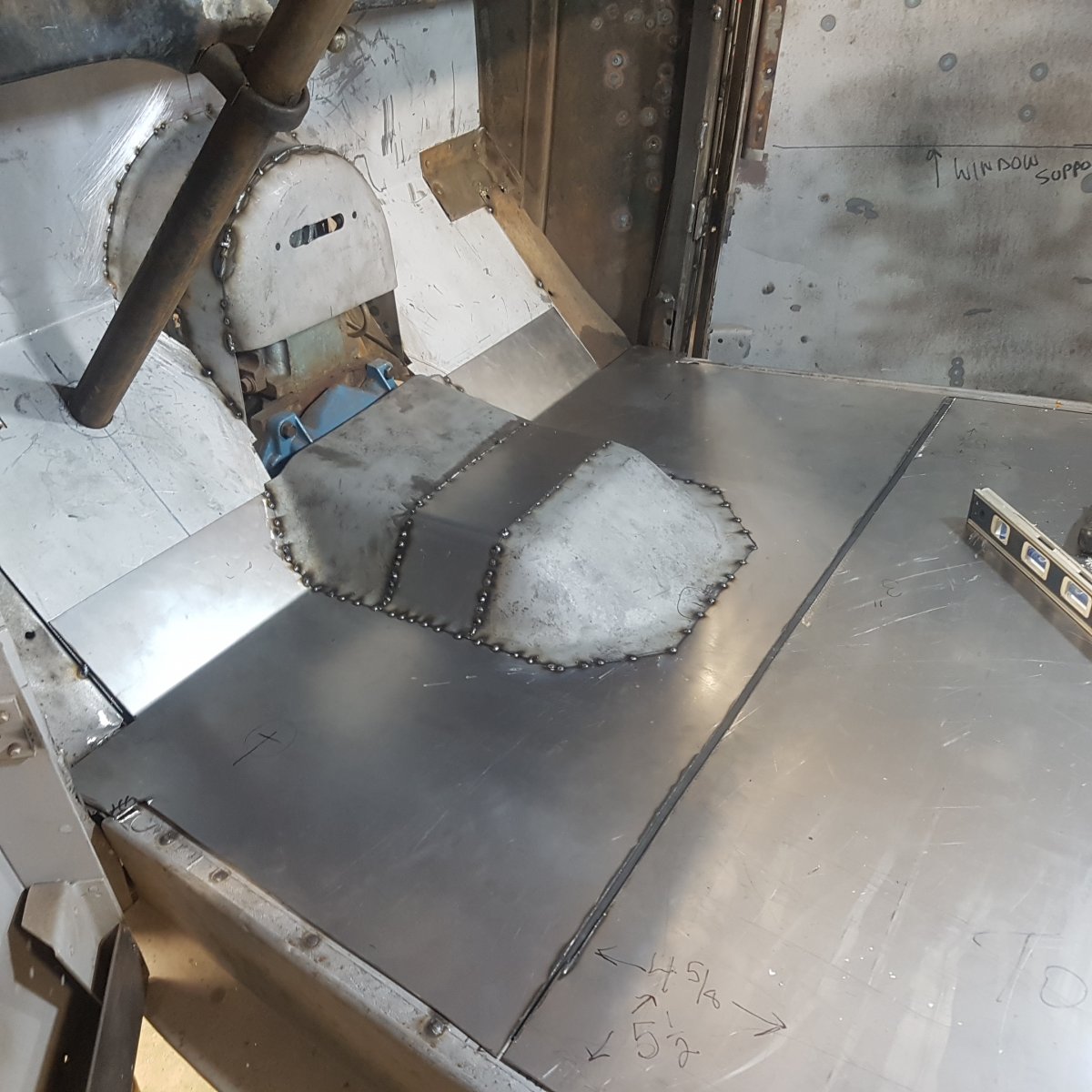

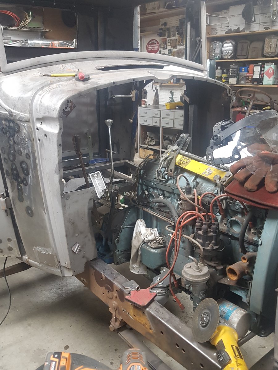

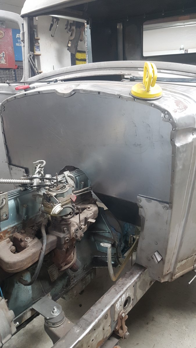

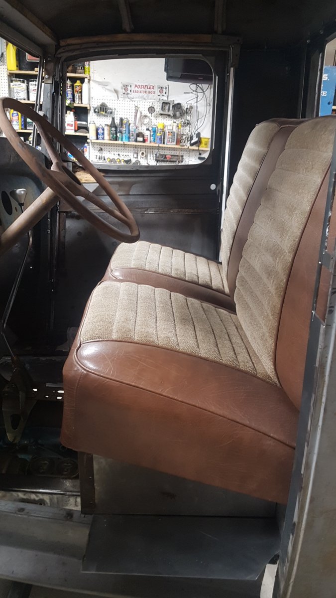

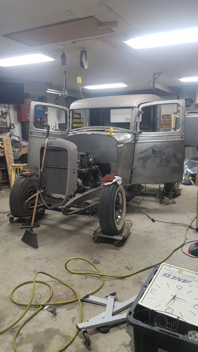

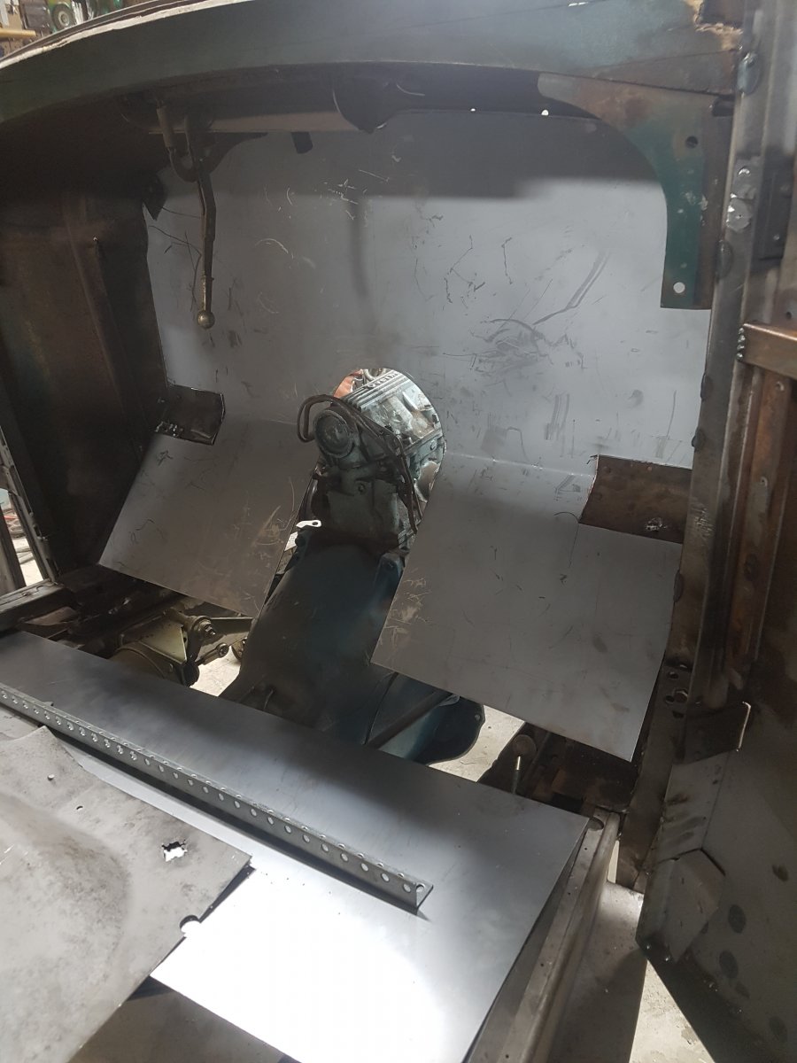

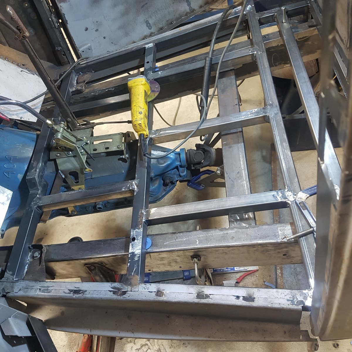

  20. This is the 34 chev truck I am building now .
    230 pontiac overhead cam , 200 4r trans ,
    Toyota 4 runner rear 4.11 gear .
    Replacing all the wood new sub frame.
    New floors and firewall 20170929_212959.jpg 20170929_213243.jpg 20180207_202506.jpg 20180208_063050.jpg 20180209_224056.jpg 20180210_122606.jpg 20180209_224414.jpg 20180303_171808.jpg 20180226_213047.jpg
    cactus1, Fern 54, 31chevymike and 4 others like this.

  26. A few more pictures of the sub structure under the floor 20180311_153555.jpg 20180311_153614.jpg 20180228_220344.jpg 20180228_220409.jpg 20170929_213104.jpg
    cactus1, Six Ball, Fern 54 and 4 others like this.
