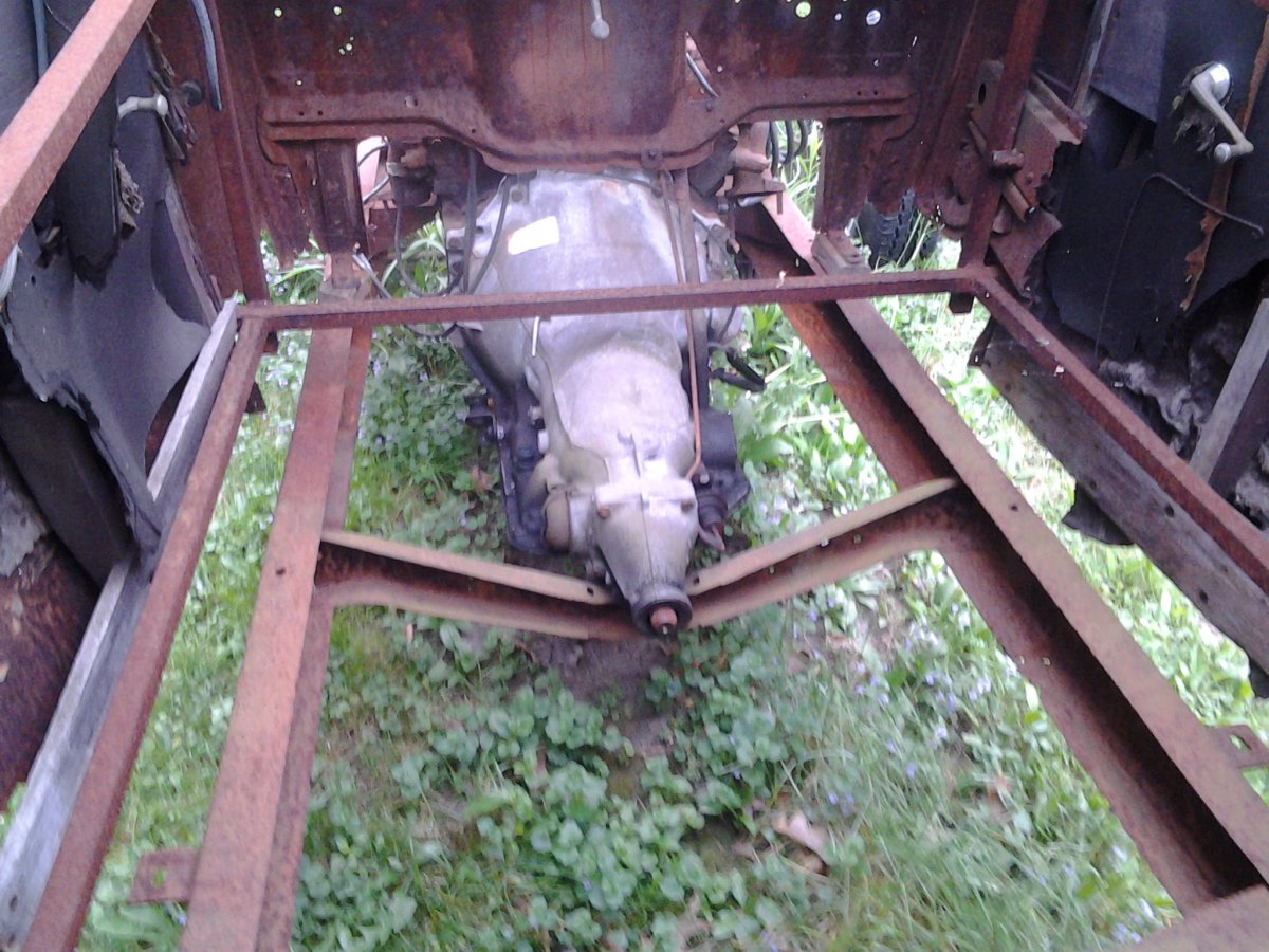

    20150510_194224.jpg 20150510_194307.jpg 20150510_194553.jpg A couple more shots she needs little floor work

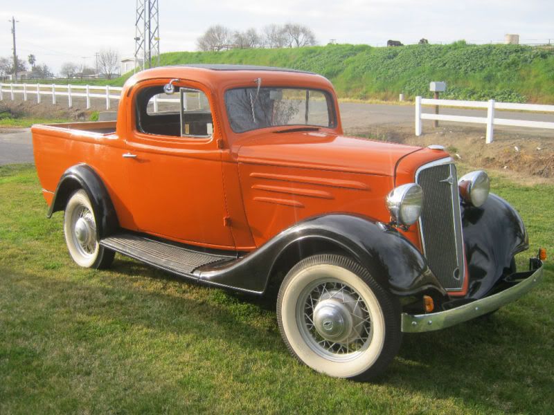

    1935 Chevy roadster utility that was for sale, not to be confused with another body style as in the black roadster pickup below the utility.
    This is a 34 Holden bodied roadster utility that I know of currently in the US

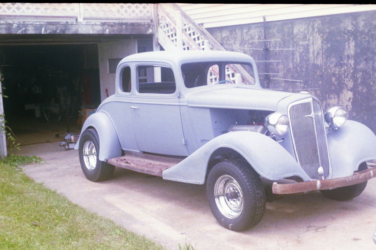

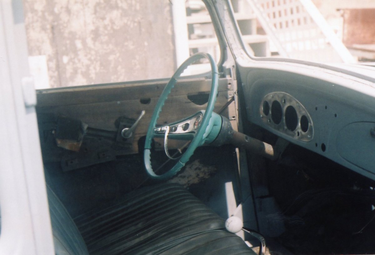

    This car has been In our family since 1962 my older brothers bought it entending to build a hot rod out of it but that never happened. I remember this coupe being so complete it still had the shade in the back window..I use to sit in it and make motor noises when I was nine or ten years old .I always wanted to buy it from them but they would never sell it.for some reason it got pushed outside were it sat for 25 years and once the Ohio weather got to it well you know chevys.well one of the brothers decided to take it to his place were it sat in his garage still won't sell it to me. Flash forward ten years I get a call from my brother you still want that old chevy well hell yeah he says come and get . Turns out he bought his wife a new firebird and it wasn't going to sit outside so after all these years it's mine I plan on replacing the wood with steel and yes some times I still sit in it and make motor noises.

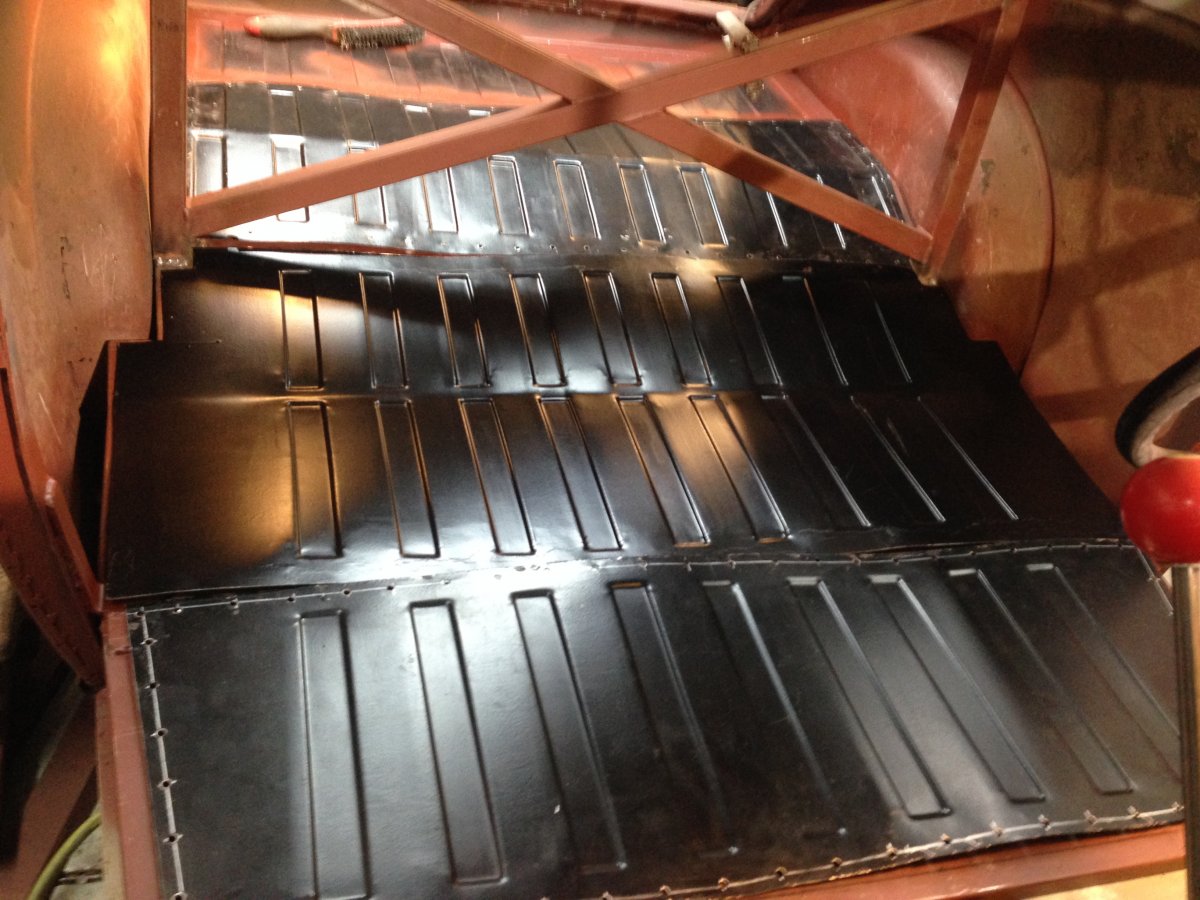

    A picture of my floor in my coupe.

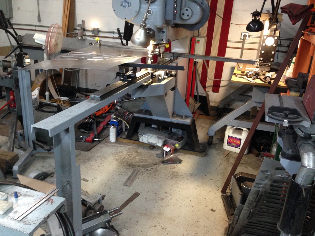

    nice to have some neat machinery around in order to be able to produce trick parts.

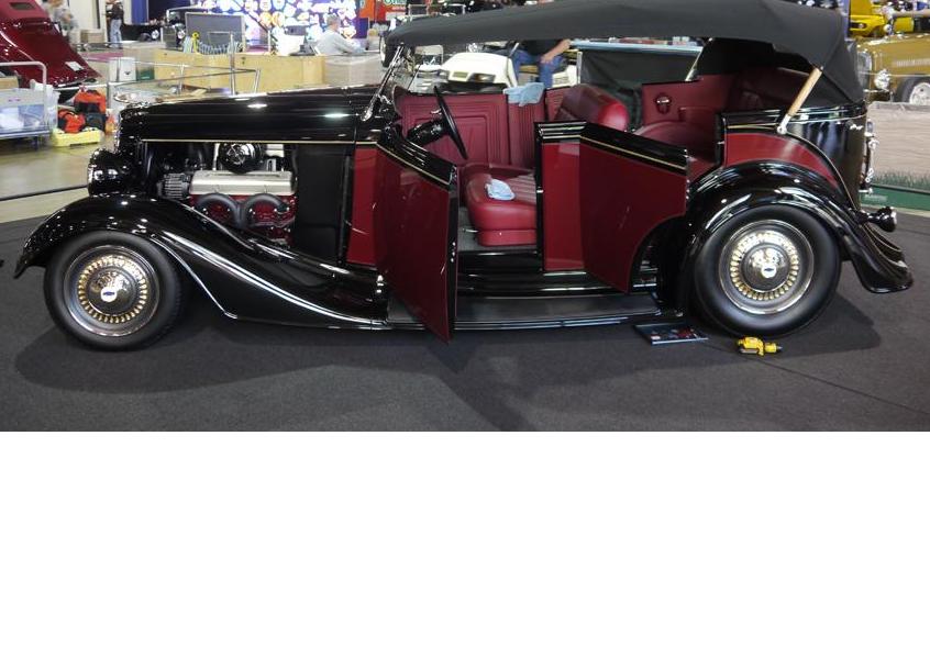

    35 chev mike & linda A.jpg MGTSTUMPY...........mark. The 1935 Chevrolet standard series phaeton your showing in red & black paint. Was the 2014 Grand National Roadster Show, grand champion. First time for a Chevrolet to win it. That chassis was stretched 3-5 inches, and the body was stretched on the cowl under the hood.. The body for the 35 phaeton USA was built in Tarrytown NY as were the roadsters. Both bodies were built by an OUTSIDE SOURCE , supplying to GM. I believe that company to be Hercules Campbell . Closed cars and the Cabriolet body styles were produced by Fisher body.
    From what I have been able to observe the USA main body the SWAG LINE as the Auzzies call it , down the sides is way diff from my red phaeton pictured a few posts up. See the black 35 phaeton swag line mark posted pictures of. Also as I discovered the Auzzie HOLDEN cowl is about 1 1/8" wider than a USA cowl. I know this because I bought a CARTER-DUVAL style windshield and it was 11/16" per side too wide. We narrowed it to fit.
    1934-35 standard series roadster and phaetons USA , the windshield frame only has 3 metal sides , the Auzzie HOLDEN has all 4.

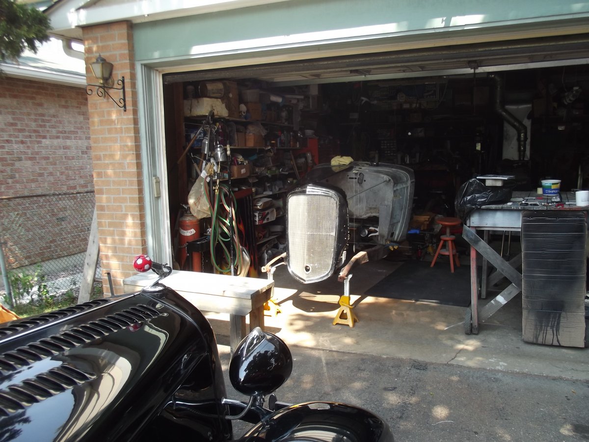

    [/ATTACH] DSCF2108.JPG DSCF2410.JPG DSCF2412.JPG DSCF2412.JPG
    Possibly the only 34-35 chev in North America or in this case Canada to have a duval style
    mike lynch

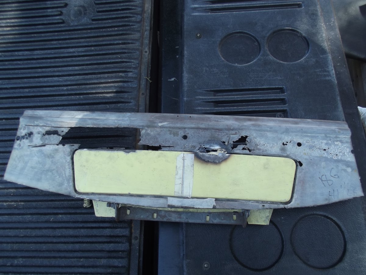

    Notice the top of the cowl section has the cowl vent removed , because of the Duval windshield sits on top of that area. The replacement panel was formed with special machinery and a modified die. Note the body bead rolled into it and also the panel goes over the cowl and forms around the wood U collar underneath.. Because of where this car was originally from , the water got trapped between the wood collar and the metal cowl top. It looked like a Swiss cheese with large holes . To repair this properly cost me around $1200.
    I really like the carter/duval really adds some style to it. It will be powder coated satin black.
    mike Lynch ./....................canada

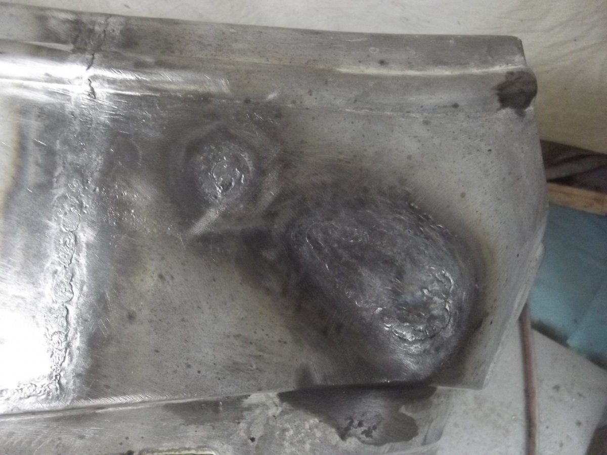

    ]3540678[/ATTACH] [
    ATTACH=full]3540680
    here is how the top of the cowl was found after all the bondo and whatever else had been applied to it.
    the firewall was chemically dipped in a solution that does not hurt the metal and completely removesd the rust.
    mike
