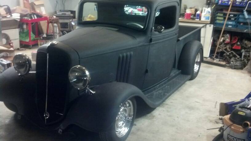

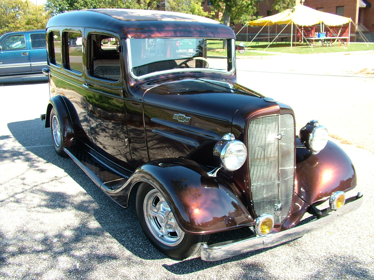

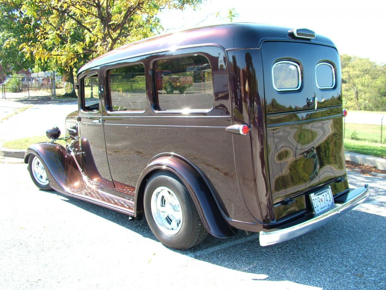

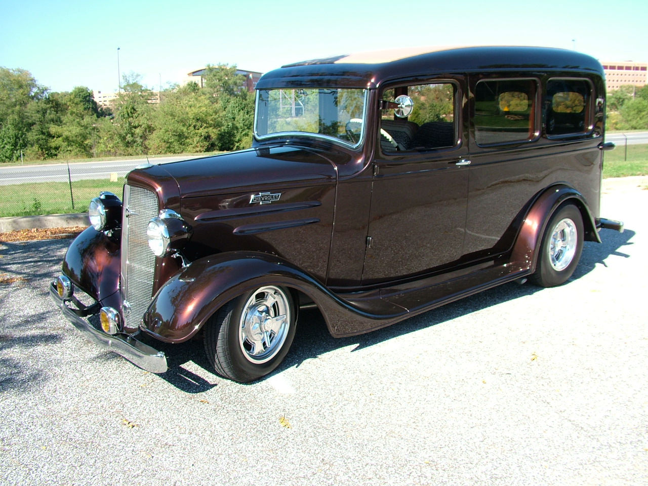

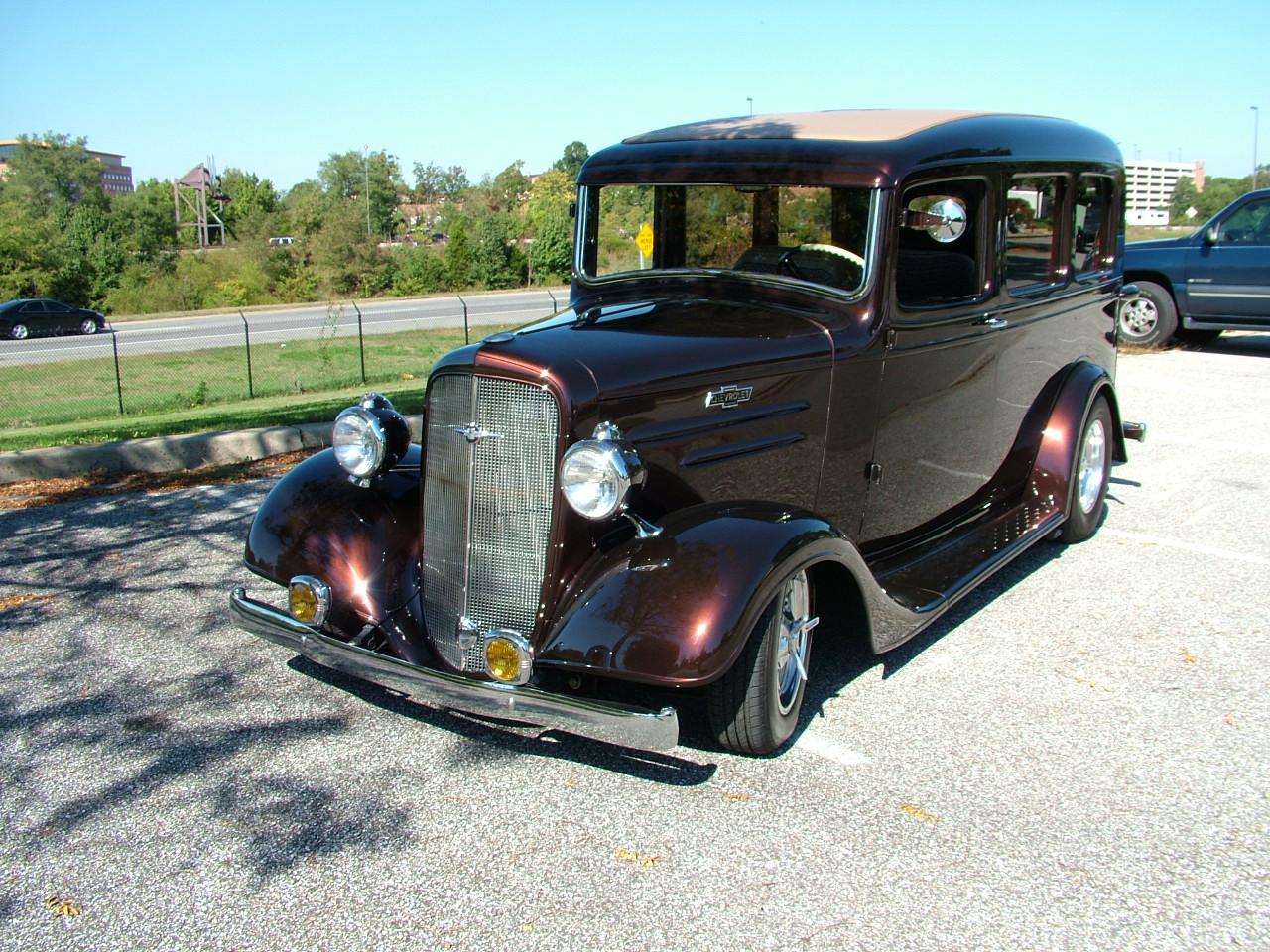

  3. Mike, Nice looking 36 Suburban. Would love to see more pics.
    Skippy Craig the trucks coming right along, looks good.

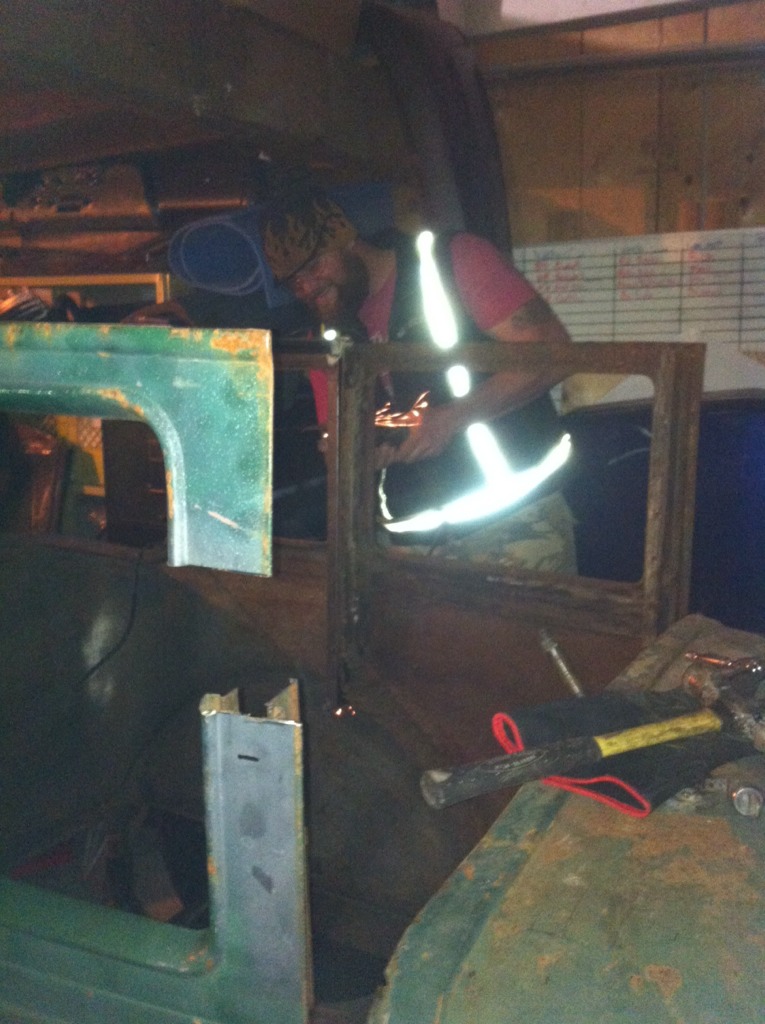

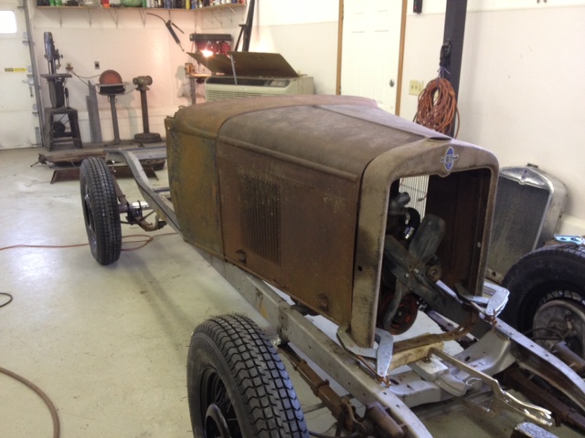

    I bought the body parts off craigslist for $300 and except for one of the doors, it was wood less. When we started the chop we couldn't get the wood out so just cut through it. A little bit of fire and a lot of smoke filled the garage but boy did it smell good ! ImageUploadedByH.A.M.B.1392577442.681839.jpg ImageUploadedByH.A.M.B.1392577473.368060.jpg ImageUploadedByH.A.M.B.1392577507.906496.jpg

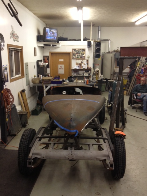

    not sure if I posted pics of dad's 31' roadster or not. His first early Chev was in 1958-59 with a 34' 3W. Sold it in early 90s. Over the years we've had approx. 20 early Chevs between us, mostly 31-34.
  9. Don't think Mike wud mind me posting these as I've sent them to him previously. I have a few more of his 'Burban that I took at TRJ Revival, but he can put those up if he wants since it sounds like he needs some practice posting pix.:D:D

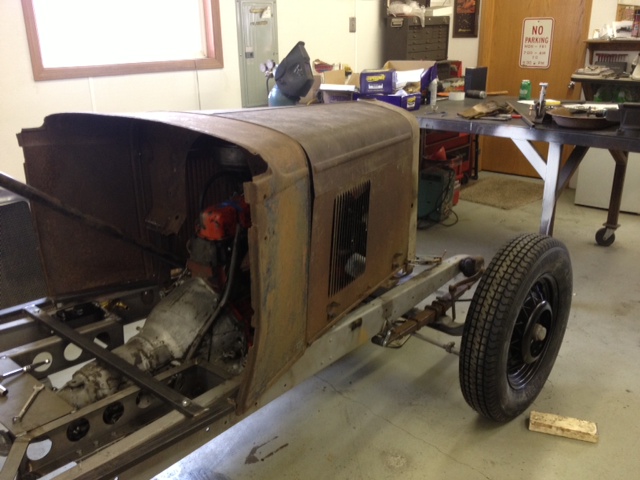

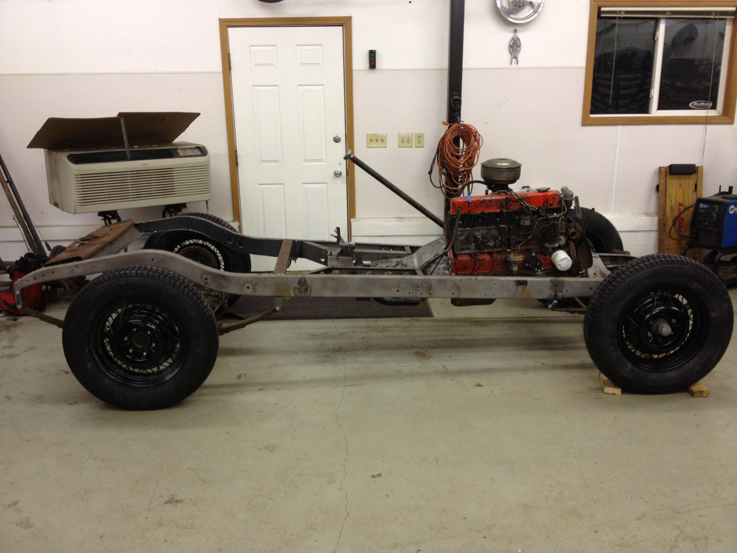

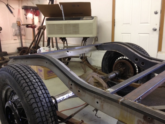

    Board tracker progress for the week. Engine and trans are happily mounted in the frame. Dave, (Roadburner1) did some awesome work fabricating the mounts. All the measurements are right on. Tonight I get to cut the firewall for clearance. Gary

    That is looking good. Do you have in between pictures? I'd like to see moer detail of the X member you added.
  13. 2NDCHANCE,
    That's a GREAT start! If you are doing a single seater, you may consider making the frame rails parallel, and moving the springs outside the rails- this will give you a slimmer and lower profile.

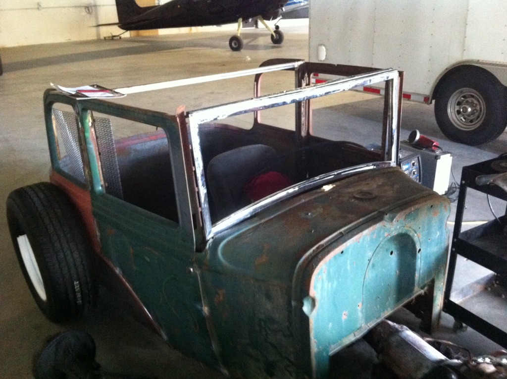

  15. Would like to know what people are doing for windshield posts when the wood and post covers are gone on the early chevs. Windshield frame gone as well... We got some weird shaped 1x3 going on and may use a model A windshield frame but what have others done? ImageUploadedByH.A.M.B.1393288765.820647.jpg
  16. Most of the trucks of that era were sold as cowl and hood with chassis. The bodies were mostly built by outside suppliers for custom applications.

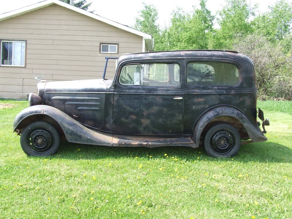

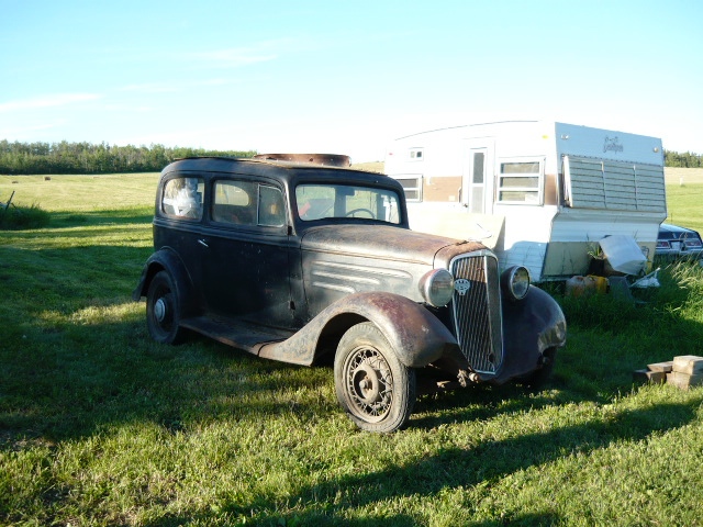

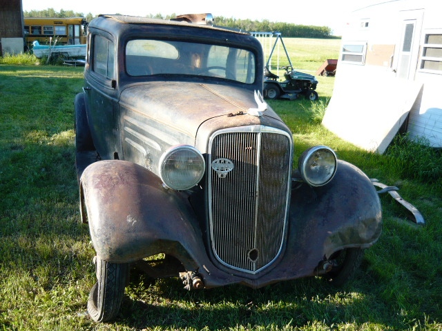

    This is the most chevy pictures that I have seen in one place. Count me in with my '36 chev , 3 window coupe. Been collecting parts for 2 years and this is the year we start the actual build. Yup, it's rough all right but I have one and hardly any one else does as there were only 211 , 3 window coupes sold in Canada in 1936. Thanks for looking.

    Very nice. It is a beauty. I hope you have doors. By the steps on the bumper and finder I assume there is a bumble seat. What are your plans?

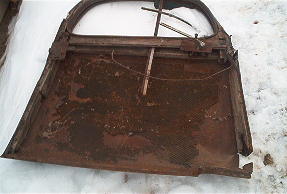

    Six Ball, I do have the doors but cause it's a chevy, there is no wood left to hold the hinges in the door. The passenger door had no window garnish and that was a nightmare to find. Yes my coupe does have a "stock" rumble seat. So far I have a M2 front end , 700r trans, Disk brake S10 rear end, 350 SBC 300HP and a set of corvette rally wheels, chev tilt steering, aluminum rad etc. Been collecting for the last few years but now its time to start putting it all together. Once I start, there will lots of pics from my build. Thought I would show what my doors are like just in case some one has doors as bad as mine are.

    It has all the original running gear...18,246 original miles. Engine hasn't run since about 1960 or so, but the oil in the motor is absolutely spotless!

    2NDCHANCE, Thanks for the pictures. It helps to see what you have done to the frame.

  28. We are recreating a really unique 34 Chevy roadster, had to sacrifice a rough 5w coupe. I have left over body parts I'd trade for a transmission and bell housing.
