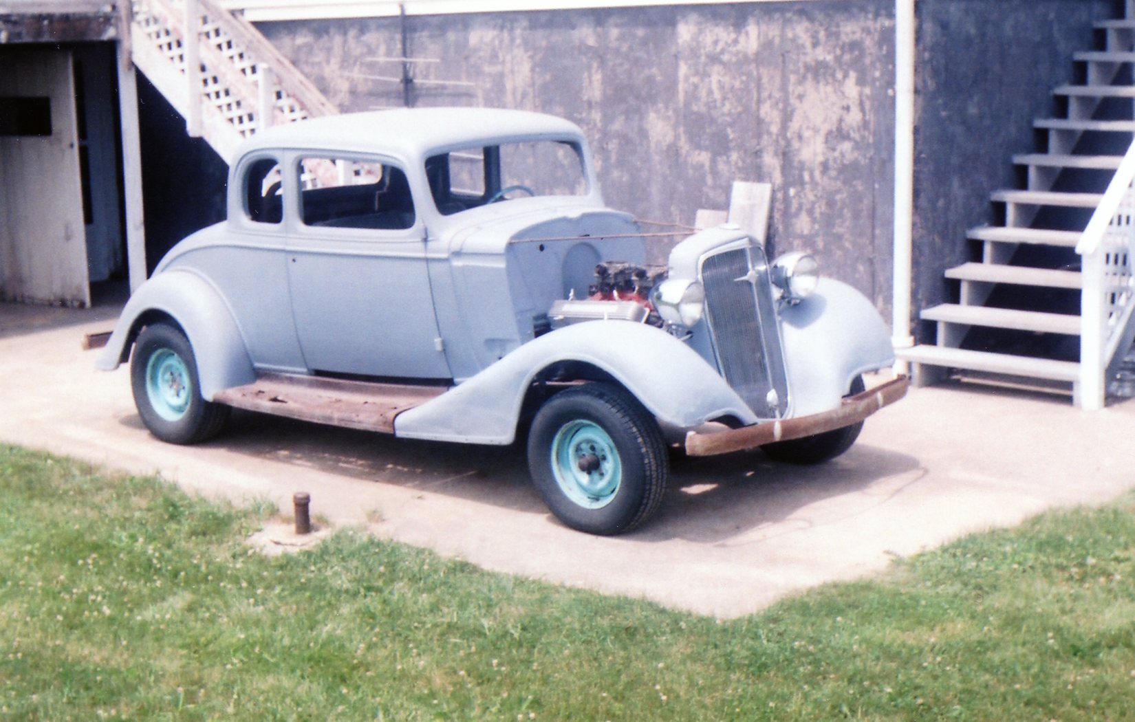

    My 34 Master after it came home from the fabrication shop.

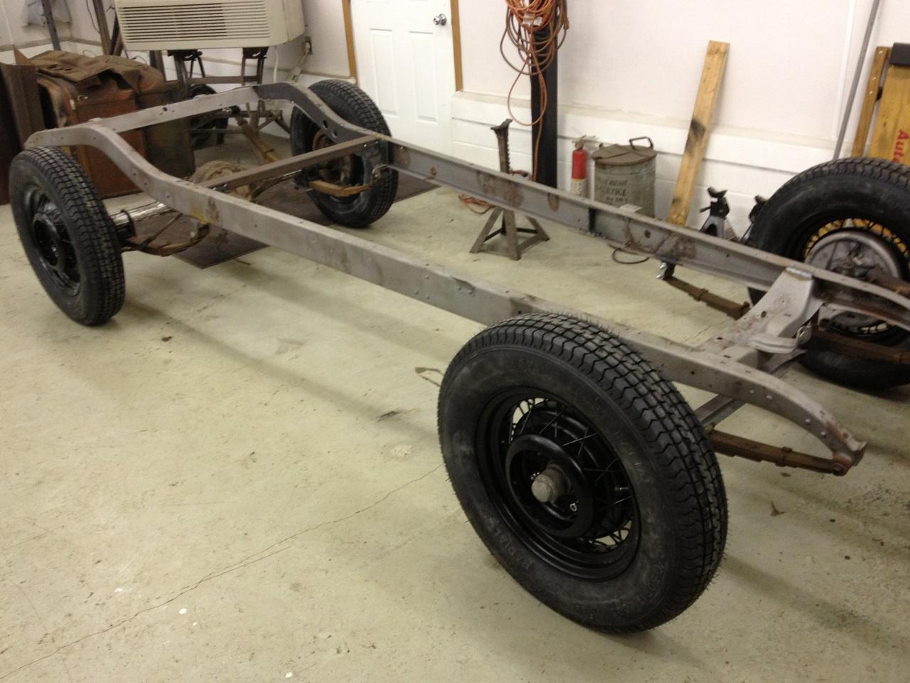

    1930 Chevy Board Track Racer in progress. We have been working on this about a week and a half. It's a roller as of last night. Engine and trans will be mounted this weekend with body work to follow. 17" Chevy wires with Coker Exselsior radial tires are just what the doctor ordered, but not cheap. I went the six lug route. 1954 Chevy pick up front axle bolts right on. Rear end is a 1995 Pathfinder Limited slip with just the right width to match the front end. Engine is a 292 straight six from a 68 Chevy 4 x 4 with a turbo 350 behind it (keeping it super simple). Gary

    Are you going to start a build thread on this project? I'm really interested in what you're doing as I have a 31 Chevy chassis I plan on using as the foundation of a roadster of some sort. That 6 lug pathfinder rear-end information is good to know. I can't wait to see more on this car!

    I to would like to be able to follow this build. Did you use the stock springs and mounts?

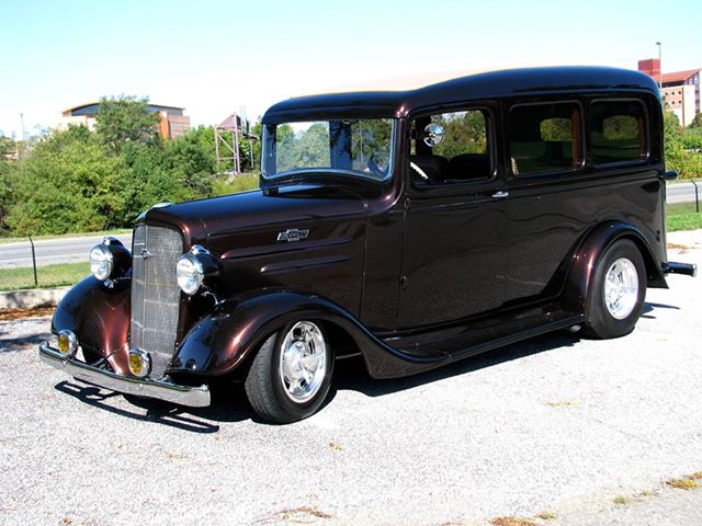

    Finally learned how to post a photo, so here's my finished '36 Chevy Suburban Carryall. 12 years after purchasing it from a local owner in Baltimore, I was told that the Suburban was built at the Baltimore, Maryland GM assembly plant in late 1935 and never registered outside of Maryland.
    The truck runs a '88 Corvette TPI w/700r4 overdrive tranny, 8" rear, Fatman Mustang II front suspension with dropped spindles and disc brakes. All steel with a few mods by Bad Donkee Hot Rod Shop in Littlestown, Pa.
    I made the debut at the Rodder's Journal Revival II in 2013 at the kick-off showing in Fell's Point, Baltimore, Md. Then at Pimilico for the rest of that weekend. Thanks to all who helped getting this project completed.[​IMG]

    We used the stock springs with three leafs removed from the rear. But not the stock shackles. With a small amount of work the shackle kit for the front cross spring (Speedway) works good. I just ordered an extra set of poly bushings for the front of each spring. Gary
  26. That is a sweet Suburban!

    That is a very awesome Suburban!
