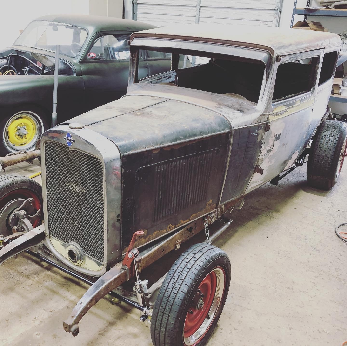

    Here is my 34 four door chev, not sure what model it is, it’s got the camel hump on the back. As I’m going through this thread I’m learning what to do for converting to steel. Just hung up on where to start or how to hang doors. Any pointers?

    Where did you find the wood???

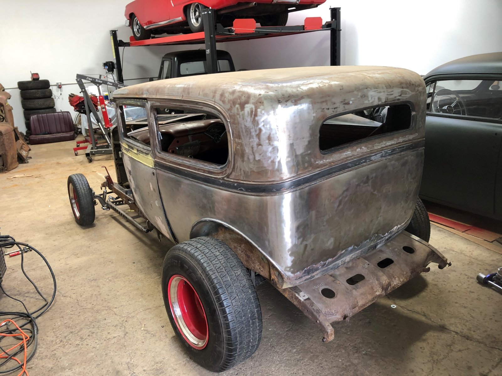

    I've been loving starting at the beginning of this thread. These pics are a few months old but I wanted to share what I'm working on. 31 Sedan trying my best to keep it 60's ish to the best of my liking. I'll post more pics of progress...already bobbed the rear of the frame and the front rails.

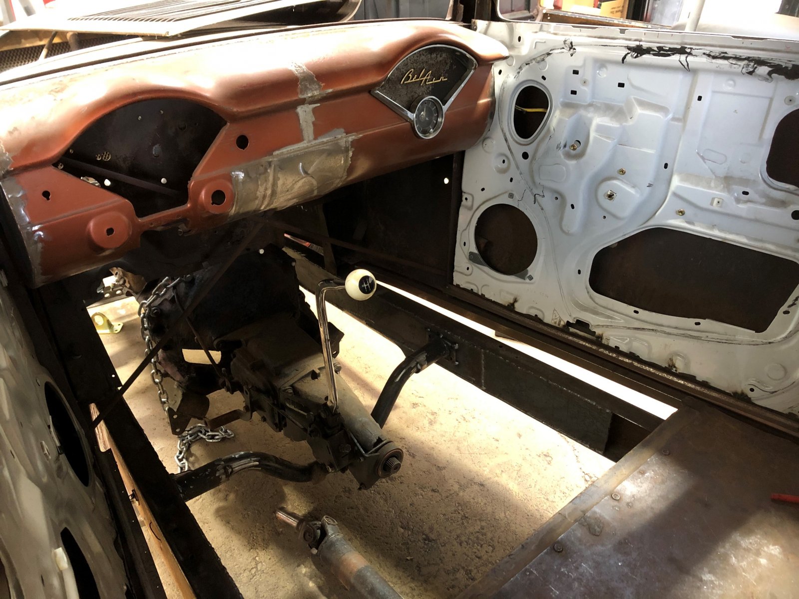

    Nice sedan. I like the Chevy dash. Do you have any more pictures you can share? I am going to dive into the internal structure (steel) to replace the old rotten wood.
    Here is a picture of mine.

  20. Jim, you have a '34 Chevy Master that I believe from your description is a '34 Master 4dr Sports Sedan. A picture of the backside would likely confirm that.

    That's '34

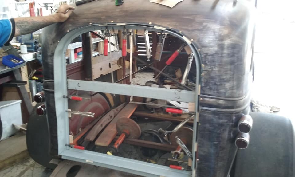

    Build your own door
