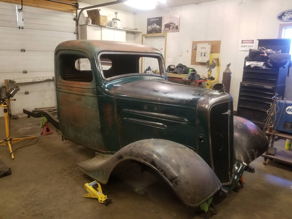

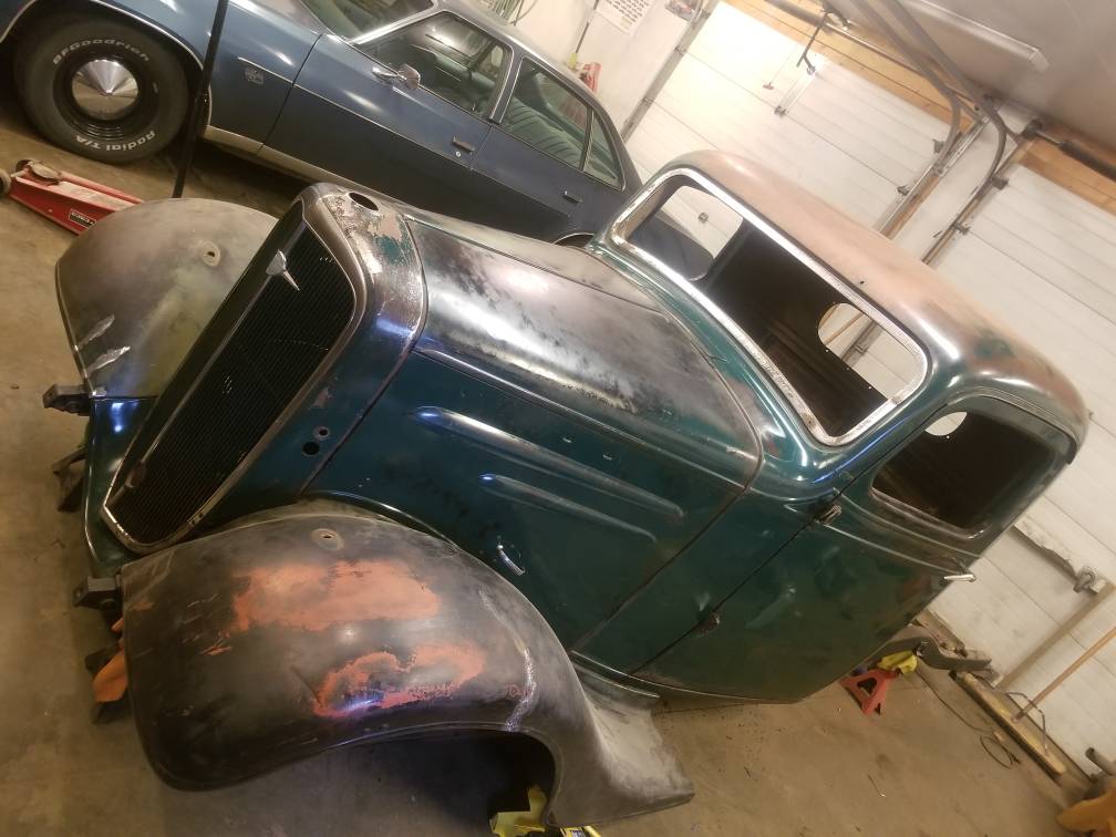

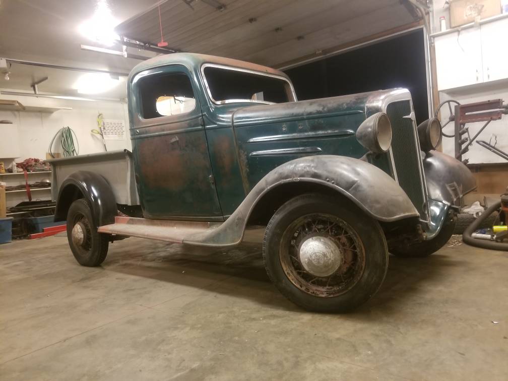

    Started test fitting the front sheetmetal on my 36 this weekend, I need to get the running boards mounted next so I can get all the gaps fine tuned to 1936 standards.
    Any suggestions on what rear end to use?. I want something with drum brakes and 6 bolt wheels. Ive been trying to find a 55-59 rearend but havent had much luck, I heard some of the Japanese minitrucks are the correct bolt pattern but I'm not sure which ones I should be looking for. Engine will be a mild 235 with a T-5 20190812_195412.jpeg 20190812_200124.jpeg

  4. I used a '94 Nissan 4x4 rear in a 38 chevy pickup. it fit like it was made for it and we used the original wheels. IMG_5911.JPG

  7. 66gmc
    Joined: Dec 4, 2005
    Posts: 580
    66gmc
    Cool truck! Thanks for the info, now I can expand my search.

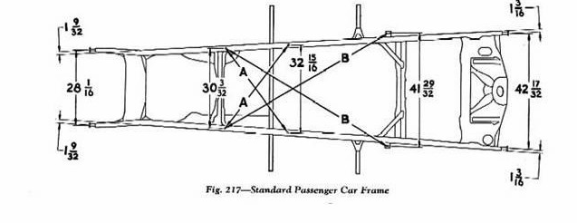

    Hello all. I'm looking for a reference measurement of the front bumper mounting bolt centers on the front frame rails of a 1935 standard. I'm upgrading the front suspension, which the PO has already been into and I want to make sure the frame rails go back where they were. Thanks in advance.

    34 & 35 Standards share the same measurements, just a different frame X-member

    28 and 1/16 it is. Thank you Sir.

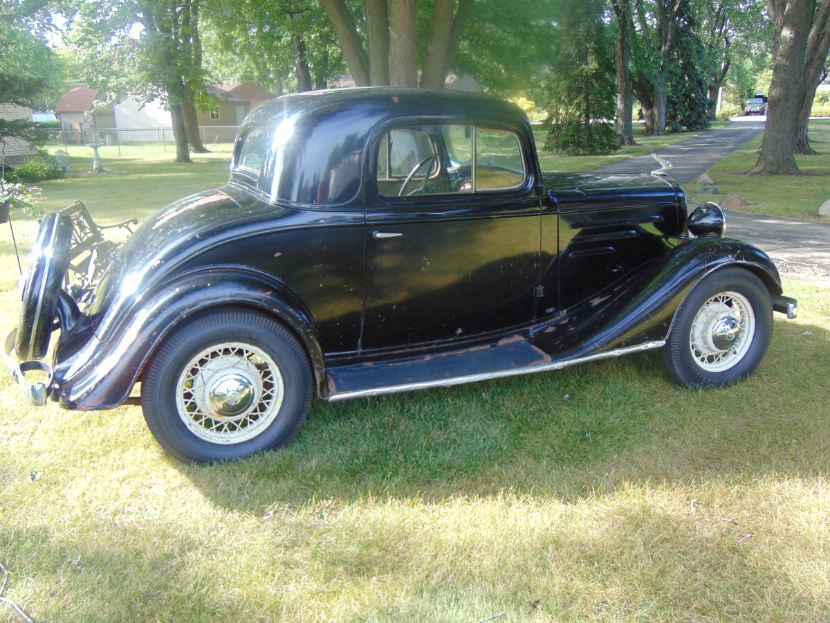

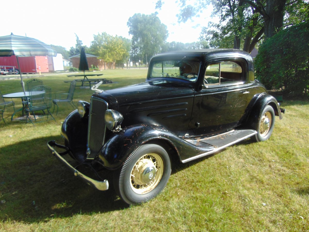

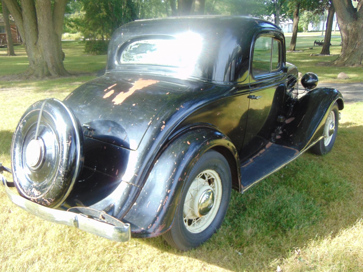

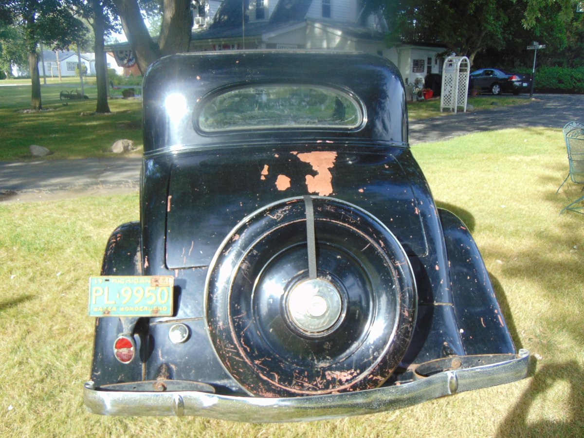

  20. paul55
    Joined: Dec 1, 2010
    Posts: 3,421
    paul55
    from michigan

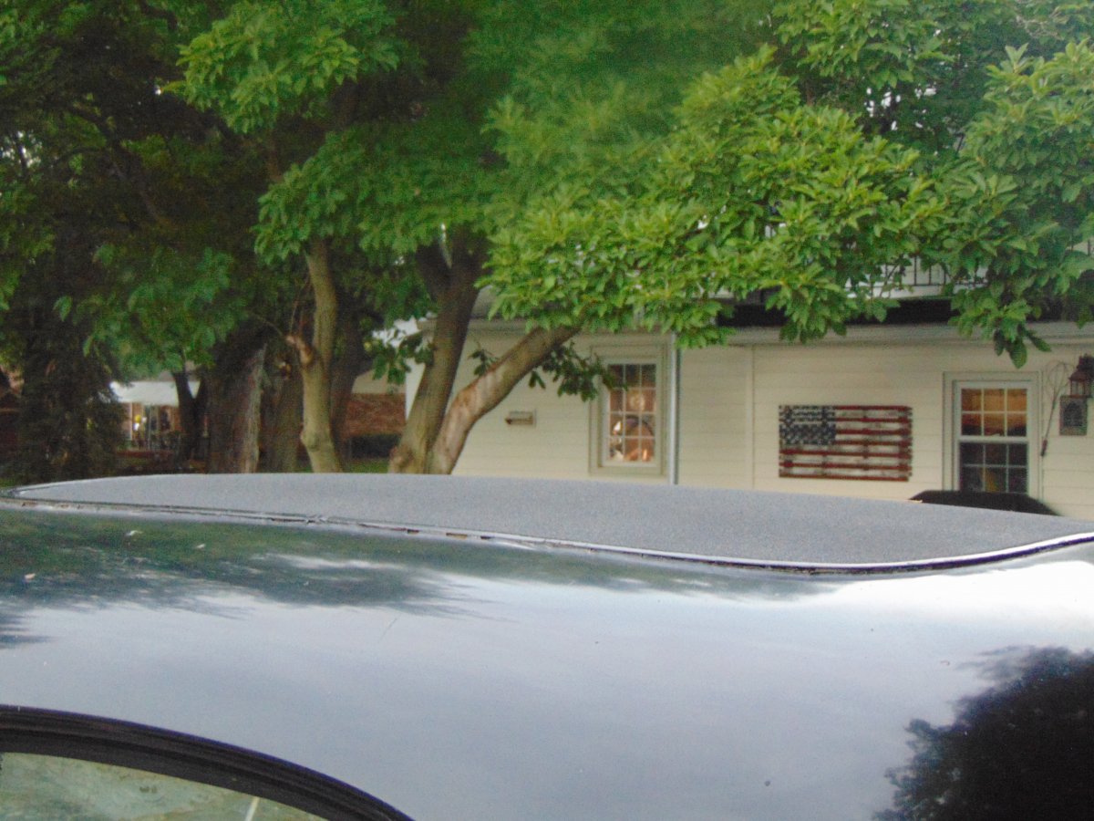

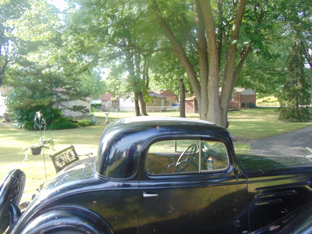

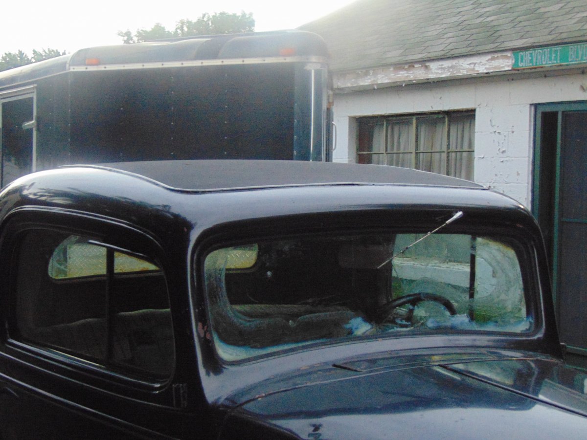

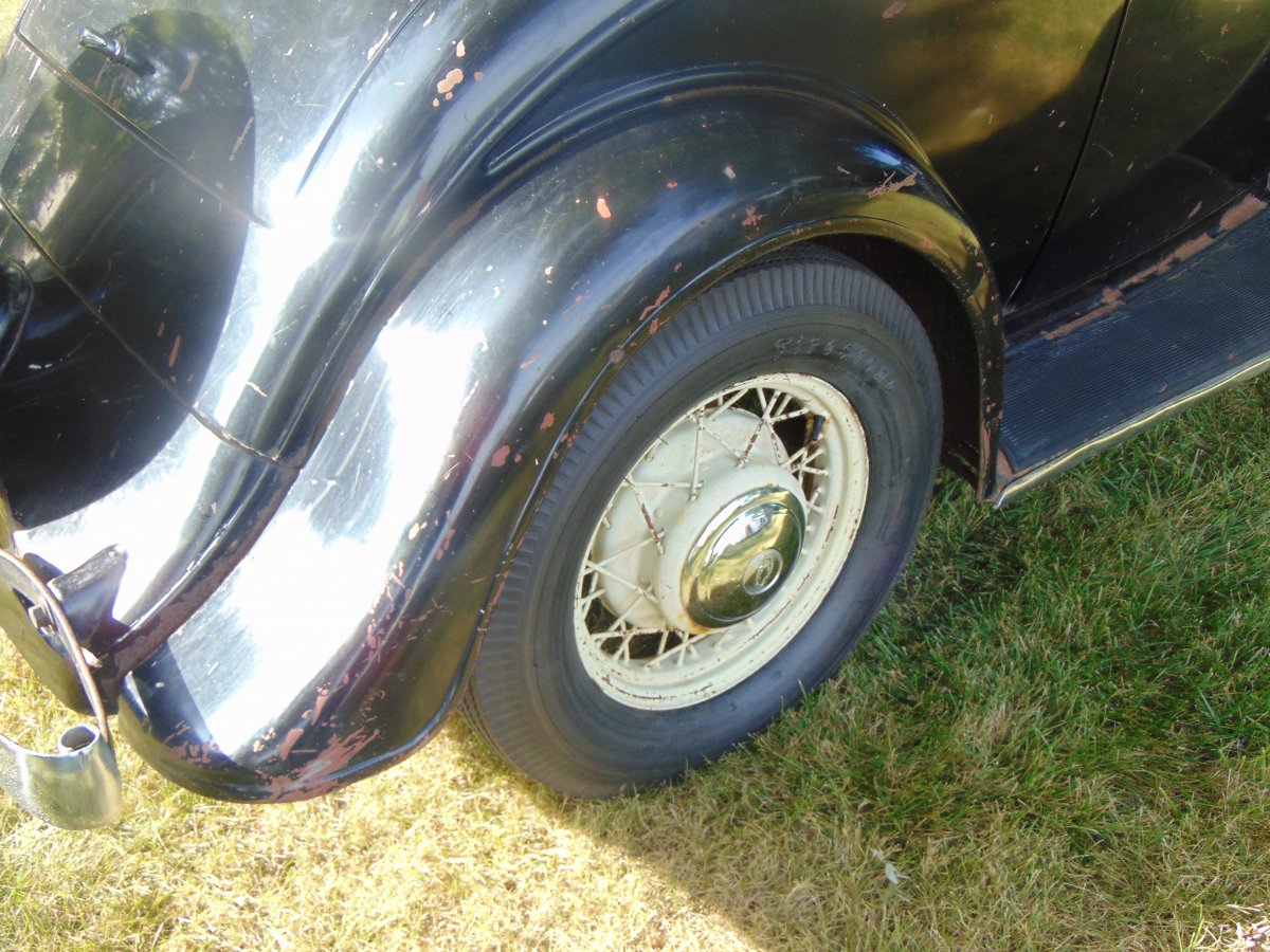

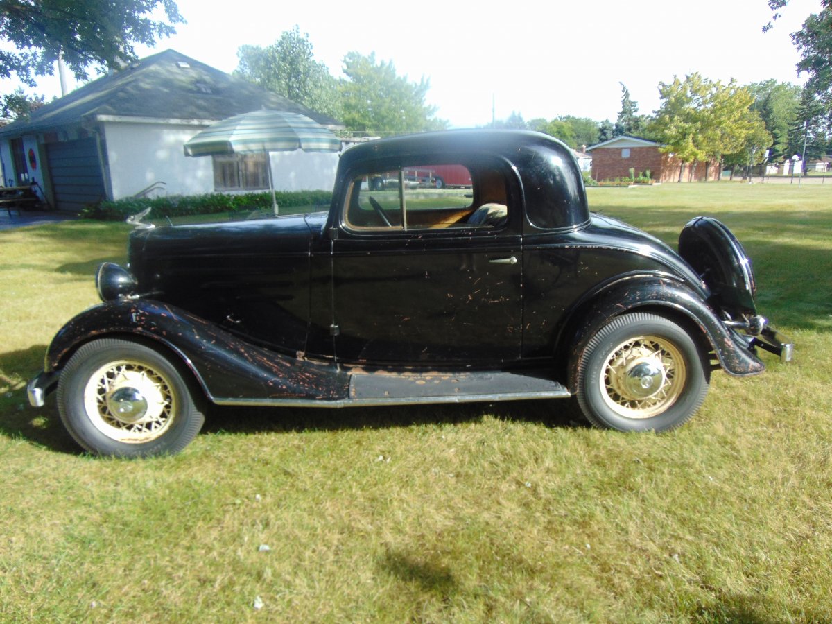

    Some updated pics of my barn/garage find. Runs and drives great! Put a top metal top in it and sprayed with bedliner to mimick the canvas. Used the rear 1/2 of a 2009 Impala roof...it dropped right in, no shrinking the edges or anything. Perfect compound curves to fit 33-35 Chevy coupe and others, I'm sure. DSC04973.JPG DSC04974.JPG DSC04977.JPG DSC04979.JPG DSC04980.JPG DSC04981.JPG DSC04982.JPG DSC04983.JPG DSC04985.JPG DSC04990.JPG DSC04991.JPG DSC04991.JPG DSC05000.JPG DSC05002.JPG DSC04961.JPG DSC04963.JPG DSC05002.JPG
  21. 66gmc
    Joined: Dec 4, 2005
    Posts: 580
    66gmc
    Wow that's a beautiful car, I'm jealous!
    Fern 54, biggeorge and Bowtie Coupe like this.
  22. paul55
    Joined: Dec 1, 2010
    Posts: 3,421
    paul55
    from michigan
    Thank you. Freed up the brakes and adjusted them, repaired the exhaust, rebuilt the fuel pump, new tires/tubes, some good used headlight lenses, adjusted the clutch, and reinstalled all the parts they had removed. Turned out to be a better car than I org. thought.

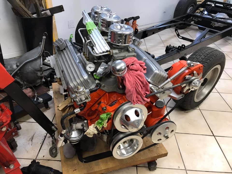

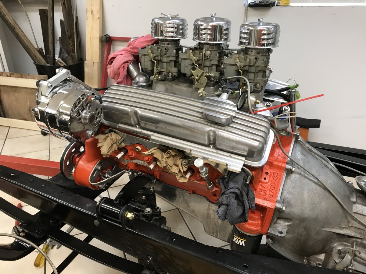

  23. jgrohio
    Joined: Aug 11, 2011
    Posts: 158
    jgrohio
    from NE Ohio
    Been a while since I posted but making slow progress on my chassis
    RoarsRods, Fern 54, TFoch and 5 others like this.

  26. AngleDrive
    Joined: Mar 9, 2006
    Posts: 957
    AngleDrive
    from Florida
    Cool motor mount
    Bowtie Coupe and jgrohio like this.

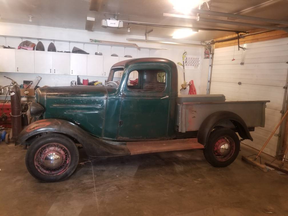

  28. 66gmc
    Joined: Dec 4, 2005
    Posts: 580
    66gmc

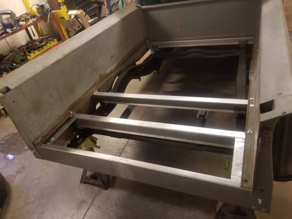

    Haven't made much progress on my 36. Had to reorganize the garage before winter so I threw the stock axles and junk springs under it to make it mobile. I was still in elementary school the last time this truck was rolling, and this is the first time in over 40 years the body has been bolted to a frame with doors that open and close properly. I did manage to get the box mounted last month, I was fortunate to get original boxsides in excellent condition, but will need to save up for a new tailgate as originals are impossible to find. 20191006_194656.jpeg 20191006_161608.jpeg 20190901_195443.jpeg
