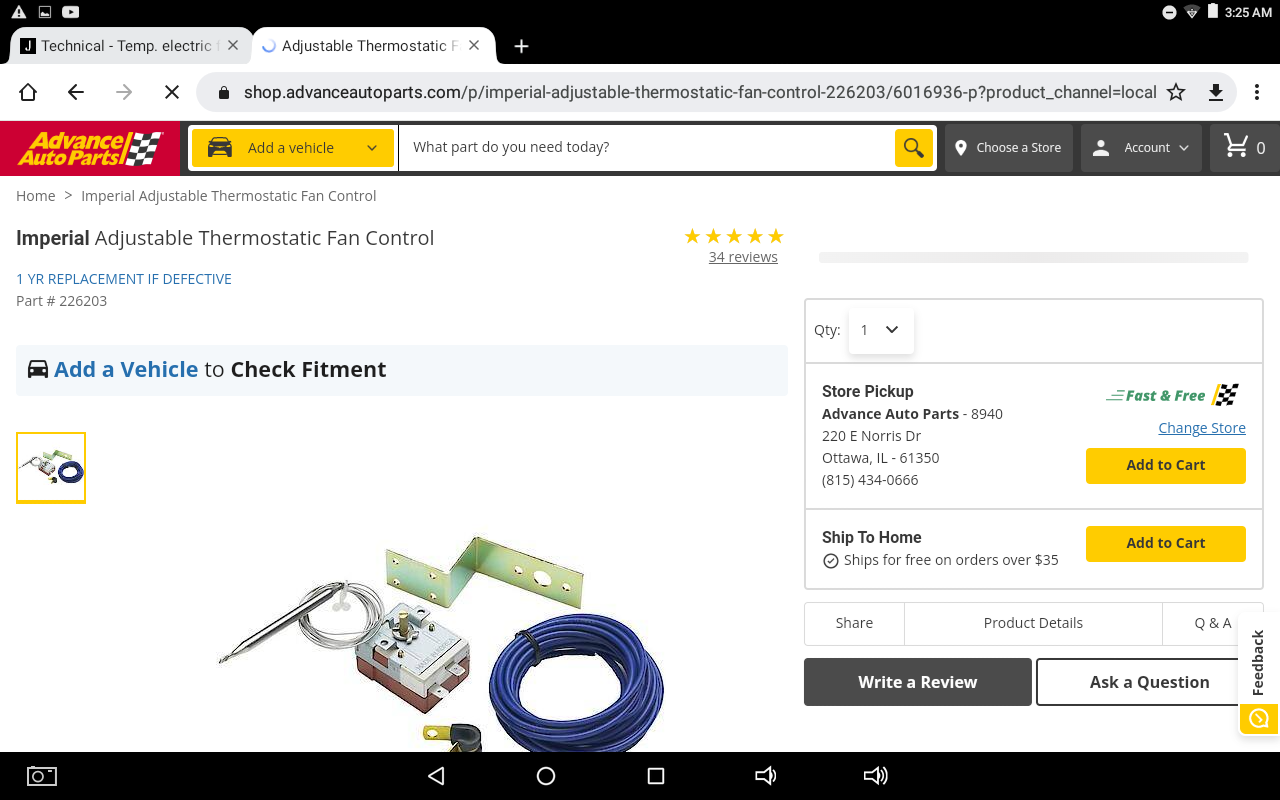

    Screenshot_2022-03-04-03-25-12.png I have one of these , 22 years , 40a relay , 30a fuse , 16" fan . A 30a relay won't last long , nor will a 20a fuse . The control won't last long without a relay carrying the load .

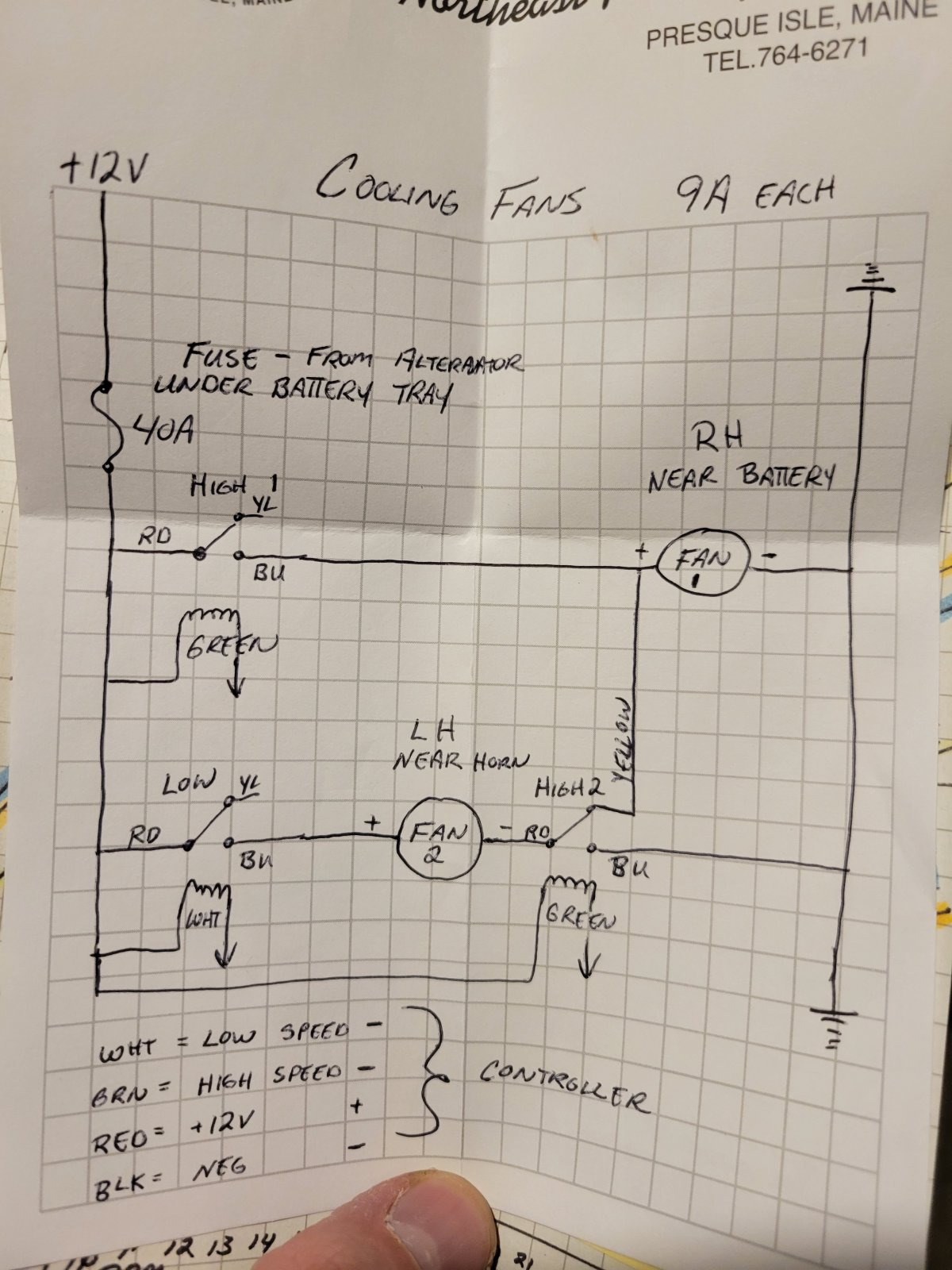

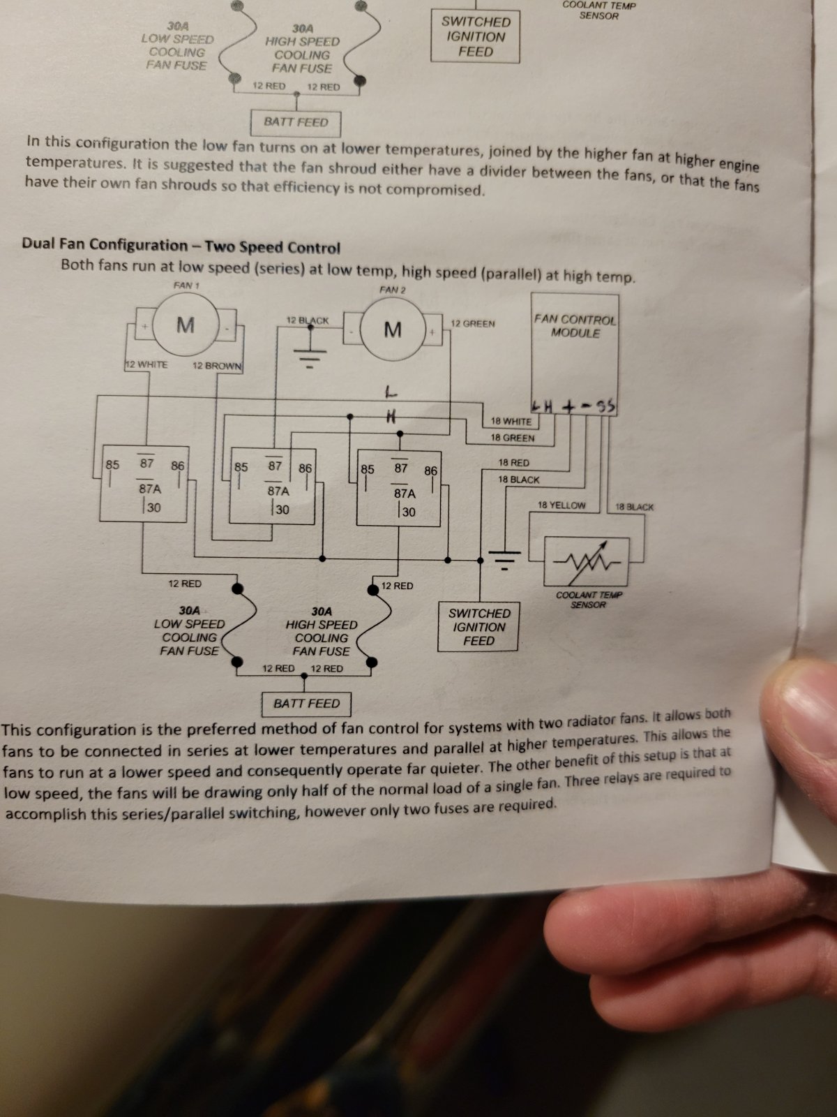

    I have two Spal 12" fans wired in 2 stages. Low stage connects them in series (6 volts each), high connects them in parallel (12volts each).
    I know you said you have 1 fan, but if you find the need for 2 this works flawlessly. Very quiet on low speed.

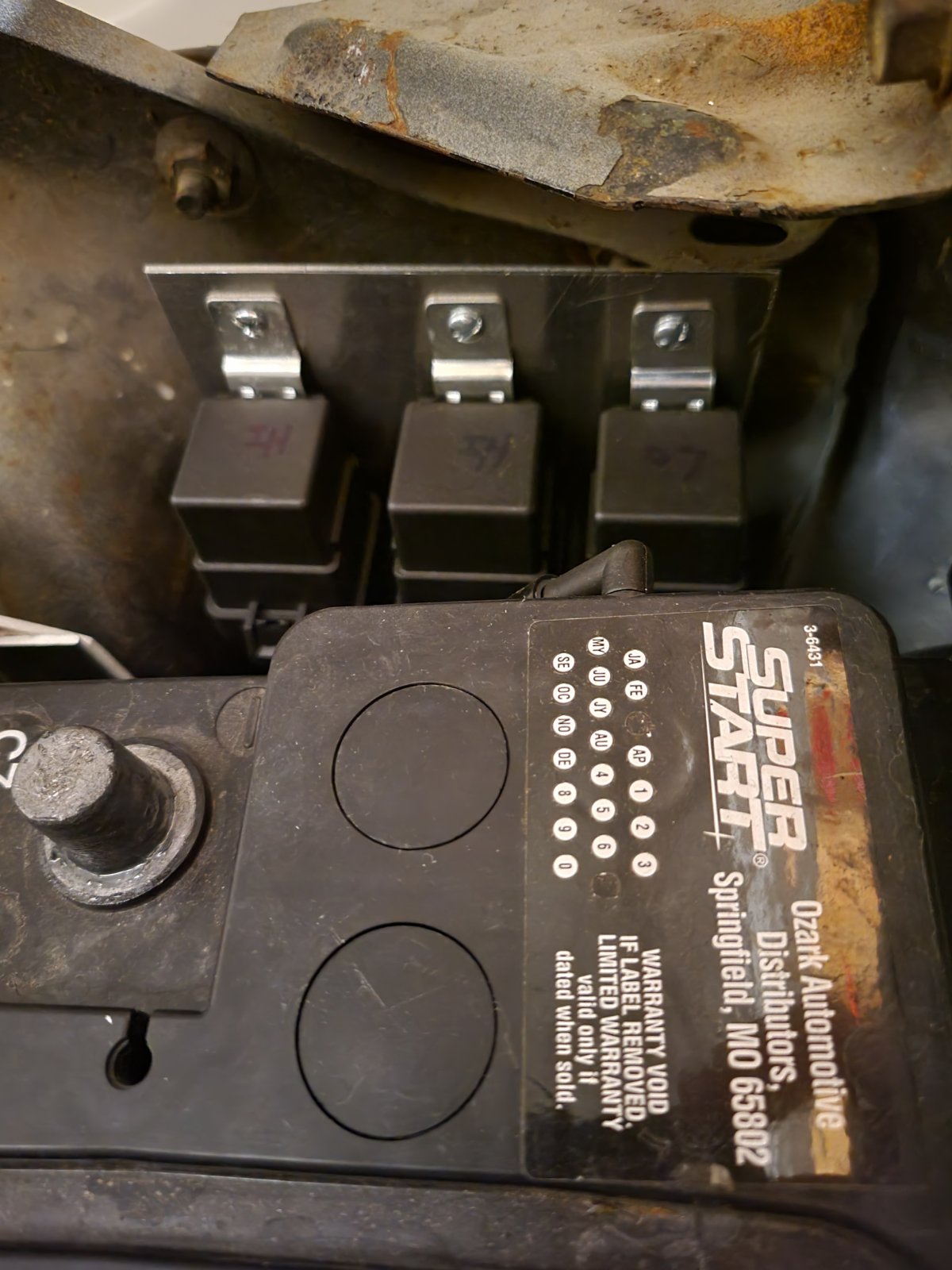

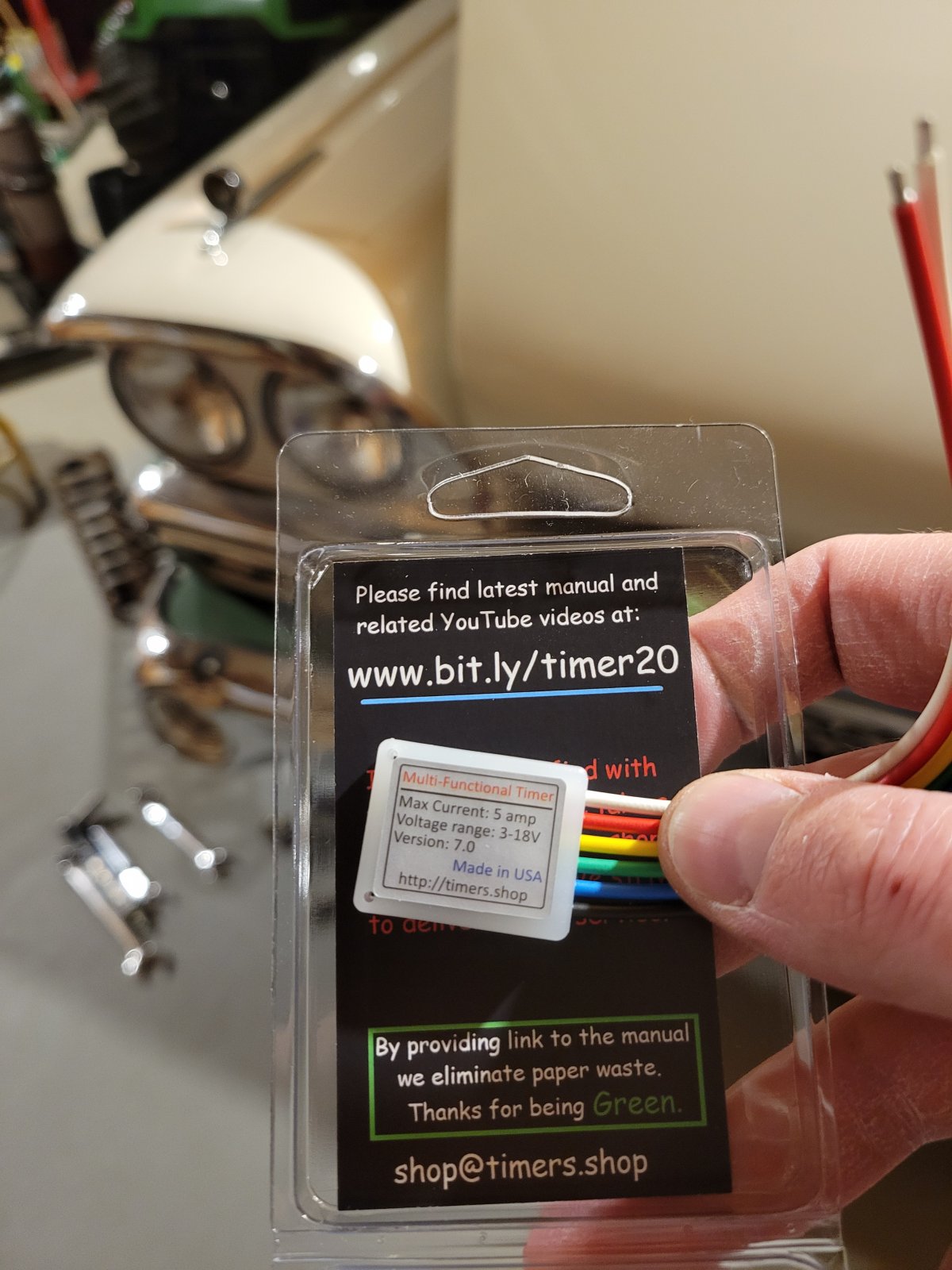

    I put in a universal 12v timer to keep the fans on at low speed for 4 min when the engine is shut off. Really helps with underhood temps with the FE stuffed in there.
    This is my drawing so I could understand it.
    This is out of the book that came with my controller.

    These universal timers work well for anything automotive, off delay, on delay, flasher, wiper delay, whatever.
