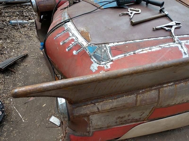

  12. manyolcars
    Joined: Mar 30, 2001
    Posts: 9,524
    manyolcars
    How did you form the fins?
    Thor1 and loudbang like this.

  14. manyolcars
    Posts: 9,524
    manyolcars
    Has anyone else formed fins like that? How did you do it?
  15. Kustom7777
    Posts: 5,188
    Kustom7777
    from Austin, TX
    I made them from 1/2 inch tubing...drew the shape I wanted on the ground, and then used a hand pipe bender to duplicate the shape...then used 18 ga. sheetmetal to skin them.

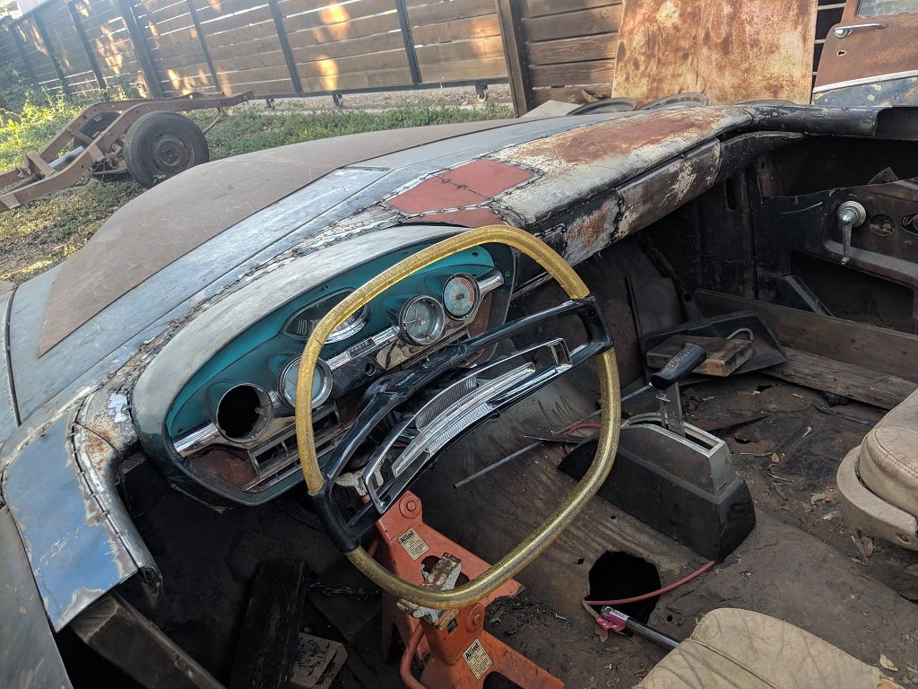

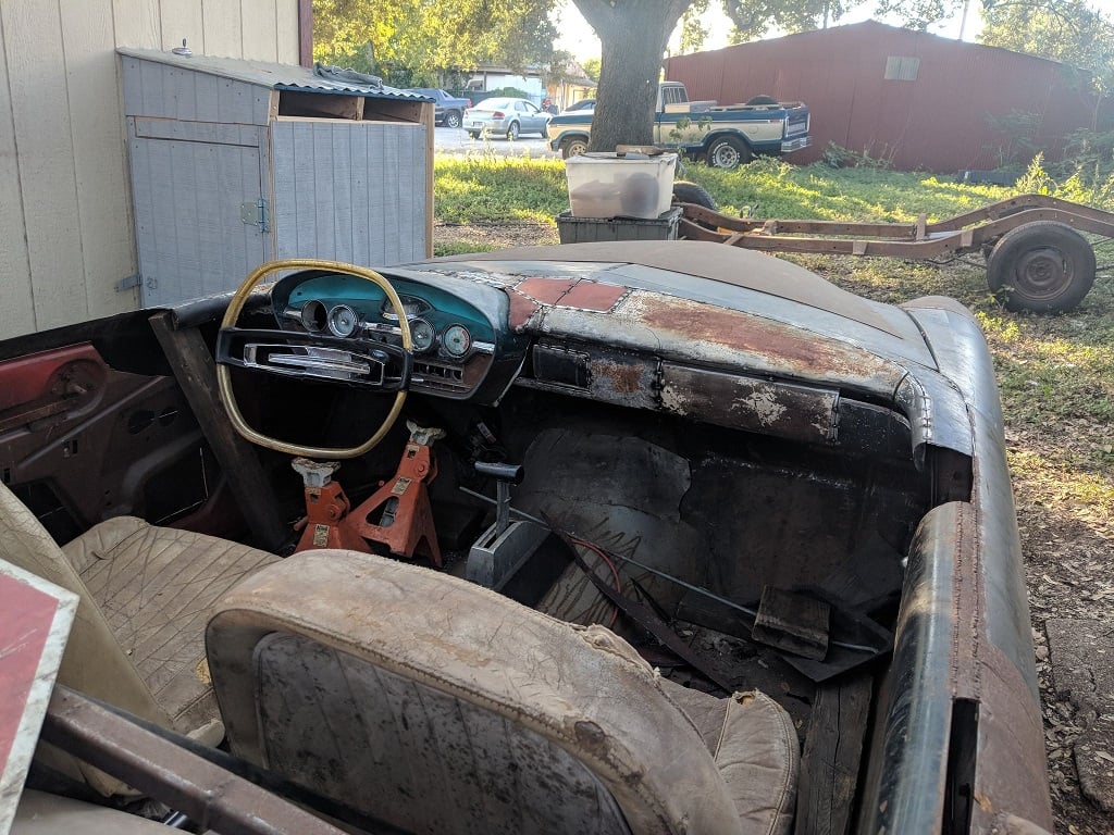

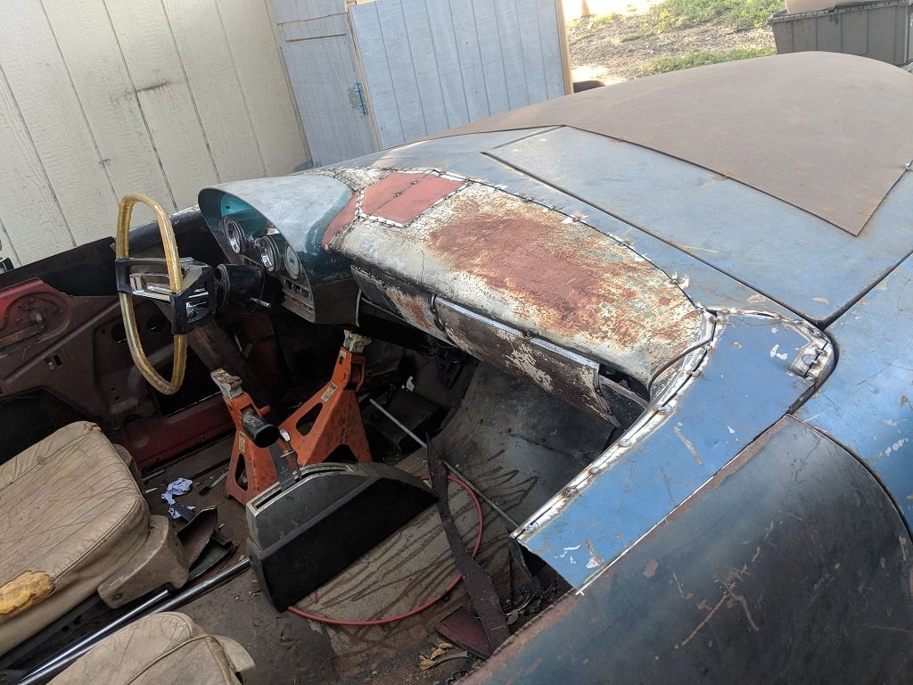

  16. Kustom7777
    Posts: 5,188
    Kustom7777
    from Austin, TX

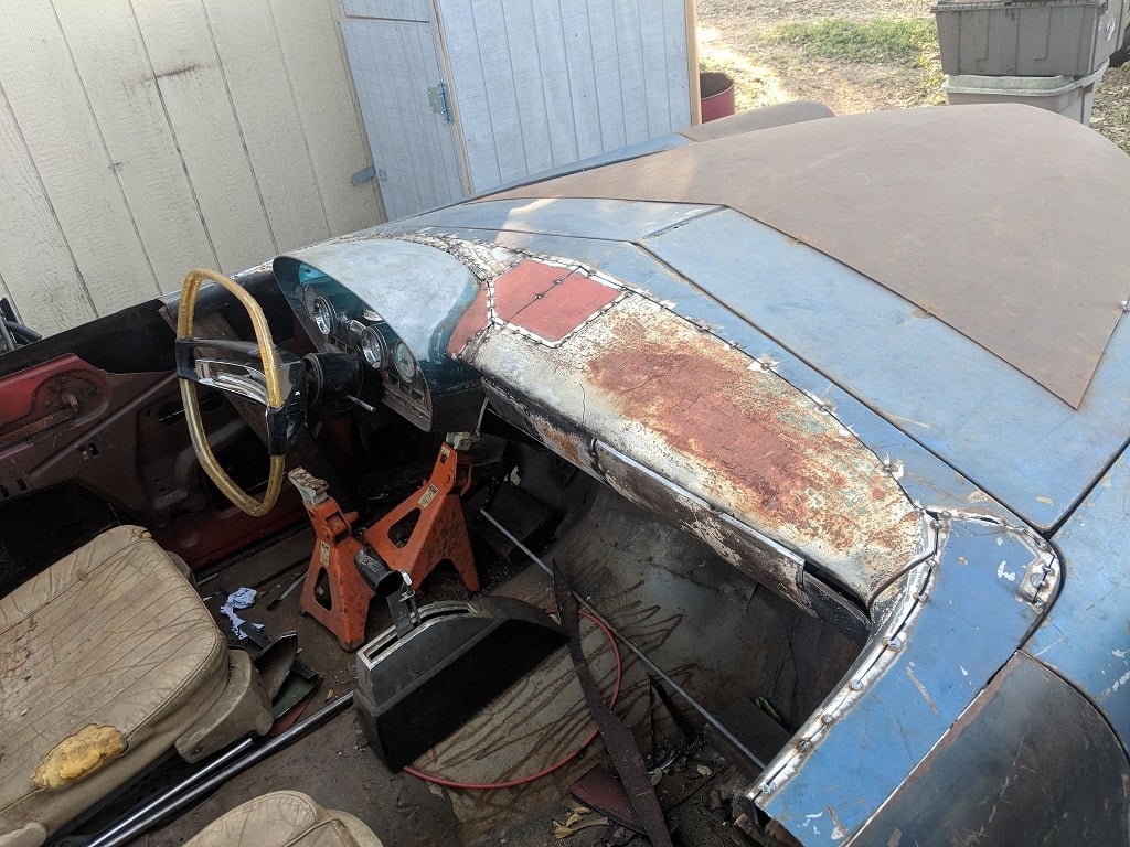

    More progress......Began putting in the dash. I used a 56 Ford dash, but sectioned it a couple inches because it was too tall...actually bolted up directly to the shoebox dash mounting points, which was a pleasant surprise. Started mating the 58 Edsel instrument cluster to the Ford dash...steering wheel is 61 Plymouth. Just tacked at this point.

  19. manyolcars
    Posts: 9,524
    manyolcars
    Are you saying that you welded two long (kind of flat) panels, one on each side of the tubing?

  22. evintho
    Joined: May 28, 2007
    Posts: 2,531
    evintho
    That is, without a doubt, the proper steering wheel for that car!!
