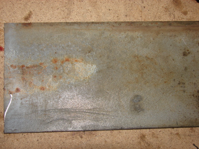

    I'm working on boxing the frame rails of my current scratch-built project and am using some 10 ga that came from my grandfather. He's been gone a while and I can't tell if the steel is oxydizing stainless or galvanized. Years ago he said it was stainless and used some of the sheet when he grafted a camaro stub onto his '52 Chev pickup but I would like to be sure before I start welding in my pieces (since welding galvanized is toxic!)
    Here's a pic of a leftover piece to show what it looks like now. Any thoughts?

    Most grades of stainless are not magnetic. Quick and easy way to be fairly sure.
  3. If you try to weld it, you will know fairly quickly if it is galv or not.

    All SST steel is slightly magnetic while 400 series SST is very magnetic and will lightly rust similar to the material in your picture due to the higher iron content. You can weld SST to carbon steel but I think I'd buy new material. If it's galvanized steel it will out gas and get a white powdery residue when welded, bad stuff for you health.

    Weld on a piece of it or heat it with a torch. Will be able to know quickly. The galvanized coating will burn off and leave white stuff behind. It is the vapors, smoke, from it burning that is toxic.

    If you have some muriatic/Hydrochloric acid around you can apply some of it on to the metal. Galvanized will fizz up almost immediatly. This also removes the layer as well leaving you with raw steel.
    This is of course if a magnet doesn't clue you in as to whether its stainless or not.

    By looking at it, it sure looks galvanized to me... Probably more likely to have left over galvanized than stainless too, cost considered.

    Well I hit the piece with a magnet and it has strong magnetism... I hit it with a piece of sand paper next and a fine, dark gray powder sheeted off of it, so it appears to be galv. :mad:
    Is it safe to use a flap wheel to remove the coating or would the disk act in similar fashion to a welder and burn off the toxic coating? Does muriatic acid or hydrochloric acid take the coating off completely?
    I'm contemplating getting a sandblasting hood and media and taking care of it that way if neither of the above methods would work completely. I already have the pieces cut and fitted well so I'd really rather not "buy new" and start all over again. Rather fix what I have (isn't that what true hot rodding is about anyway?)

    It is almost impossible to remove the zinc from sheet metal. It creates a toxic gas when welded, a contaminated bead, and paint doesn't stick well to a galvanized surface. A small savings now will come back to haunt you in several areas. The price of a bit of steel and the additional time spent to do the job right the first time will be well respected later in the project. Cheep or used steel is not always the most economical use of time or material. Ask me how I know. The first three rules of welding are clean, clean, clean. It is impossible to adequately clean galvanized steel in the average home or hobby shop.
