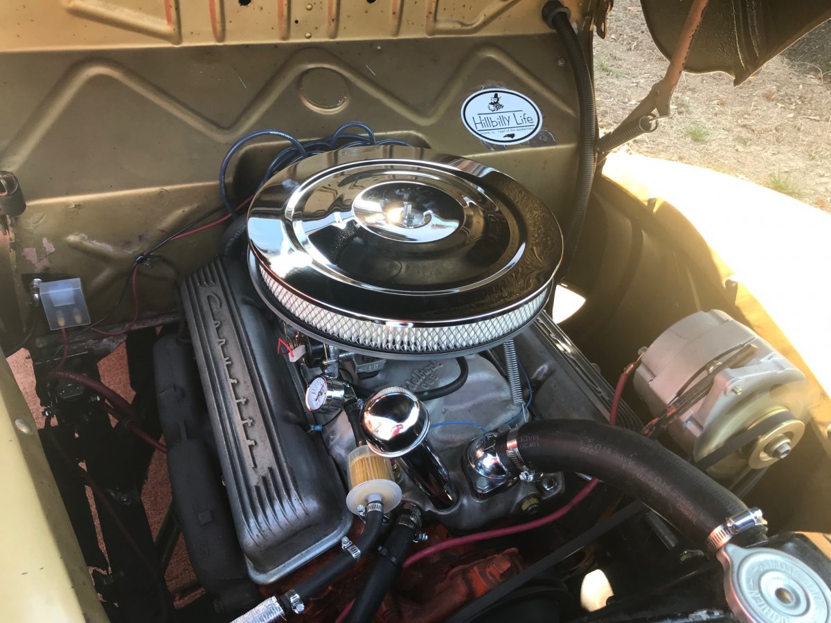

    Bought new C3BX in 1972 for 1969 DZ 302 engine in my 1955 Chevy Hard Top. 750 Holley DP./LT-1 Cam/12:1 Comp./12 Bolt Posi-5:13 Gear./Muncie 4-Spd.Close Ratio Trans.......Damn that Car was quick( to me anyway)

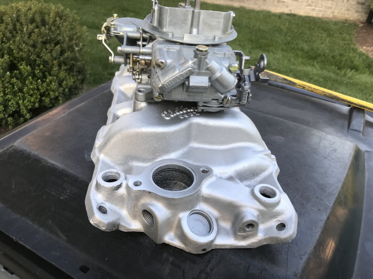

  11. MIKE STEWART
    Joined: Aug 23, 2016
    Posts: 273
    MIKE STEWART

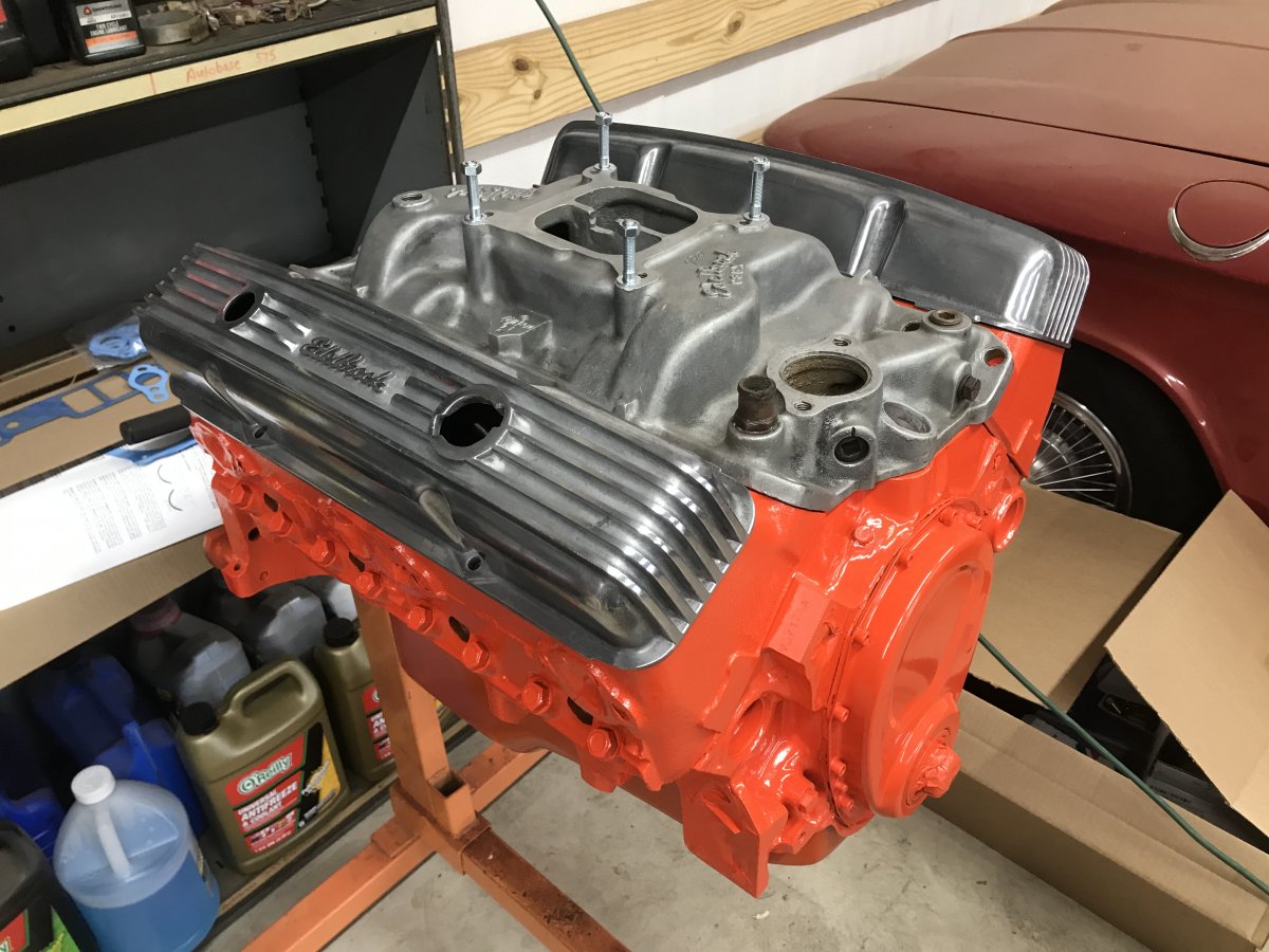

    Installed mine - with 600 CFM Edelbrock Carb. Much better than stock 4-Jet carb and iron intake. Want to keep period look. 327 39GOLD2.jpg 327 39GOLD1.jpg

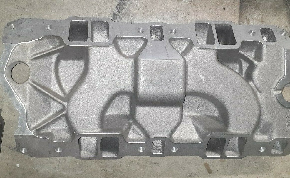

  12. I have a C4B and C3B that look identical. The C4B has dual carburetor bolt pattern and only one bolt hole for the coil. The C3B has no coil provision. I prefer the waterjacket outlets these manifolds share, but the oil fill tube/thermostat housing angle leave much to be desired. The photo is in low light, but I welded a wiggle in my oil fill tube to clear the upper radiator hose.
    1Nimrod, loudbang and guthriesmith like this.

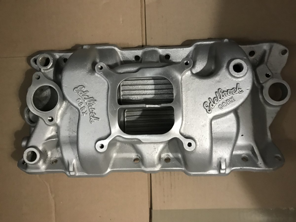

  13. RIVERBOATMAN
    Joined: May 18, 2020
    Posts: 5
    RIVERBOATMAN
    I am also going for the nostalgia look. My filler tube leans toward the drivers side and has the platform for the divorced choke spring and housing. I haven't found the choke mechanism yet but I'm looking. Any body know where I should be looking for that bugger? I'm going to build a 350 engine with Trick Flow DHC-175 double hump heads for that look.

    Mike, that look of a setup like yours really has me wanting to stay single 4bbl with an earlier Vette air cleaner over dual quads. I know it sounds crazy to go single over 2x but I dig the simplicity (and they run well, too!).

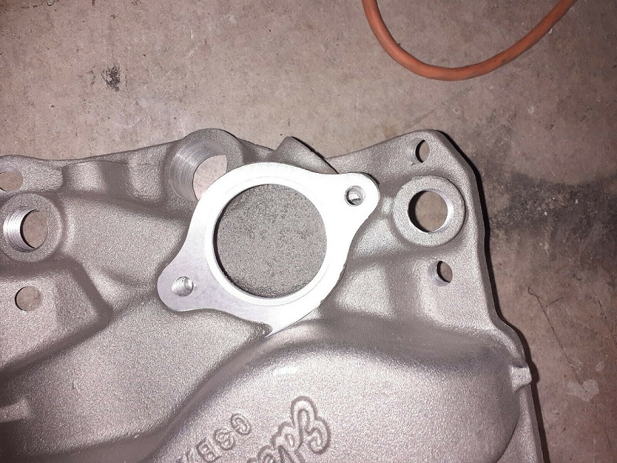

  19. RIVERBOATMAN
    Posts: 5
    RIVERBOATMAN
    Eric, the first link took me to some cooling system sealer. Can you re-post that link?
    I took a look at the speedway intake 9103782462. The info was a good read. Seems that to use these heads
    I have to use roller rocker arms, no choice. Since I'm only building a driver engine, I wanted to stay away from
    the rollers in favor of the original stamped rockers. The Trick Flow DHC-175 TFS-30210002 heads don't have the obvious raised area for the roller rockers to clear the original valve covers and also I'm not sure the TF heads are compatible with stamped rockers either. I'm going to need a serious talk with someone at TF to see if these heads are going to work for me.
    I've been all over the internet looking for Specs for this C3BX but so far have come up empty. Does anyone have any info such as what the port flow is and size of the ports? Any info will be greatly appreciated. Here are some other photos of the C3BX intake.

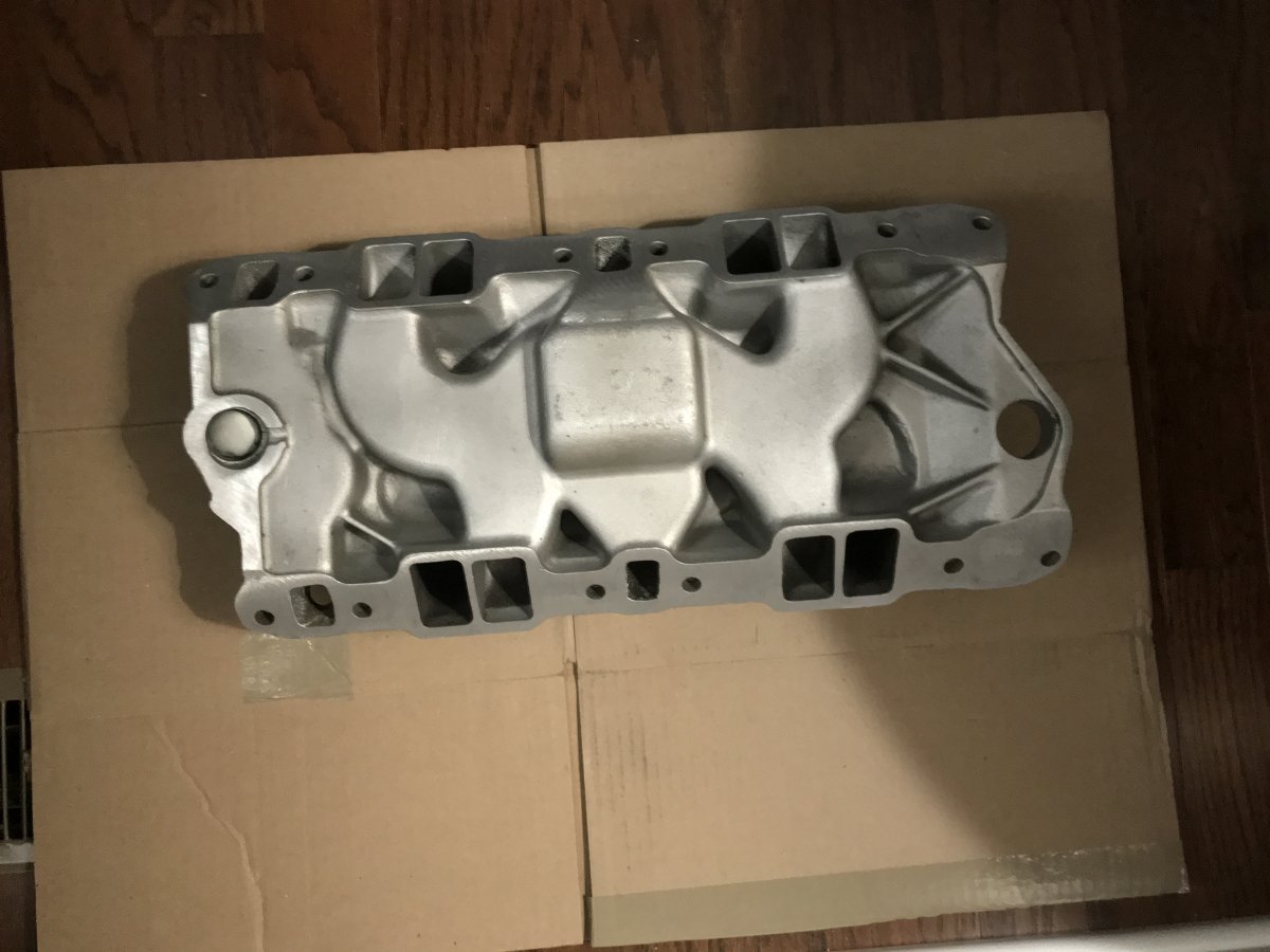

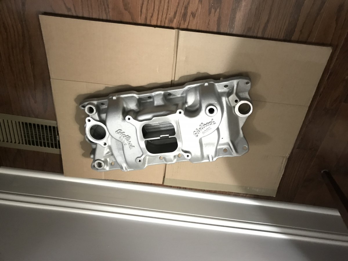

  29. That is WAY nicer than the C3BX I bought recently for my kids project. I found this one on Craigslist and got it for a decent price, but it has had some "customizing" done at least as far as someone scratching some numbers that appear to be a date and a "400" in it. I guess it gives it some character...
    1Nimrod and OLSKOOL57 like this.
  30. OLSKOOL57
    Joined: Feb 14, 2019
    Posts: 477
    OLSKOOL57
    It does have character! Nice manifold. Enjoy!
