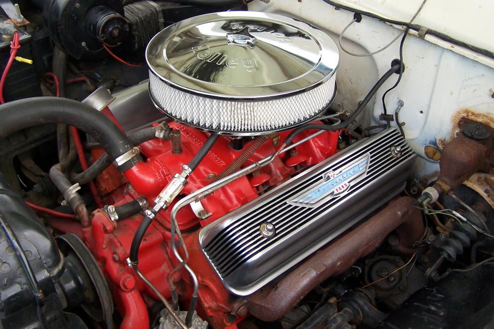

  10. Actually the Y-blocks are oretty tough for the most part. They need clean oil and filter often. If the oiling system fails on the top end there is a gizzmo called an overhead oiler. See pic, it installs at the rear of the shaft rockers,flat part of copper tube runs under valve cover gasket,a union connacts the 2 sides together and a T fitting will tie into the oil# sending unit. The other good thing about the oil pump on the Y-blocks is the pump mounts externally. This means you can take it off and juice it for more pressure with ease>>>>.
