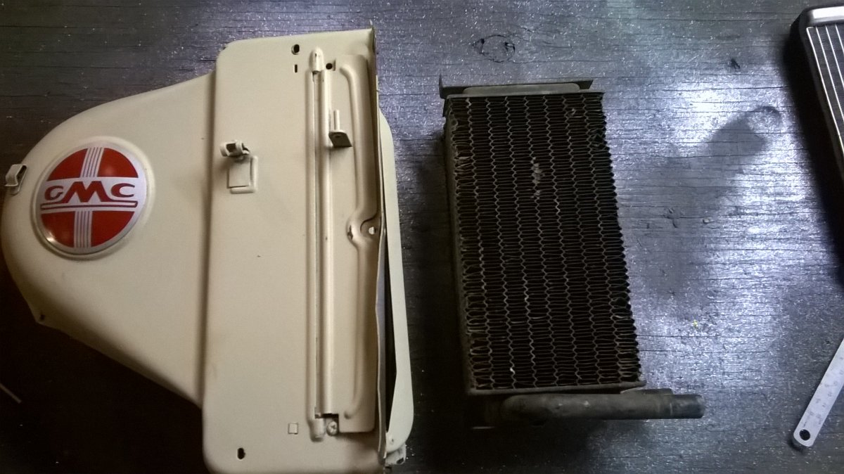

    A common problem with the fresh air heater on these old AD trucks is the heater core. They are almost always jacked and from what I've found, difficult to repair. The replacement is available through Classic Chevy Parts aka Chevy Duty but they want a hefty $170 for it. This is too expensive for my blood so I started looking for an alternate (cheaper) one available through the local parts store.
    I searched and searched through dimensions and ended up finding an aluminum one that is a little wider and thinner than the original. It was something that I could work with. Part number 398325 is the replacement and is a little cheaper at only $70.
    Here is the heater and original heater core.

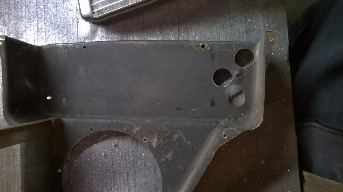

    Now the slight modification to the back of the box. There was originally two holes in the back that the original heater core stuck out. You need to drill a new exit hole ( the left one of the cluster of 3) and enlarge the top hole so that a 5/8 heater hose will fit through it.

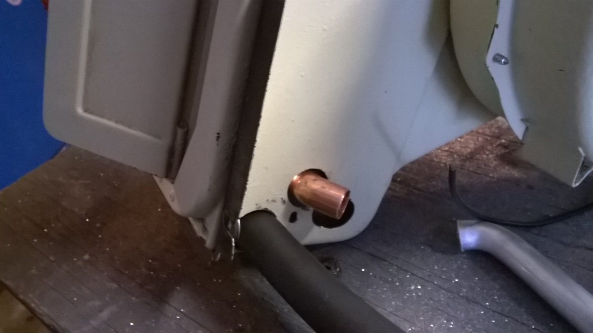

    And here it is all back together with the hose attached to the furthest port and running out of the box. Fits great and didn't take much modification to the box.
    Pic from the back where you can see the other 90 sticking out.
