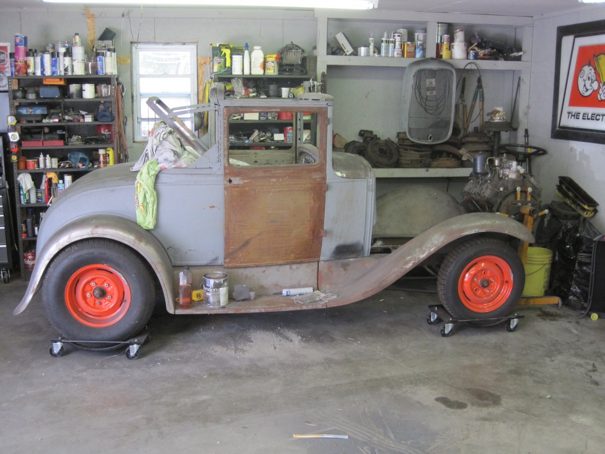

    I’m in the process of stepping the rear of my model a frame and I’m wondering if I should lay rear crossmember back around 2 degrees.
    My plan is to relief cut the frame just behind the front crossmember to increase castor to around 7.5 degree to account for rubber rake (5.5-16 front and 6.5-16 rear).
    I’m concerned about rear spring bind if I don’t.
    Thanks in advance.[​IMG]
