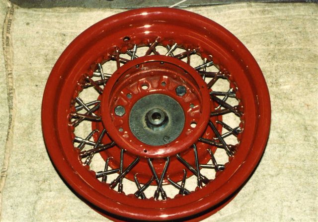

    I don't know how much of a call there is for truing up wires on the Hamb but years ago I tried to get Dayton to lace up and true some wires and they put me on a waiting list for months. Decided to build my own stand. The stand was made from some scrap c-channel and a couple of braces. The most important part of the stand was centering the axle and hub so that it ran pretty true. If you look at the laced wheel you will see a plate with a bushing. I first cut the holes for the lugs in the plate and then scribed the center of the hub with north south and east west marks which found me dead center and then made sure my bushing was welded dead center. Then the axle was placed in the jig and was leveled with the bushings yet to be welded and I did not weld the bushings until the axle was level and true. When that is dead nuts then I moved on to the top portion which is some strapping with nuts welded in place and the bolts act as truing points. On the ends of the bolts I put rubber firewall grommets so they would not scratch the painted wheels. I did not have a clue on how to true a wire wheel but waiting was out of the question. After playing with the adjustment on the first wheel it is not rocket science and surprisingly it did not take me long to true six wheels. I also trued a couple other sets on this jig and it is more the jig than my talent.
    If you have never laced a wheel pay attention to how the spokes naturally lay in relation to the wheel and I placed the hub in the correct plane to the outer wheel (rim) and installed all of the spokes an equal amount a little at a time until the hub did not move in relation to the rim. Then when it runs in the jig or stand, back off the truing points so they do not rub and as you true the wheel you can keep moving the points in until you have the wheel true. The wheel will have high and low spots and as you play with it you will see that a high spot generally responds well if you pull the rim in by adjustment. Sometimes you have to play with the spokes 180 degrees opposite but I found that to be rare. To pull it to the right or left look at the spokes themselves and playing with it will show you what is going on right away. By having the adjusting points like this it will show you that if you make an adjustment you can roll it back immediately and see if you went the wrong way or not. I trued a set of larger diameter wheels and they were even more sensitive but still easy to figure out. The only bad part is that I sold the stand to a guy that had to have it and now I will have to build another for a future project. By the way, newer spokes work well- I trued a rusted up set of spokes one time and almost lost my religion._Jim

    Hey Jim, What is the wheel in your pictures? It looks like a '35 Ford style. I'm a littlle new to this and thought the early Fords like the '35's were welded spokes and therefore not replaceable.

    Dugg, they are thirties Packard wheels for the senior cars. I am on the hunt for 24s for a racecar-Rudge Whitworth so if I run across some centers and rims I will let you know.-Jim
