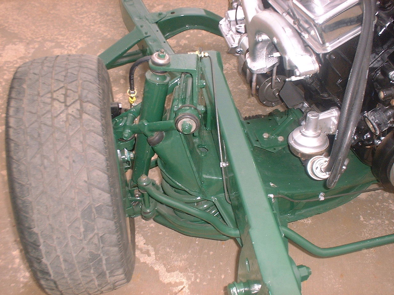

    On our '51 ford, we made an upper shock mount out of 1/4" angle iron with a gusset underneath. It's worked well for @ 8 years. Here's a pic:

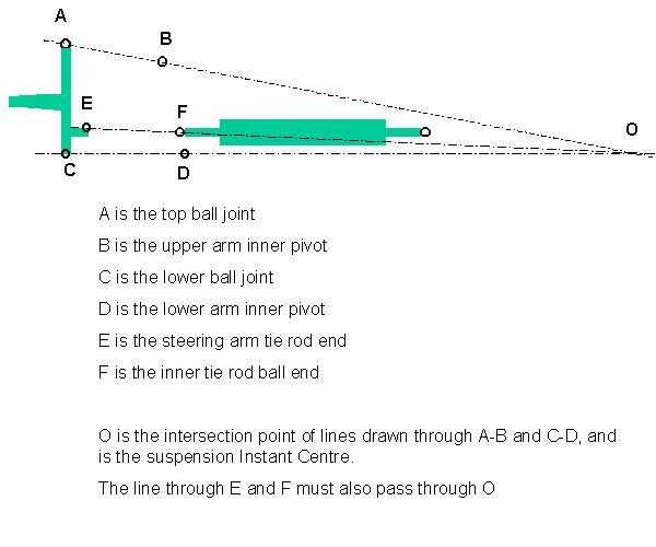

    Tim, what's the width of the cavalier racks? What year? Does it share the tie rod thread with the jag (5/8" x 18 if I remember right at the moment)?
    I've narrowed a jag front end for my '34 chevy 4" (and ackerman seems good!) and although I think I could rig up the original with shortened tie rod arms, the mounting flanges will require significant modification. Interested in what else others have come across.

  16. If you shorten the tie rod arms you will be throwing out ALL the required geometry and introducing "bump steer" .

    I agree. It's been eating at the back of my mind. I'm thinking about finding another rack with the same tie rod arm dimension but a narrower center section. Just by shortening the tie rod arms, it throws off the arc of travel - hence bumpsteer.
    Perhaps the saving grace is from the experience we've had with our '51 Ford - and as mentioned above - this set up is STIFF. Under the front of my '34 Chevy, I expect very little movement - perhaps little enough that bump steer wouldn't be horrible. However, if it's something I can sort out and find an appropriate donor now, I'd rather fab it up once.
  28. I should have been a wee bit more specific possibly . You need to draw an imaginary line from the inner pivot on the bottom arm to the inner pivot on the top arm, the pivot point (where the tie rod arm/rack end attaches to the rack) should always be on this imaginary line - hope thats easy enough to follow?
    If you do what you mentioned you won't only have bump steer but you will effectivly have front wheels turning in toward each and then out away from each other as you go over bumps ! - won't be very nice/safe I'm sure .
    hope that helps .
  29. flamed34
    Joined: Dec 30, 2009
    Posts: 733
    flamed34
    I had found this diagram - explains it perfectly. Thanks
