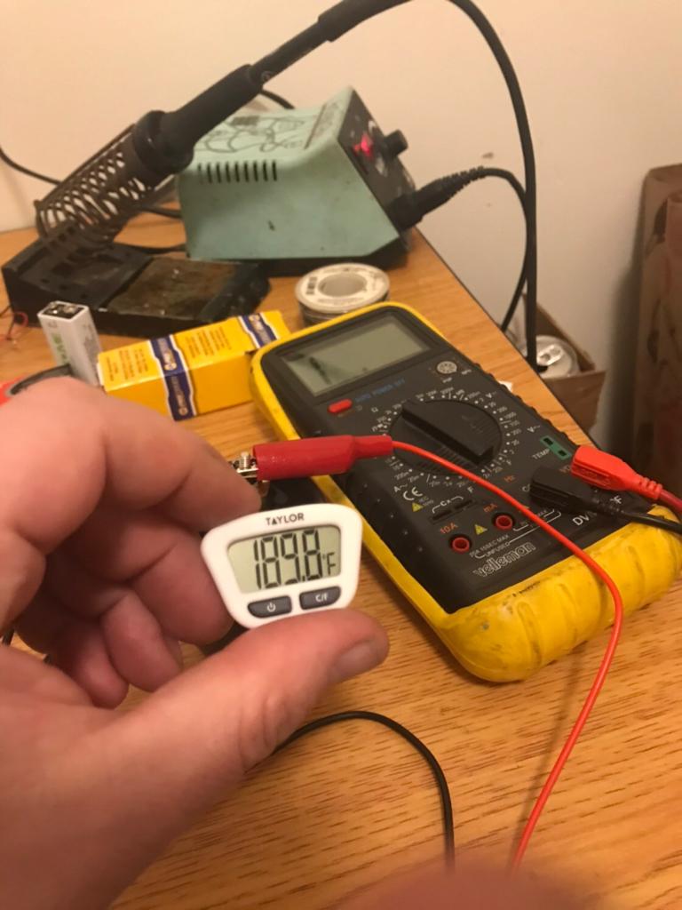

  26. rocknroad
    Joined: Nov 29, 2010
    Posts: 33
    rocknroad
    1. SoCal HAMBers
    So here is my version so far for my 1954 Plymouth. I grabbed a dash from an early eighties Ford truck with a 302 V8 and oil and temp sending units from a uPick a Part a while back.
    Built a little testing circuit using a pot and 9v battery. I saw some electrical arcing and melt-edge on the ford donor so wanted to test them and make sure they work.
    These gauges already have a patina on them so they don’t seem out of place.
    Gotta build some stand off brackets and such for the back. The gauges are being held in place by hot glue currently to get them placed right and so I could test them.
    I have high hopes for this in the rewire. Got nothing but time right now.

  29. rocknroad
    Posts: 33
    rocknroad
    1. SoCal HAMBers
    So I found a 2 amp dc power supply and soldered it to the new IVR because I wanted to at least test the temp gauge cause the original donor sending unit cracked in half while in storage. So I got a new one for an 80 ford pinto for $12.
    But I wanted to test it so made a little jig and put the kettle on. Using an insta read thermometer I got good results that I trust.
    That’s seems about right for 190 on the gauge. Had to dump boiling water in it twice cause the sending unit brought the temp of the water down before I could see what it was reading.
    Now my next test was to check normal operating temp of about 160
    Looks good to me!
