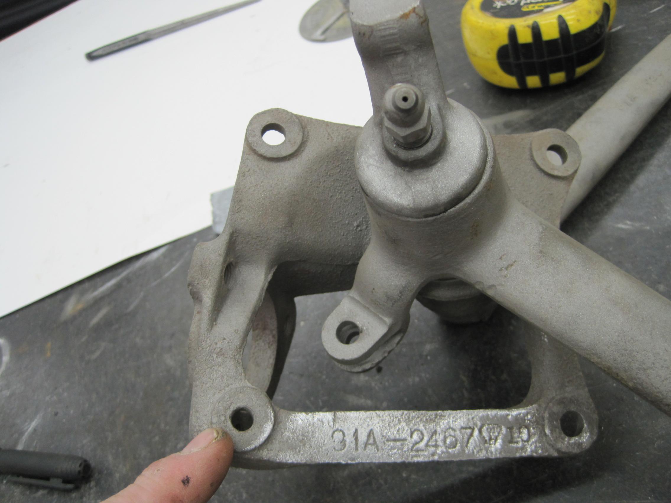

    Step 1: Find and buy a decent set of 1939 Ford Pedal and sandblast accordingly. 1939 Ford pedals have been the standard for hotrodders for years. They give you the right setup for clutch and brake. Puts everything in proper order and makes it easier to get three pedals in a true hotrod. 1939 Ford pedals have a part number that starts with 91A. I added a picture of the 1934 Ford pedal assembly for comparison. You can see we have a big difference in shape from 1934 to 1939.

  2. Step 2: I lined up both pedal assemblies on the bench and came to the conclusion that the difference in angle for the mounting surface that attaches to the x-member was 15 degrees. I have added a picture to show the difference.

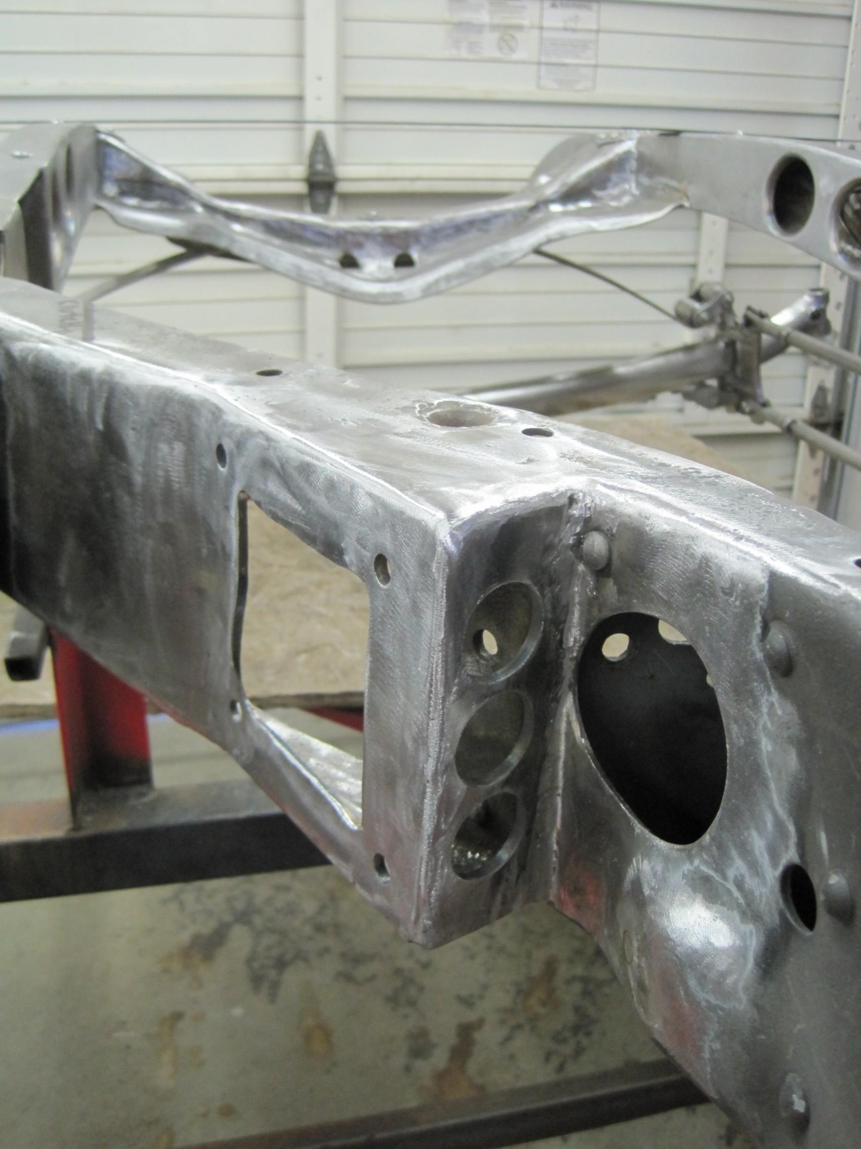

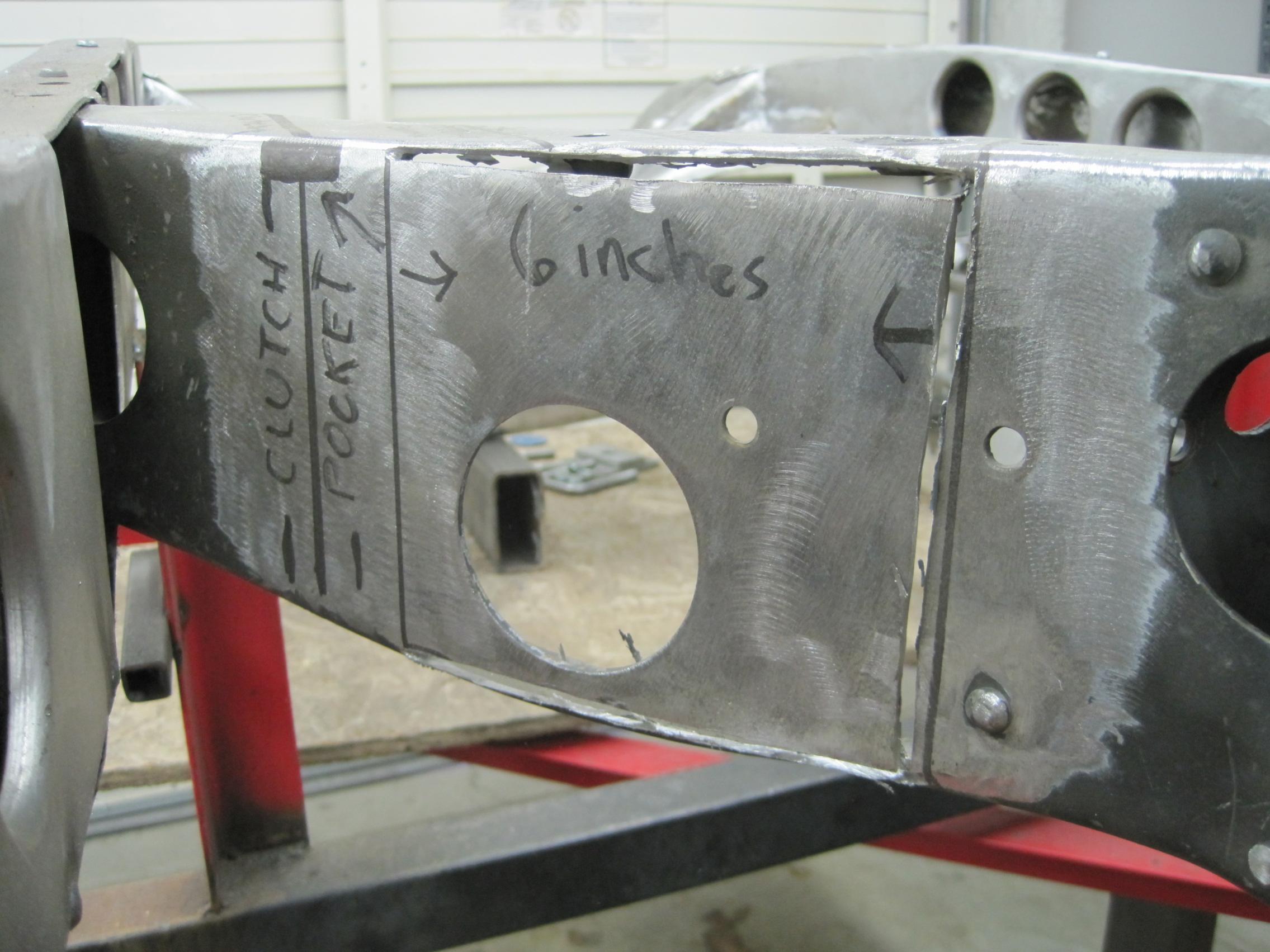

  5. Step 5: I decided that 6" was a good amount to start with to cut out of the x-member. You might be able to get away with a little less. I wanted to get rid of the stock hole right in this area.
    kidcampbell71 likes this.

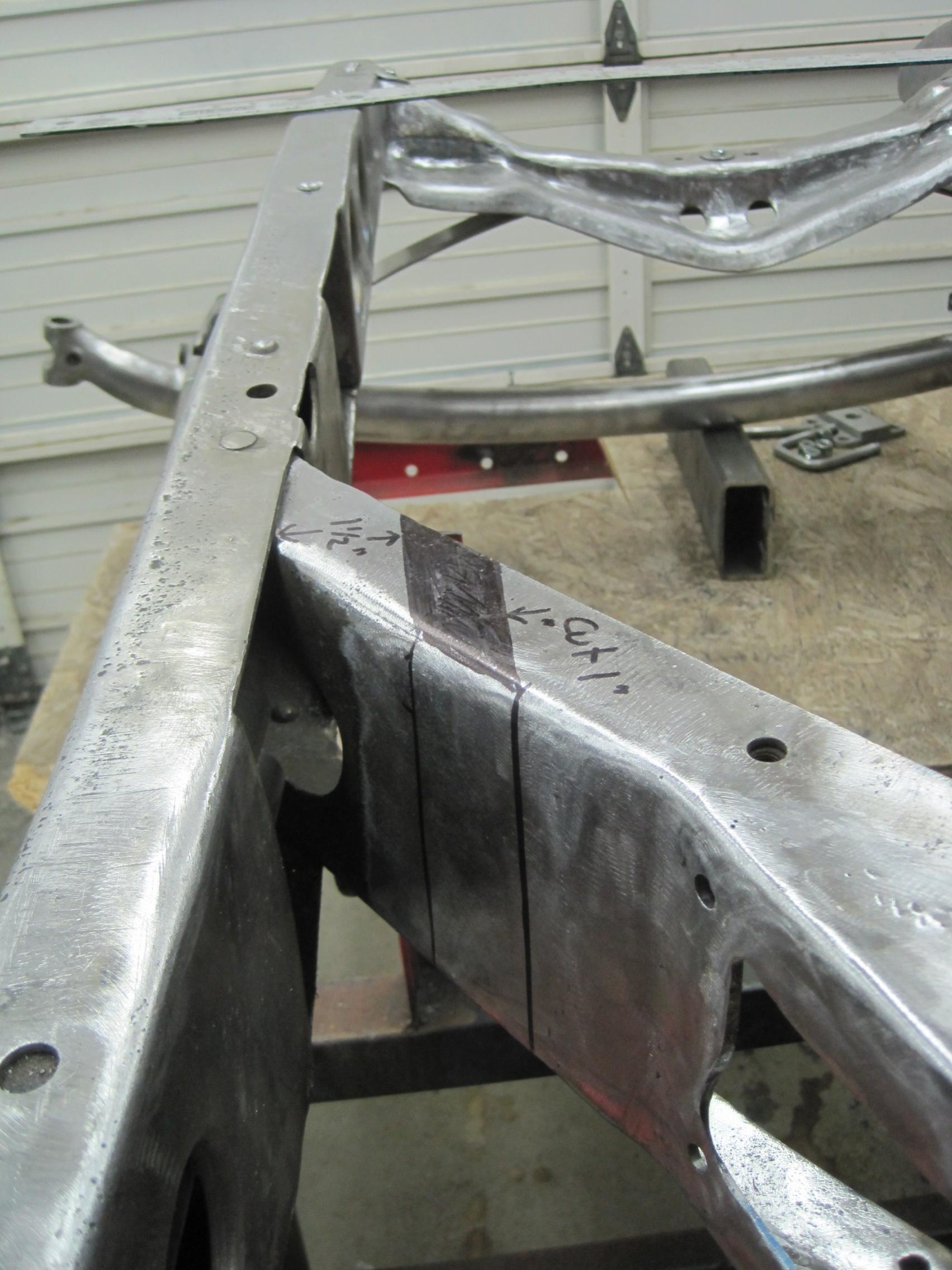

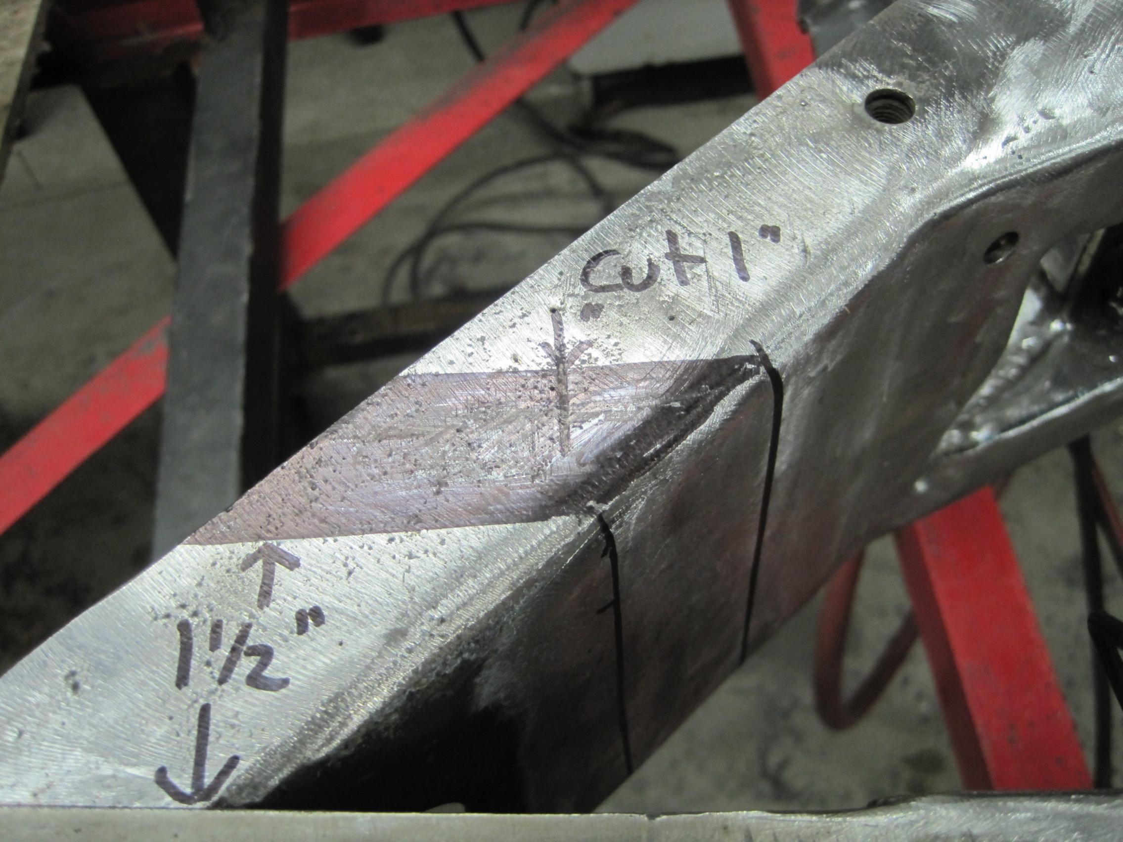

  6. Step 6: Next I went with my cutoff wheel and made a cut. I needs to be right next to the stock tranny mount. See pic. This is from the engine compartment area. The second pic is from the other side. I am close to my line here. This isn't rocket science kids.
    akoutlaw and kidcampbell71 like this.

  8. Step 8: I added an 1 1/2 strip into the gaping hole. This step will become apparent in the near future. You have to get things moved over a bit for it to work.

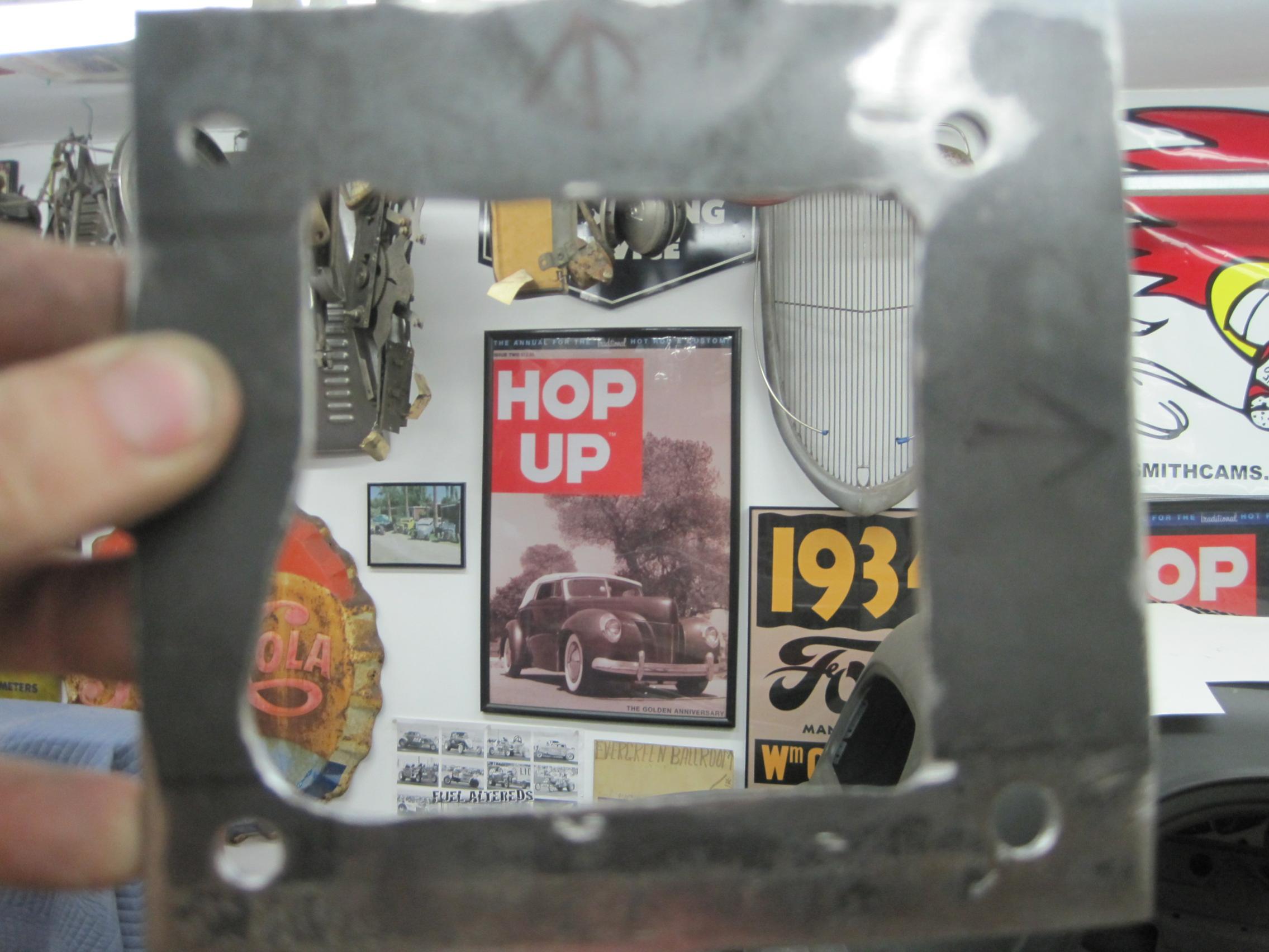

  9. Step 9: I took the piece of metal that I cut out and hogged out the center so I could use the piece for a pattern to mount the 39 pedals. I guess I could have used some poster board but this seemed logical to me at the time.

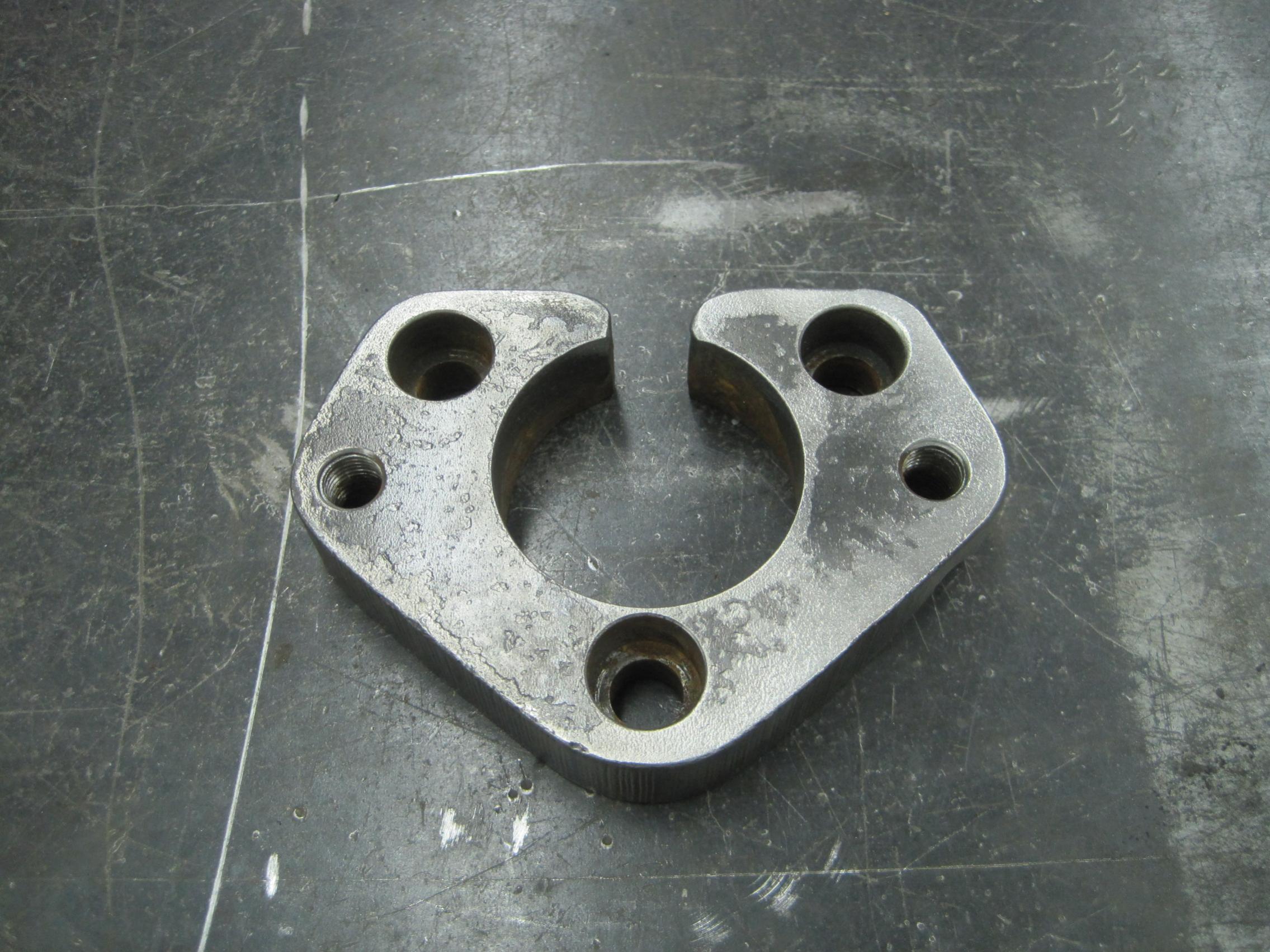

  10. Step 10: Here is the pictures. I think you have an idea where I am heading with this. Made a new piece off the pattern and drilled the holes for the mount. You may want to slot these hole vertically to give you some adjustment up and down. I will slot mine as the bail on the MC is kinda close to the plane of the floorboards.
