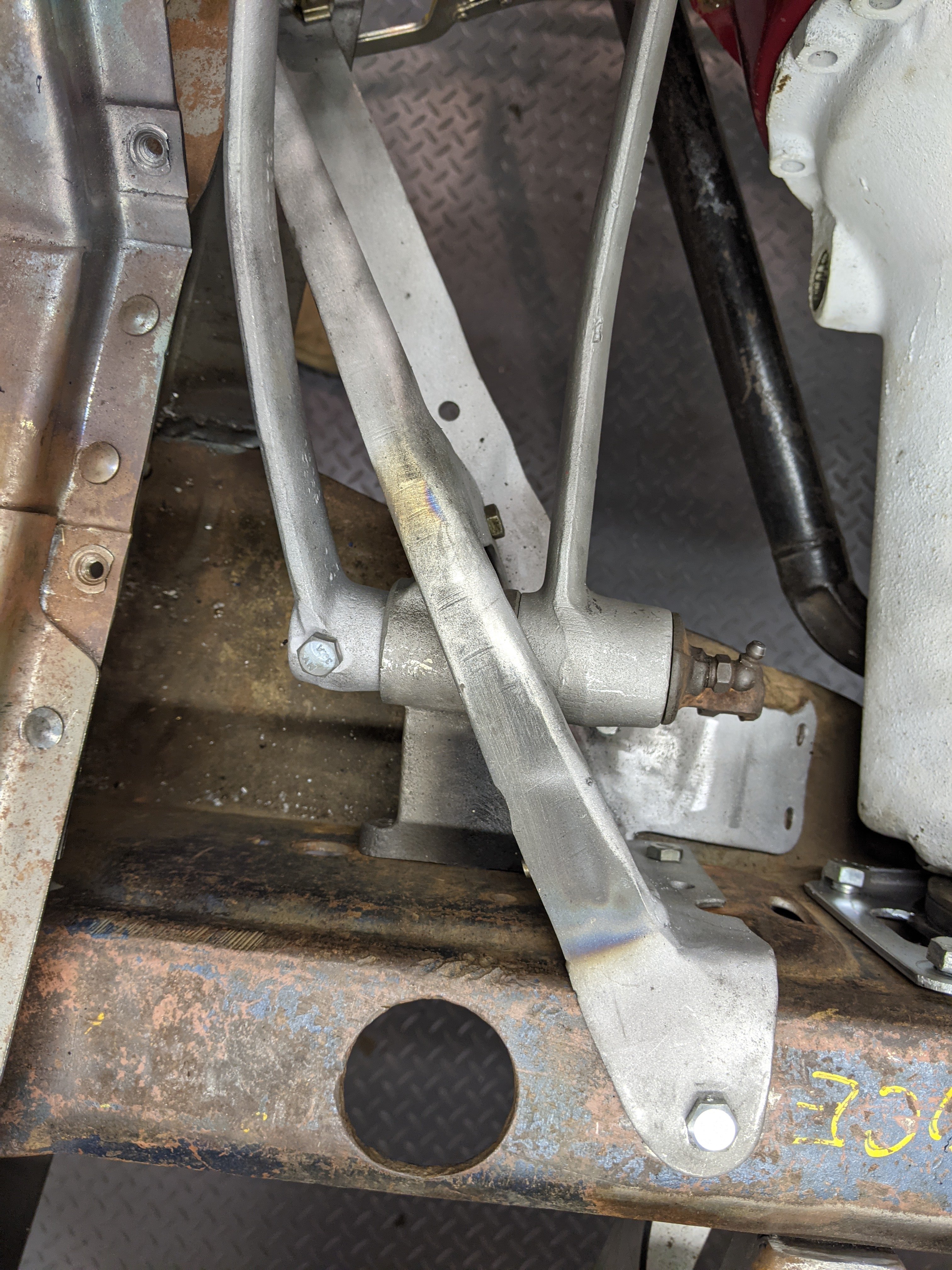

    While going through the process of tightening up the '39 pedal assembly in my roadster build, I came to the unfortunate realization that a guy is more likely to find where they buried Hoffa than getting his hands on a brass bushing for the brake pedal arm.
    It's an obsolete part.
    With some researching and reading posts over at Ford Barn here on the HAMB that were helpful, but lacked the photos and direct specs, I figured maybe this process will help some others. No offense to Dick Spadaro, I really didn't want to use plumbing parts. With some notes scratched down from a post on Early Ford, I jumped over to the Amazon speedshop and ordered a bushing and got after it.

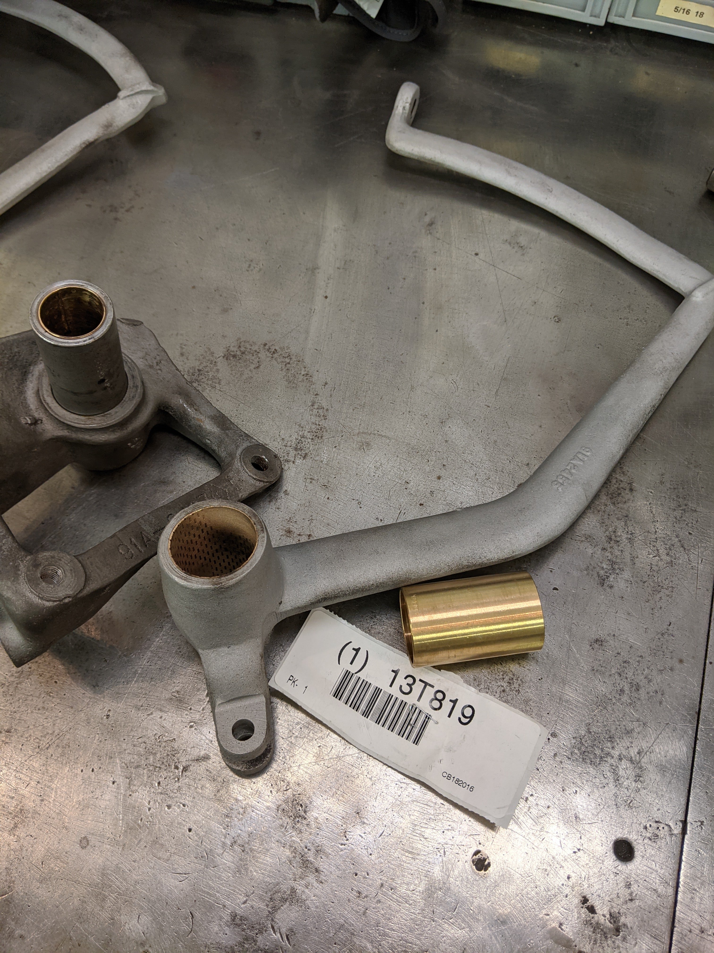

    Parts & Tools Used
    • Bronze Bushing (full specs below) - Bunting Bearings p/n:
      CB182016A1 - it measures out at 1-1/8" I.D. and 1-1/4" OD x 2" overall length. I paid all of $8.41 for it...
    • Straight edge, adjustable reamer (borrowed a set from a fellow local hot rodder). You can pick a set up for around $100 if need be and you'll find countless uses for them anyways. Select the size that's right.

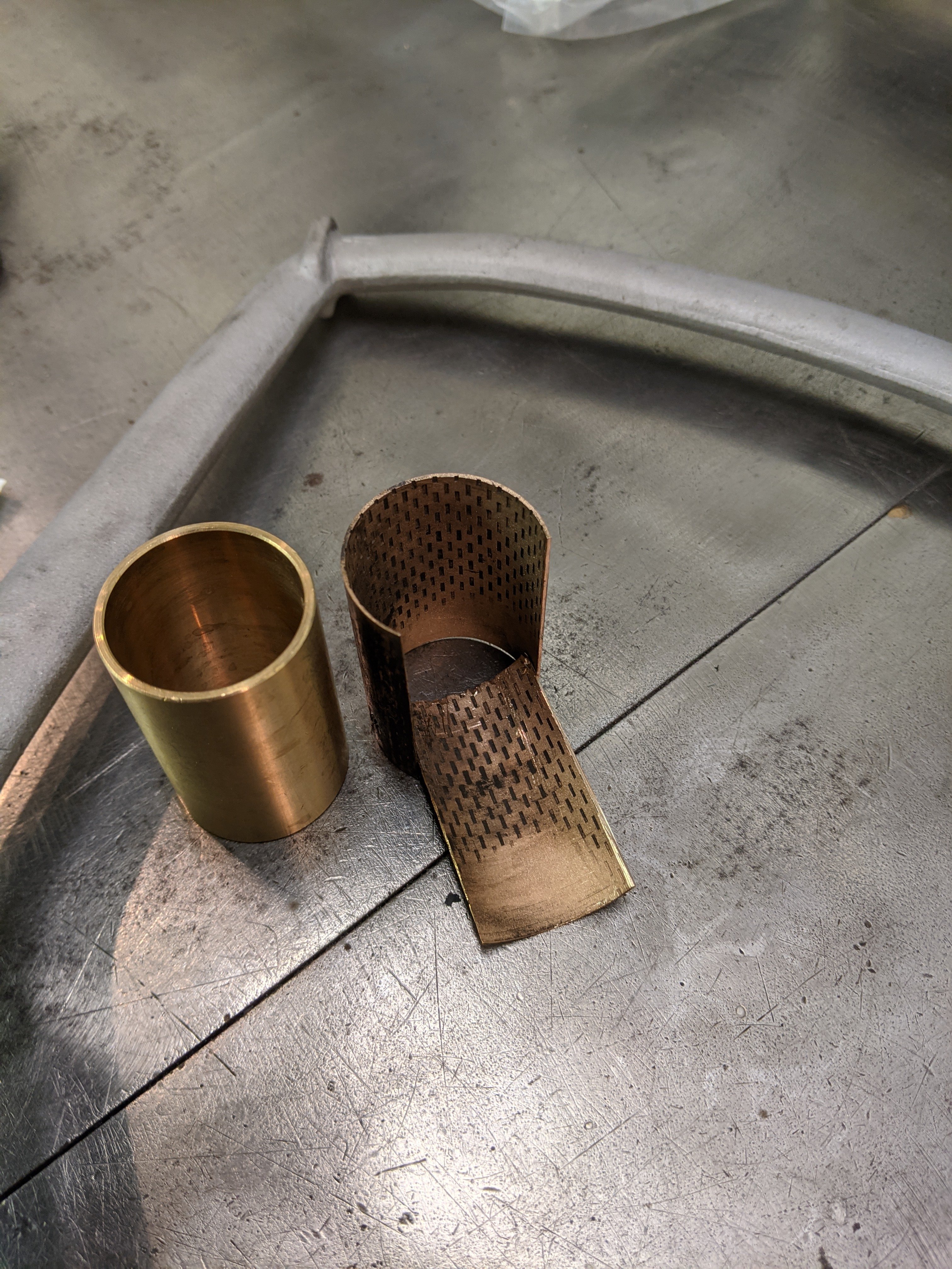

    Step One (removal):
    Remove the old bushing from the brake pedal arm. Using a hacksaw blade, I cut a slot in the brass, using caution to not go too deep into any of the pedal arm material. I did this a few degrees out from the original crush slot in the bushing to then knock out the piece with a drift punch. This allows the old bushing to spring loose and you can follow suit with your drift punch to remove the rest of the bushing.
    Run some emery cloth or fine grit sandpaper to help clean up any nicks you might have put in it when removing the bushing.

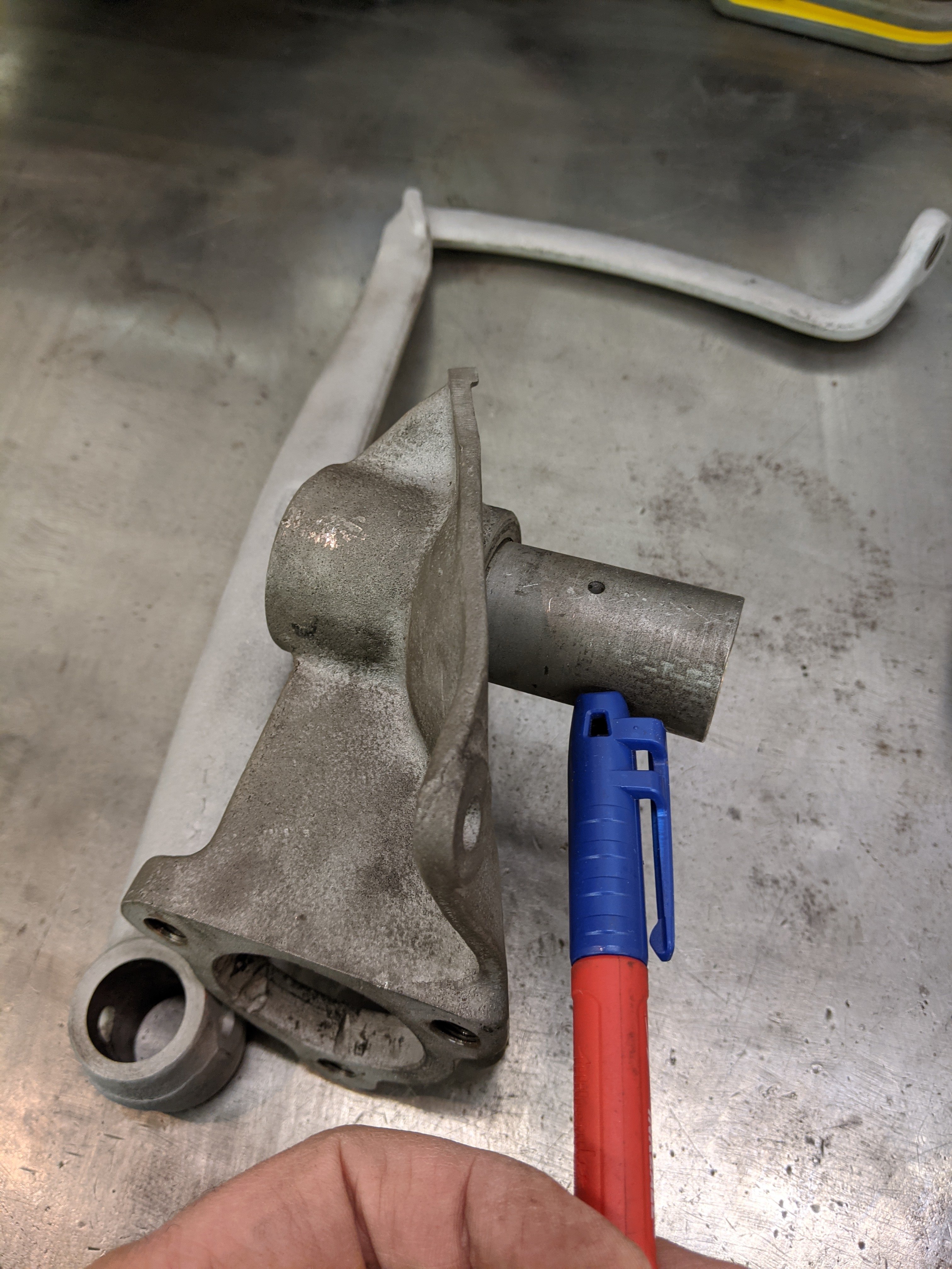

    Measure and inspect everything. Inspect the pivot shaft that the brake pedal rides on for any excessive wear. This is the one that the cross shaft for the clutch slides through and ties the unit together. Mine wasn't terrible, but I had one on hand from Third Gen Auto that I actually used the bushings out of for the clutch side.
    Measure the O.D. of the pivot shaft. This is going to give you a target measurement for the I.D. you'll need to ream the bushing for.
    Measure the I.D. of your brake pedal opening. I did this due to my own degrees of OCD and needing to know that the $8.41 bushing I was attempting to jam into an 82 year old piece of steel was going to fit...
    Bushing spec'd out at an O.D. of 1.23" and an I.D. of 1.11" and darn near 2" long
    Step Three (assemble):
    The O.D. of the bushing measured out 1.23" and pressed in nice and smooth with a shop press. I think that if you didn't have a shop press, a block of wood and a deadblow would have done the job too. Note: this bushing is really what they call a "sleeve bearing" so it doesn't have the cut half way through.. meaning you won't get it out of alignment if you use a hammer.
