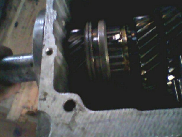

    Can anyone help me out?
    I moved the slider(?) closest to the front of the case...I believe it's the 3-4 slider...Now I can't move it back...3 of those "thingies" pop up, but even if I try holding them down, I can't slide the slider back up to the position it was in when i took the top off the box...It's like the slider is binding up or something.
    I don't know what gear it was in, and I have turned the shaft since I took it apart.
    The other slider moves back and forth no problem, and my Junk S10 trans that I took the tailshaft off of, both sliders move back and forth, no problem...
    Anybody got any ideas?
    Thanks

    Got to get all 3 "thingies" back flat ( they may need replacing &/or springs inside slider hub). they shouldn't be any further out than the hub that slider is on (rearward in your case) and you may have to pry it back. "three" hands anyone?
    we can try to coach you through; remove input shaft, inspect syncros & reset sliders/springs, install bearings/syncro/input shaft bearings (flat & rollers)
    But I would recommend getting one of the rebuild books ( 2 good ones available at book stores) I like the Yellow one better ( has other old school 4 speeds in it, the other has crap for Honda 5 speeds:confused:)

    Ok, those three thingy things are the index keys. Heres what you have to do, and it will probably take you a few times but trust me it will work.
    1st. Turn the shaft till you can see two of the index keys, they will be at 10 and 2 o'clock.
    2nd. Take a small screwdriver (straight blade) and carefully push down and forward on one of the index keys, while holding pressure on the collar.
    3rd. Do the same to the other one that you can see.
    4th. This is where it gets a little tricky, while keeping pressure on the collar you have to turn it until you see the last key.
    5th. do the same thing with the last index key, push down and forward. When its in position the collar will slide back.
    DO NOT just pry on collar and think it will go back in place, you WILL break all the index keys and have to take it completely apart.
    Hope this helps.
