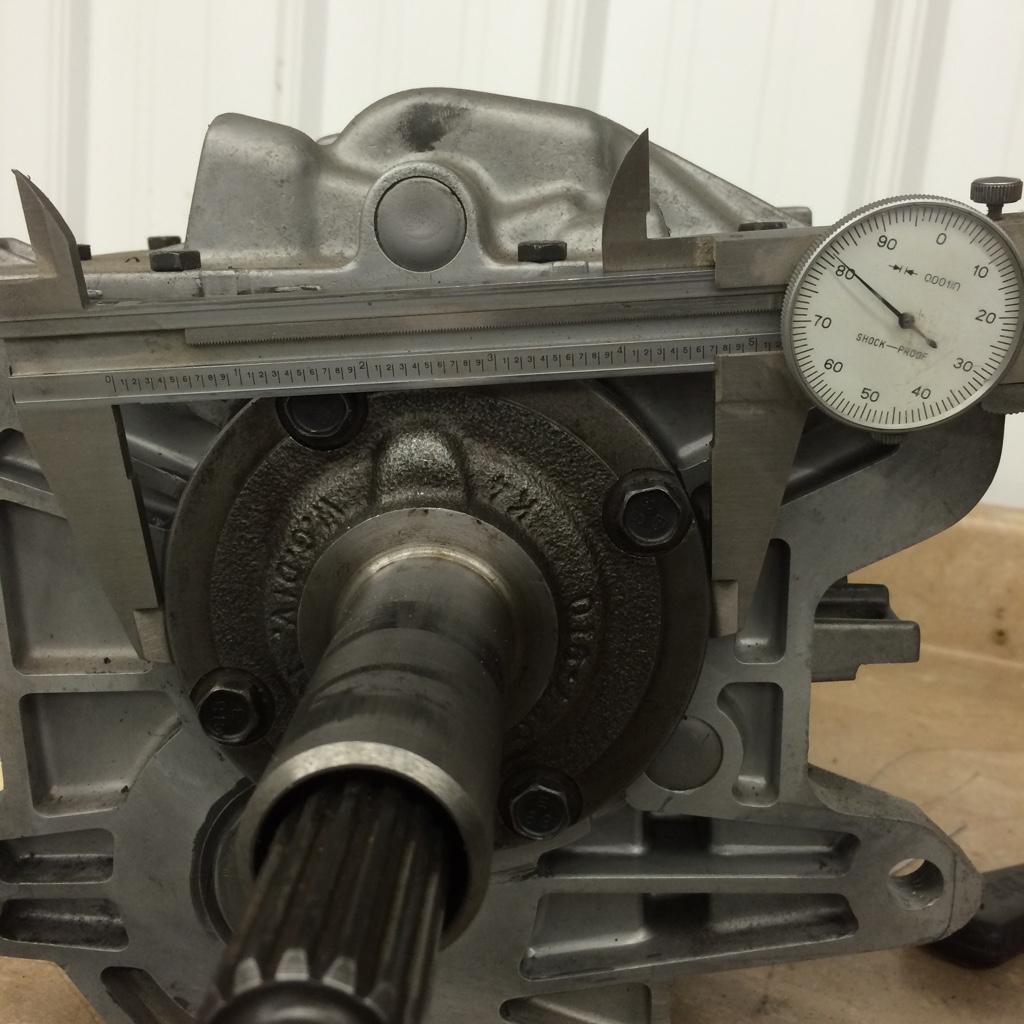

    What is the thickness of the mounting ears on a GM Muncie-style T-5? I don't have one on hand and I'd like to go ahead and order mounting studs.
    Thanks, Eddie
  30. Bcap55
    Joined: Oct 5, 2009
    Posts: 166
    Bcap55
    from PA, USA
    I have a 1983 T5 from a V8 Camaro with the Chevy bolt pattern, the mounting ears are .530 inches thick.
