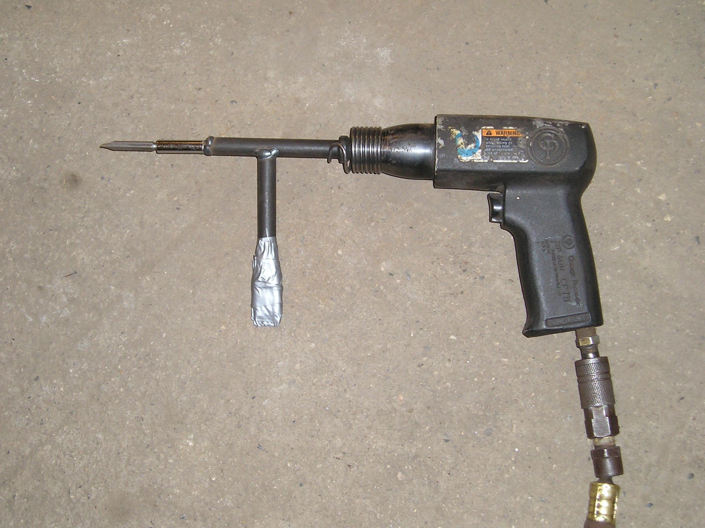

  26. norms30a
    Joined: Jul 17, 2008
    Posts: 588
    norms30a
    Here's mine.Stumbled across the thread about 6 months ago.
