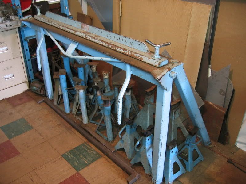

    I built this brake many years ago from scrap metal at a shop I was working at. I paid $45 to have a 45 degree angle machined on the top part. There are nuts welded under the 3 holes on each side at different locations so you can bend different thickness material. I also have a piece of round stock with a couple of tabs welded to it for bending radius'. If I need to use it like a leaf brake I just cut a piece of flat bar and clamp it in place. Been using it for close to 20 years now.
