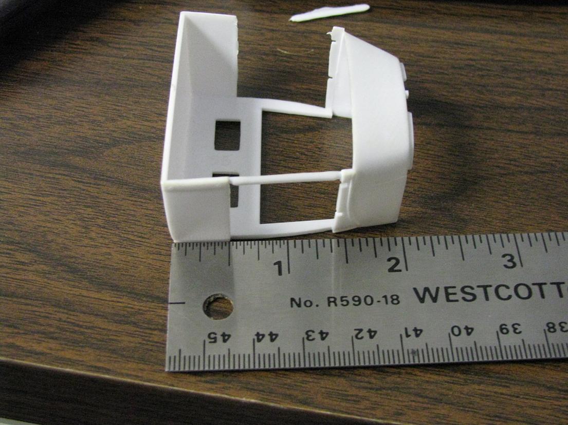

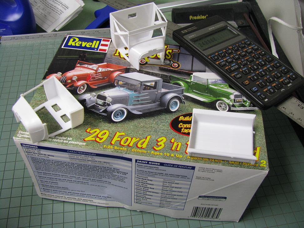

    I came up with a solution that would get me close enough. I went to a hobby store and bought a scale model of the car I wanted to build. I would take measurements from the model and scale it up to create my own blueprint for the build.

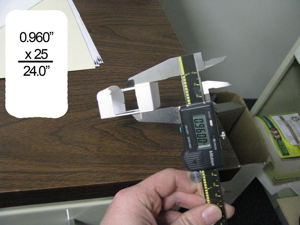

    Tools needed: calculator, ruler, calipers, & a decent scale model.
    Carefully measure the pieces need for your drawing. Multiply the your measurement by the scale your model was built to. In my case the Revel model kit I bought was a 1:25 scale. So I multiplied everything by 25.
    This method will get you close to the outside dimensions You will still need to account for flanges and internal details not present on the scale model. The kit I bought came with a separate frame, bed, & 2 cabs.

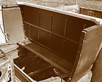

    Thanks. I'm not worried about the doing the metal work. Vintage tin is real scarce here in New York State. I just couldn't find any plans or drawings for the cab. I still need to find one locally so I can see how the door jamb goes together. The drawing I was able to put together should get me real close.

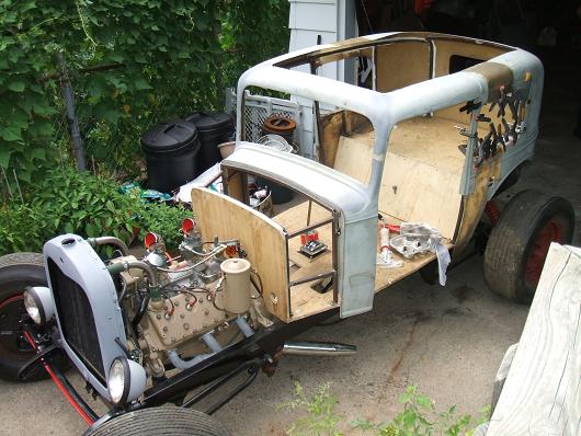

    I extrapolated measurements from photographs when building the cowl mold for my Bantam. Once you have a known measurement, the rest is just simple math.
