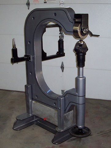

    Here are some homemade tools for metalshaping.
    The E wheel is basically 3/16 steel welded in a box section with the lower anvil holder made from a semi driveshaft spline and yoke. A planishing hammer and other tools bolt to flanges welded to the sides to save space. Other tools include various hammers and a double ended shrinker/ planishing hammer.
    deChrome
    couvy likes this.
  7. beaulieu
    Joined: Mar 24, 2007
    Posts: 364
    beaulieu
    from So Cal
    more info and more pics on the double ended shrinker/ planishing hammer please
    thanks
    Beaulieu

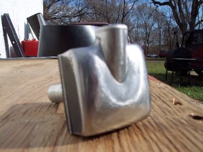

    Anouther low buck tool you can get are these weld on pipe caps.
    They come in many sizes.

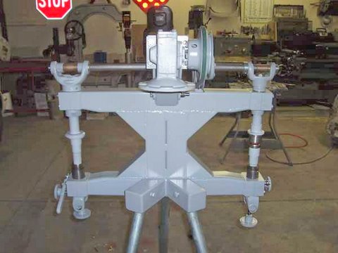

    For those that want more picts. of the double ended shrinker,here are what I have.
    The major parts are slip joints, with the motor driving thtough a 5 to one reducer.
    It is a little slow for pro but ok for my use.
    the thumbnail shrinking dies are not for this machine but illustrate the shape required.
    deChrome

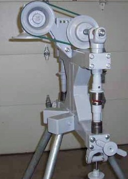

    While I am on a roll, here are pictures of a slip roll ane a tinker tool used for contour templates. Also a shot of the Ewheel graduated dial for repeat adjustments.

    O K ,dechrome,......You've done it!!!! Gonna' need a closer pic of the shrinker/stretcher doodad, specifically where the shafts, and I am guessing, the eccentrics, are all located.........Gotta see how that all came together, and what was used, If You please......

    Stealthcruser,
    The eccentric is 3/4 in dia turned 1/8 in offset on a 1 in shaft and a 1/2 in dia turned on the end of the shaft for an outboard bushing. An olite bushing is slipped onto the eccentric to give a floating bearing for the splined U joint yoke with the ears cut off.
    The stroke is only 1/4 in and there is no return spring so no eccentric contact until metal is inserted in gap.
    The lower tool holder has an adjustment screw from below.
    I hope this is clear enough.
    deChrome

  24. stealthcruiser
    Joined: Dec 24, 2002
    Posts: 3,748
    stealthcruiser
    Thanks, Bro....Thats pretty damn clear, now I have to sit down and draw
    it!!!!!! Thanks for the info!!! You did say the u-joints/ slip joint thingys are all big rig castoffs, correct?

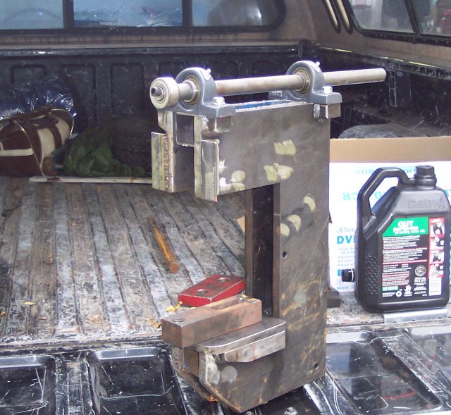

    First 3 are my little reciprocating machine - some call it a power hammer, but it's not.

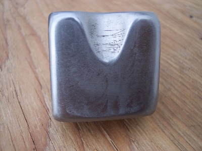

    The pipe tee hammer I mentioned in a previous post. It's as simple as it looks. I drilled a hole in the top of the tee and ran a drywall screw down into the handle....just in case.

    I think it is about time I start thinking about a reciprocating machine.I might have a few questions for you Tim when I do.My to do list is getting pretty long so it might be awhile.

    Here's the first one:
    Here's the business end. I used a similar design on both machines, but made different ways.
    The first one had a variety of eccentric designs. In its first incarnation, it was built with nothing but a drill press, a chop saw and a welder. Ok, there was some grinding too. The first design eccentric was a cut off piece of shaft with an off-center hole drilled in it and a threaded hole drilled in the end of the shaft. The next couple of variants are harder to explain - especially without pics, so I won't even try.
    The eccentric on the yellow machine was made by sticking a piece of scrap steel on one jaw of the 3-jaw chuck and turning the 1-inch shaft down to fit inside the bearing. The stroke comes out to around 3/16".
    Both designs use a yoke over the bearing to lift it back up. Easier than a connecting rod. Might not be as good, but it's been working for me since '05.
    That's it in a nutshell.

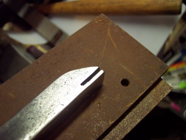

    I've got one of these too, but rather than marking the line on your piece and inserting the tool up to it, and having to keep running that same line, I put a couple slits in the tool and marked them with number stamps-- One is 1/4-inch, one is 3/8-inch, and on the other end of the same tool is a 1/2-inch slit. That way you decide how wide of a flange you need and just bottom the tool onto the work piece.
    The one I have right now is made of 1/4-inch stock--being thin, it allows me to bend a flange around a bend. For instance, if you take a rounded edge and want a flange on it, the thin tool will make the radius. Work slow and "walk" it around, and you can work the metal that would normally need to be shrunk.
