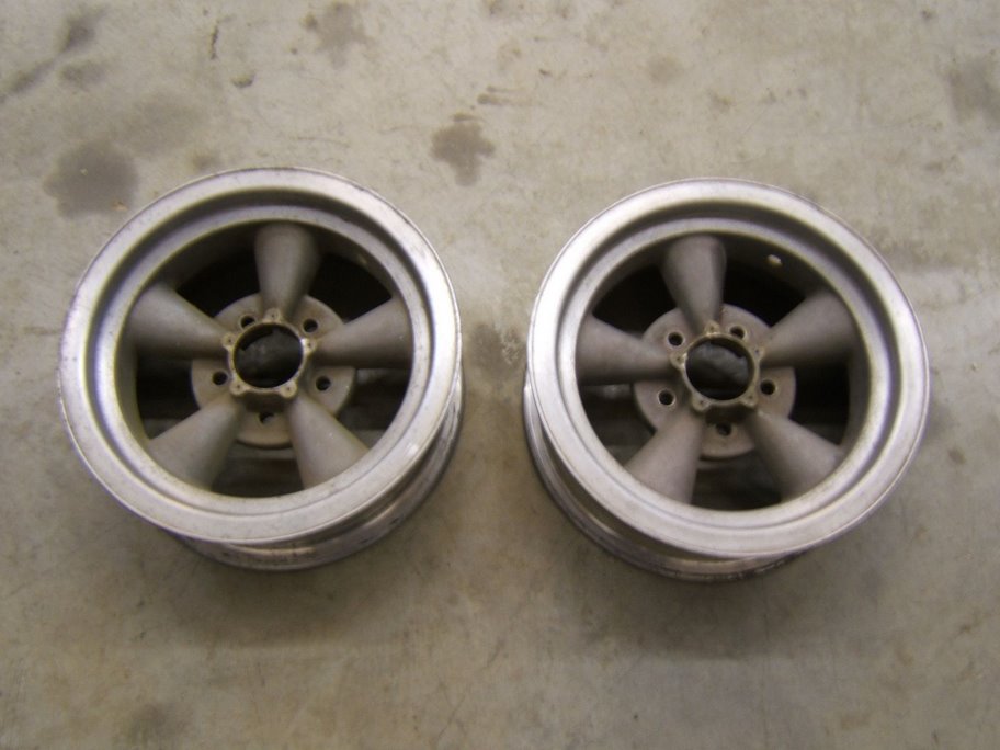

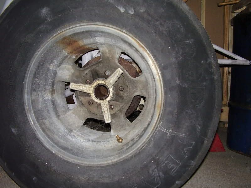

    I recently bought a pair of rough looking 16x13 Halibrand magnesium wheels off an early funny car.
    They had been previously polished but had sat for years and had rust stains and some pitting.
    I didn't want to polish these wheels and I wanted the "dark" look that seems to only come with age. I tried rubbing out the rust stains without removing the magnesium patina but I didn't have any luck.
    Scotch Brite pads or fine sand paper on mag wheels seems to remove the oxidation and the natural dark layer and almost gives a polished look that I don't care for, plus it's a LOT of work.
    Glass beading is another option, but someone had told me that shot peening seemed to work better and gave more of a cast finished look.
    Here are some shots of the wheels as purchased:

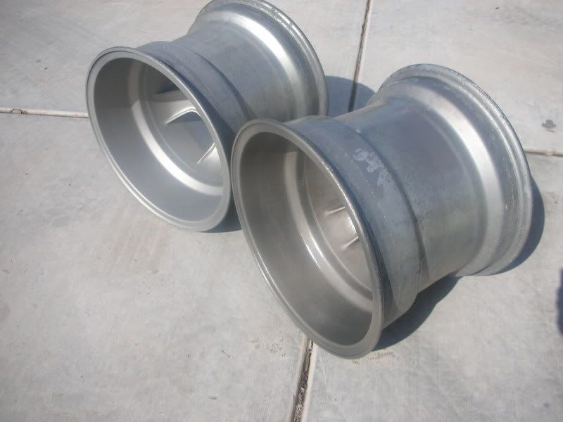

    I call my local machine shop and explain to them that I want to try shot peening some magnesium wheels. They say sure and I bring the wheels down.
    For those that don't know, shot peening is used on engine parts such as connecting rods or cylinder heads. They use metal "shot" to bombard the surface of the metal. It's done inside a large metal cabinet.
    The cost was $80 which is about an hours rate for most machine shops.

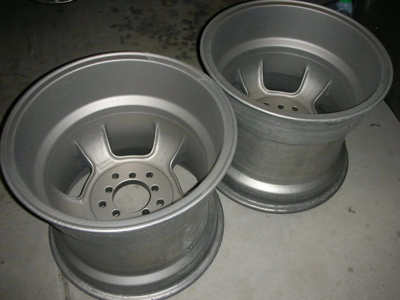

    The process really cleaned the wheels up nice but I wasn't happy with the color. Too light for my taste:

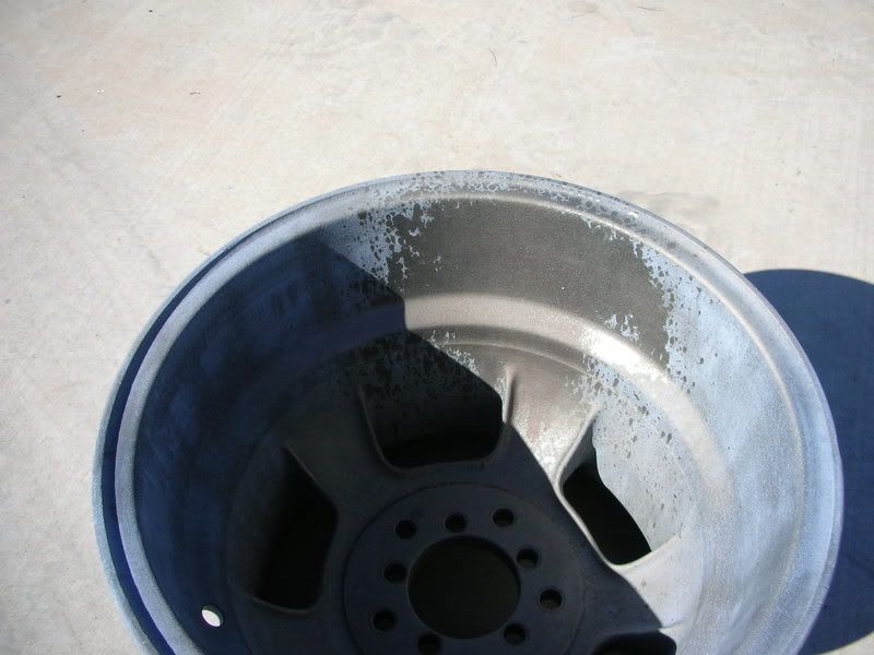

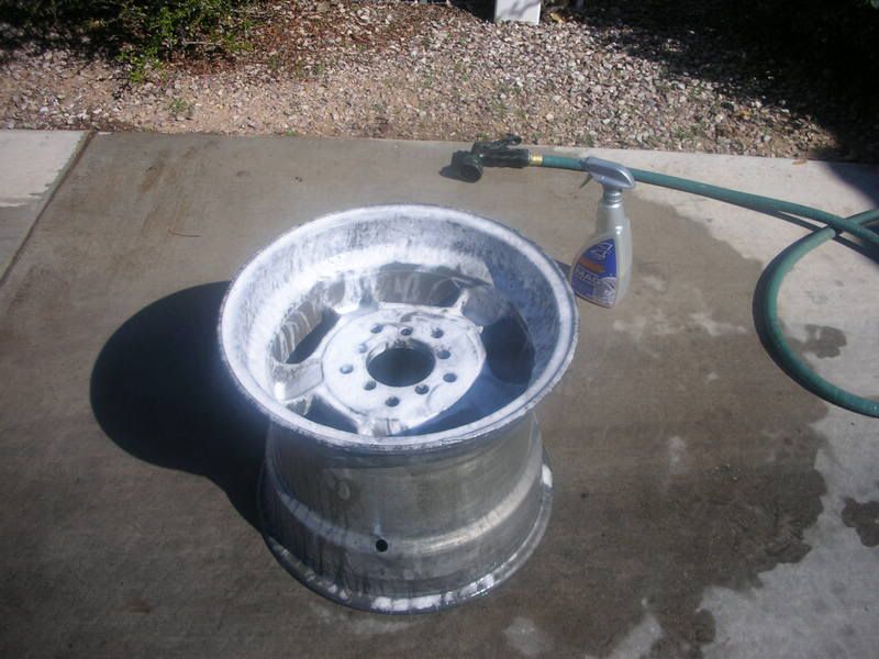

    It would have been a pain to apply with a rag and make it even, so I sprayed the whole wheel and let it sit for a couple minutes.
    The next photo is not for the faint of heart. Yes I'm spraying magnesium with water!!:eek:
    I could tell right away that the color changed.
    Flip it and do the other side:

    I'm happy with the way the wheels turned out. They are not super dark, but look much better than before.

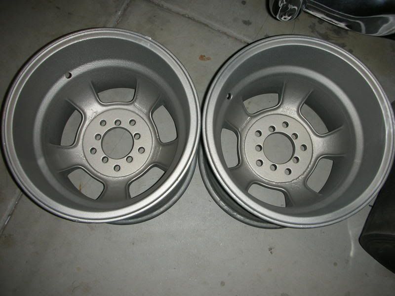

    UPDATE:
    I had read another post on the HAMB about using dry graphite spray to darken up mag wheels. I was at NAPA yesterday and I decided to buy a can and give it a try:
    It's kinda tricky, but I had luck spraying it sparingly and then using a rag to spread it out to get the color even and not too dark.
    Here is the finished product:
    Here is a side by side shot of 3 other magnesium wheels that are all natural mag with only some Gibbs sprayed on. The wheel I finished is in the middle. If you get carried away with the graphite it will look too black as opposed to dark gray.
