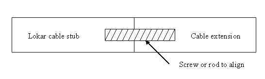

    Next you will need to find some sort of suitable 1/4" flex shaft to extend the existing shaft to the top of your new lever. I used throttle cable from a lawn mower. Here are a couple other suggestions.
    *Speedo cable (minus plastic sheathing)
    *Throttle cable sheathing- the ones made with round wire look like they would be better than the flat wire ones.
    *Solid 1/4" rod would work if there are no bends
    I tacked a small screw in end of mine so I could join the two pieces together and keep them aligned.
