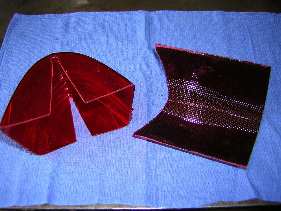

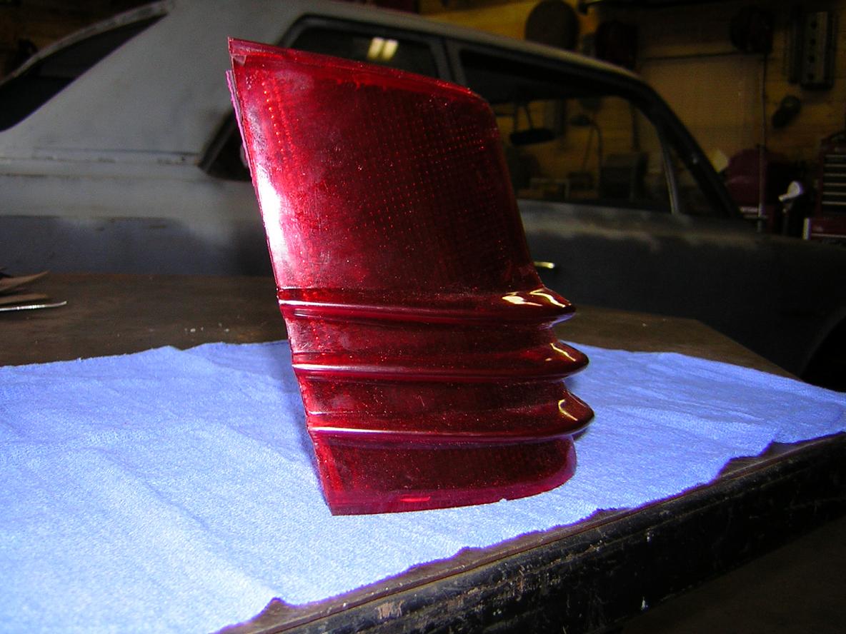

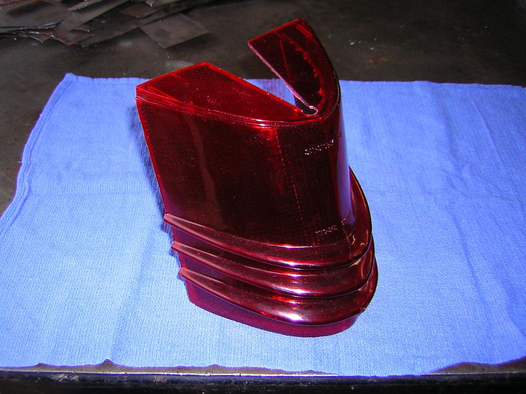

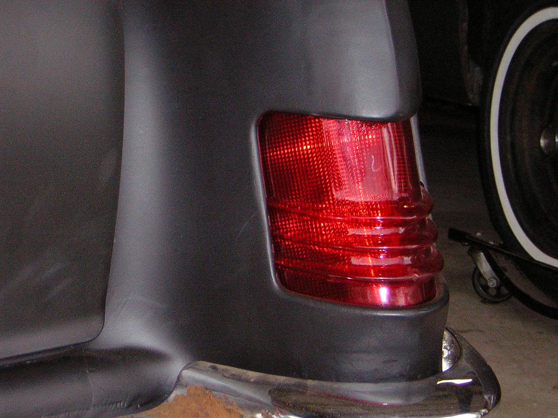

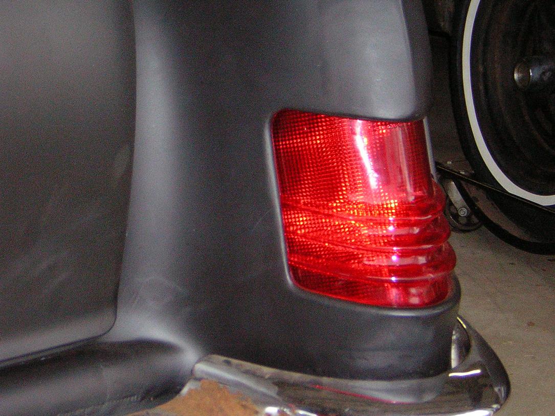

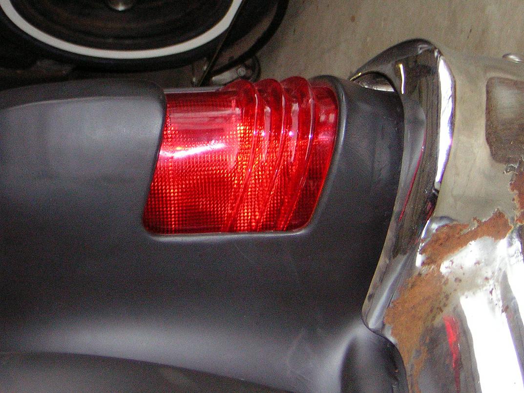

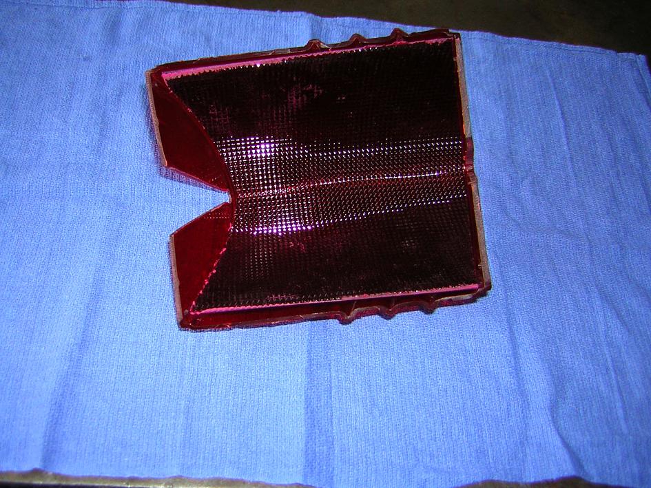

  1. Here are the pics of the diffuser I made to install inside the 54 Merc taillight. It is 1/8 inch prismic red plastic. It gives the lense a bit more contrast, spreads the light more evenly and hides the light bulbs.

    If you find that the double lenses are a bit dark when the light is on you might take a sheet of aluminum foil and wad it up and gingerly onpen it up before gluing it to the reflector. You will be amazed at the amount of additional difussed light it produces.

  4. Good tip Dickster27,
    I plan on polishing up the stainless plate the bulb sockets are in and either painting the top and bottom white or silver. Aluminum tape works well here too.
    You can never have too much light when it comes to the taillights in a rod or custom. Last thing you want is a chick in a Honda in your trunk!!!
