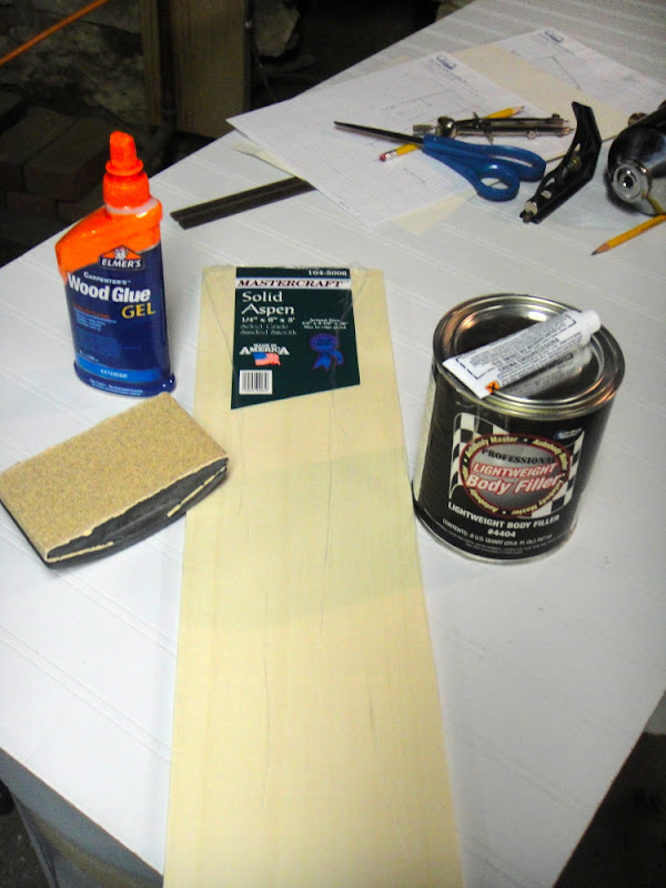

    To make the master for the casting, the only materials needed are wood (I used aspen), wood glue, bondo, and tools that you likely have in your shop. If you have a few woodworking tools as well, all the better.

    The Steps
    The first step is sketching the bracket from a side view and a top view. Make the sketch to actual finished size.
    When transferring your sketch to actual patterns, you will need to then upsize the part approximately 102%. This will account for shrinkage that occurs as the aluminum (or brass) cools in the sand mold. Making this 102% adjustment can be done by drawing the pattern with a sand casting ruler (make your own by xeroxing a regular ruler at 102%), or just xeroxing the actual size pattern at 102% before cutting up the upsized copy.
    After you have your patterns, cut them out and transfer to your wood. A pencil around the outside edge is close enough. I use a bandsaw to cut the wood, but a jigsaw will be fine.
    Hand sanding, or careful use of an air grinder with some 80 grit, can be used to fine tune the rough pattern parts. Cut all the pattern’s parts and you are ready for gluing.
