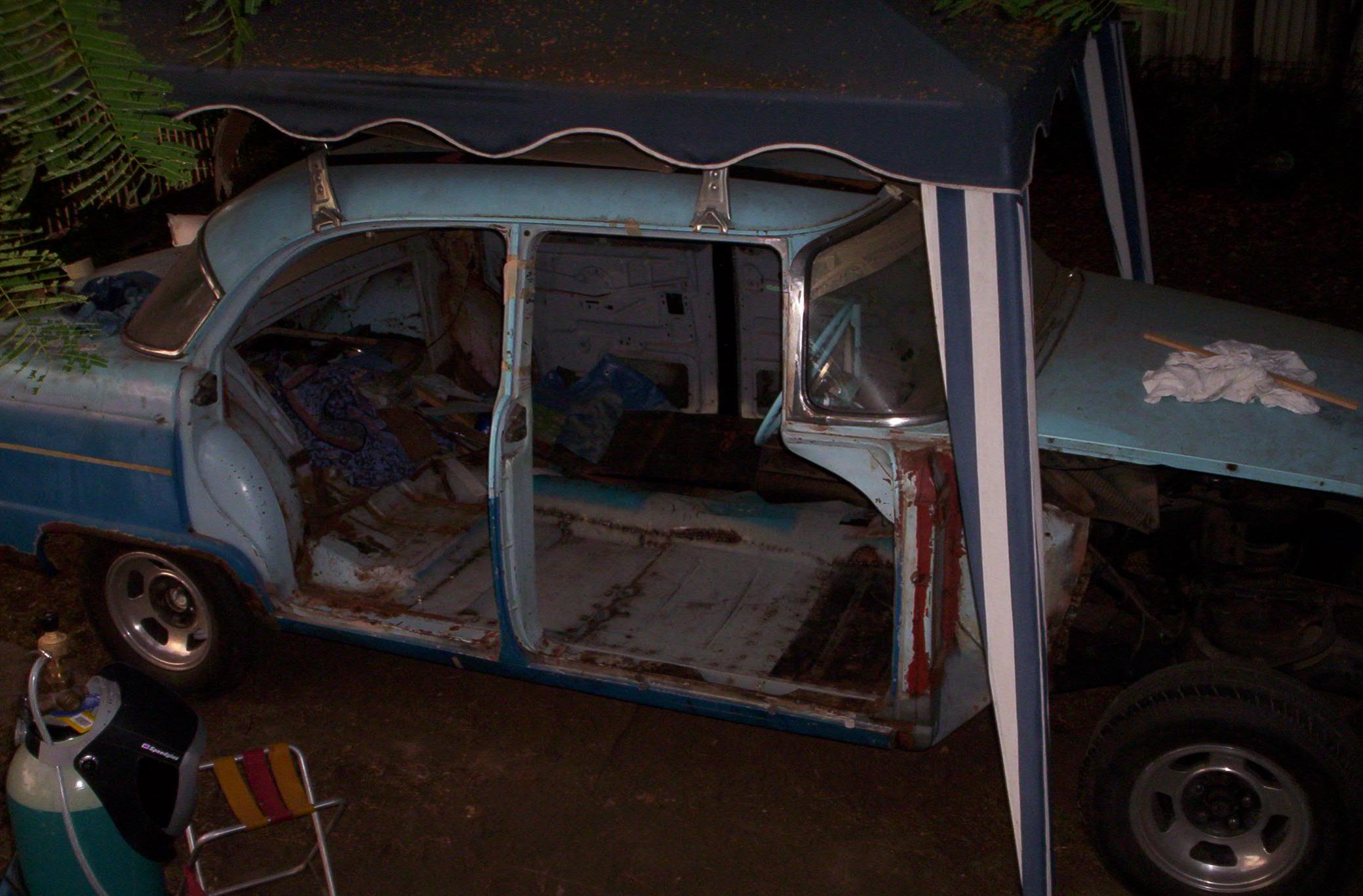

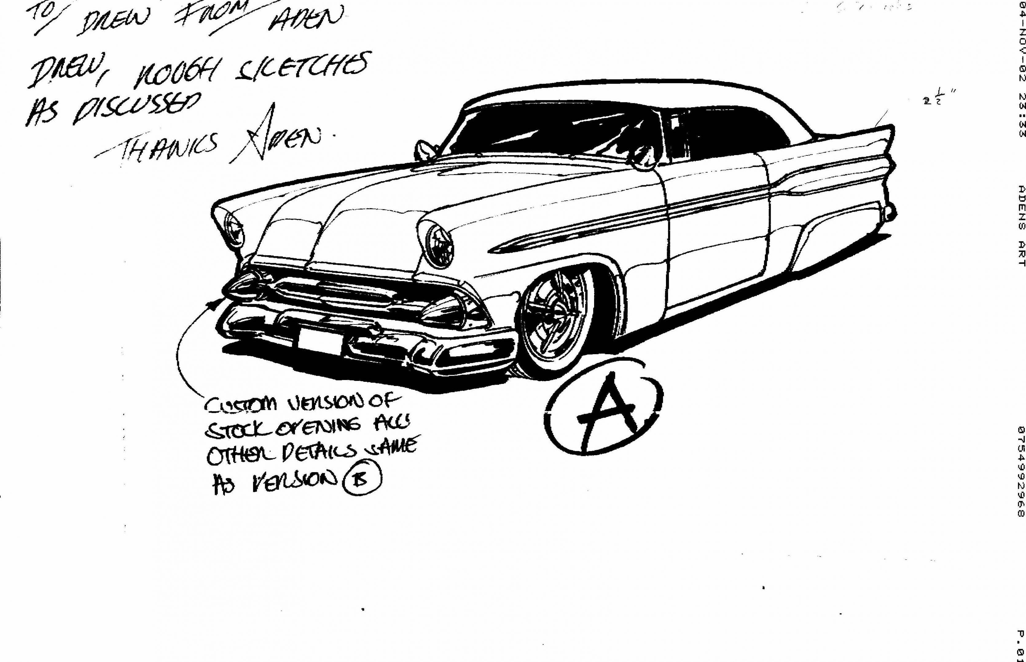

    Here is one way to store all those cleco's...
    Enjoying your work. Makes we want to get started on my '56.
    I need to go from this:
    To this!

  9. Do you have a build thread???? I really wanted to convert my '56 into a four door and make it a wild custom.
  10. drew56cus
    Joined: Feb 8, 2007
    Posts: 25
    drew56cus
    Me too MDM! But I have about a years worth of finishing other projects before I get to it - so no build thread. So in the mean time I am lurking around here to pick the brains of the guys that know what they are doing, like Dan!
    I have seen some threads where they weld the back doors to the rear quarters but most cars I have seen personally where that has been done end up with a line showing through a few years later. That is why I like Dan's method.
    Cheers, Drew
