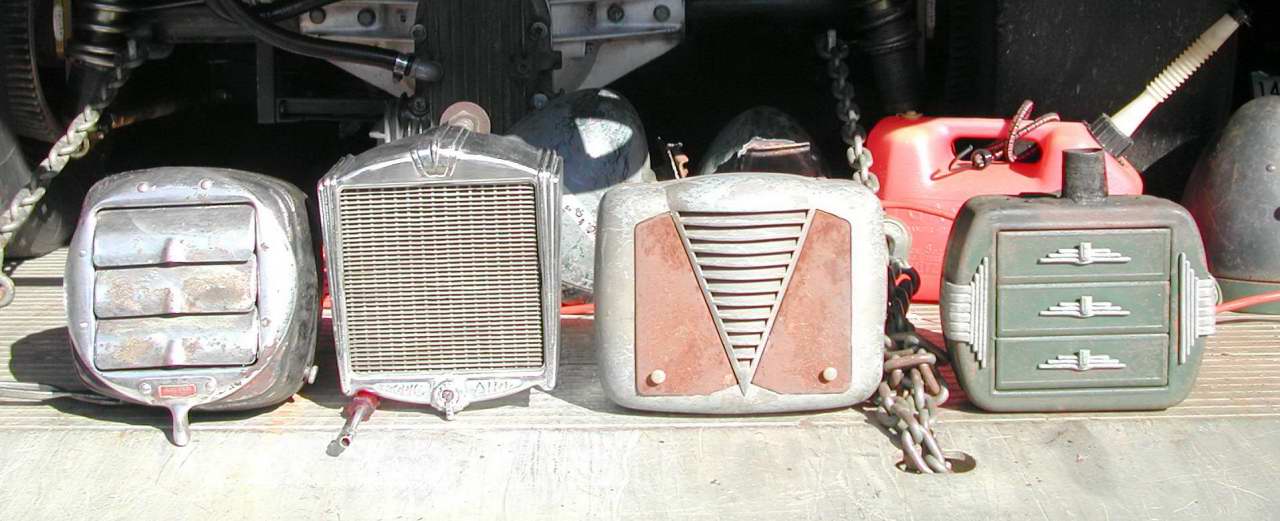

  8. Nice tech article. I'll have to see if I can do the same. Where I live, I need defrost more than heat.
    Here's a few I've had. I kept the 2nd from the right. I'll see if your tech will work for this one.
    I'm like you, I don't like the large distance standoff of the heater from the firewall.
