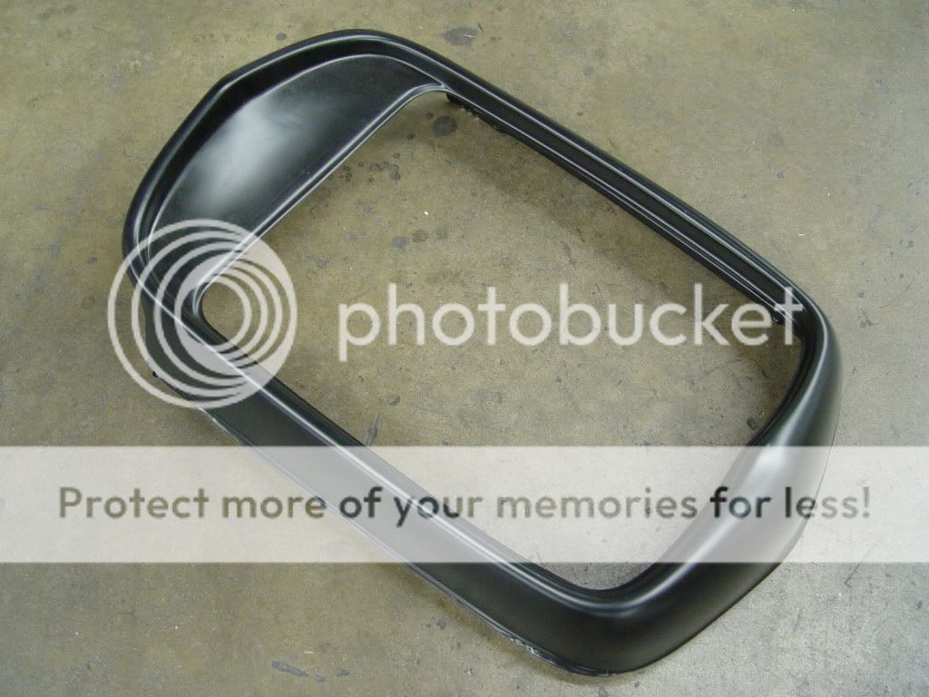

    With the welds complete you have something that is really taking shape now.
    I won't spend a lot of time going into detail about how to blend welds, but with some time and patience you can finish off those welds just dandy! There is a bunch of different methods. I'll come back to touch on my process in a little bit.

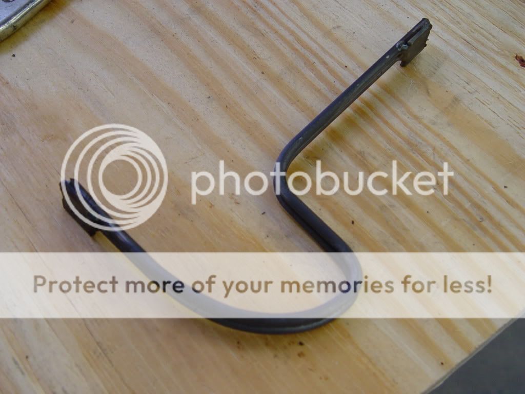

    I started with 1/4" round bar about 12 inches long and welded a couple pieces of scrap to keep them evenly spaced at approximately 1/8". The gap was fined tuned with a screwdriver.
    Next I used a standard bench vise to shape the form to the shape of the shell where the peak was going to be.
    Then I clamped the form using a couple small c-clamps.
    I adjusted the width as desired. The further apart they are, the taller the peak will be. You just have to be careful not to peak it so much that the metal tares. Then you have a whole new set of issues.
    Since there is no such hammer that can get in there and make the shape I made a "peaking tool". It's made of an 1-1/2" x 1/8" thick piece of flat stock. I used a bench grinder to get the initial shape and then fine-tuned it with the grinder. It's important to get rid of ALL sharp edges here. Any sharp edges on the surface will transfer right into the peak when the hammering begins.
    OKAY! Let 'er rip!! Support the grille shell and put the form flat on the floor or work bench so it doesn't move. Roll along the form so that the bench/floor is directly opposit the peaking tool when hammering. This will give the maximum stretching.
    Now you are left with a REAL ugly line of bumps!!
    Don't worry yet!! Keep going until you have more consistancy in your peak.

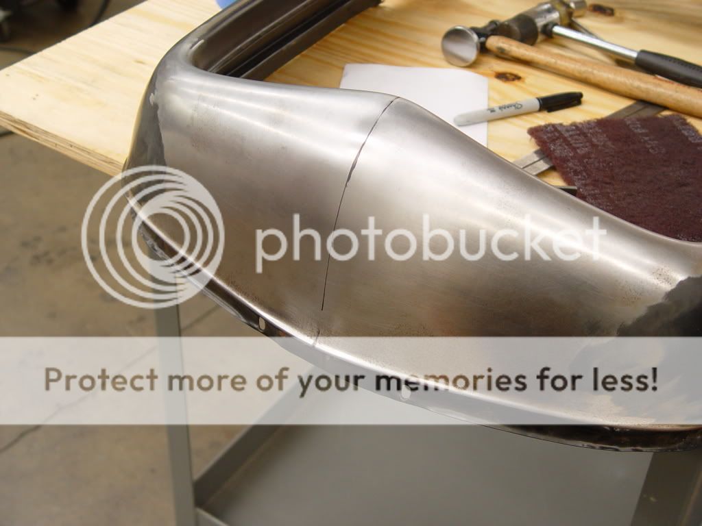

    I used various shapes of dollies and my hammers to stretch and plannish as well as this big thick steel plate. Not required, but it sure came in handy since I wanted just a change in direction and not a drastic swoop out to the peak. The flat surface helped find the low spots visually.
    After a ton of hammer and dolly work this is the result!
    Stripped the rest of the paint to check out all the lines and see what's left to straighten out. Little more work to be perfect, but it's really solid looking now.
    This is a time consuming project. Took me quite awhile to get everything straight. If I can do this YOU guys can do this!! I just used what I had around the shop to make it happen and TOOK MY TIME!

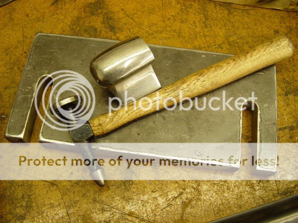

    Here's some tools I used along the way. You don't HAVE to use this stuff, but I had them and wanted more practice so I used them.
    The shrinking disc is a great thing to have. But again, not something you have to own to do this project.

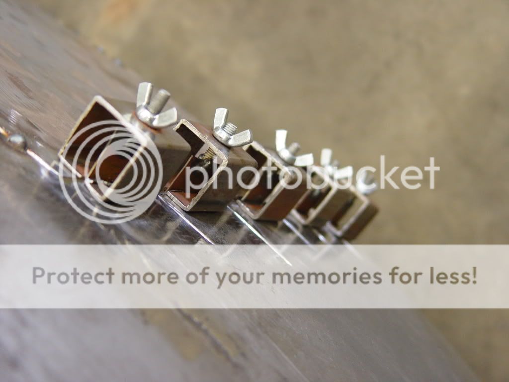

    The panel clamps were made from 1" square tubing, some 10-32 screws and wing nuts, sum small nails that I cut the heads off of, and some 22 gage sheet metal scraps I had. I think I have $5 wrapped up in these clamps. They are the best thing to use to gap your seams.

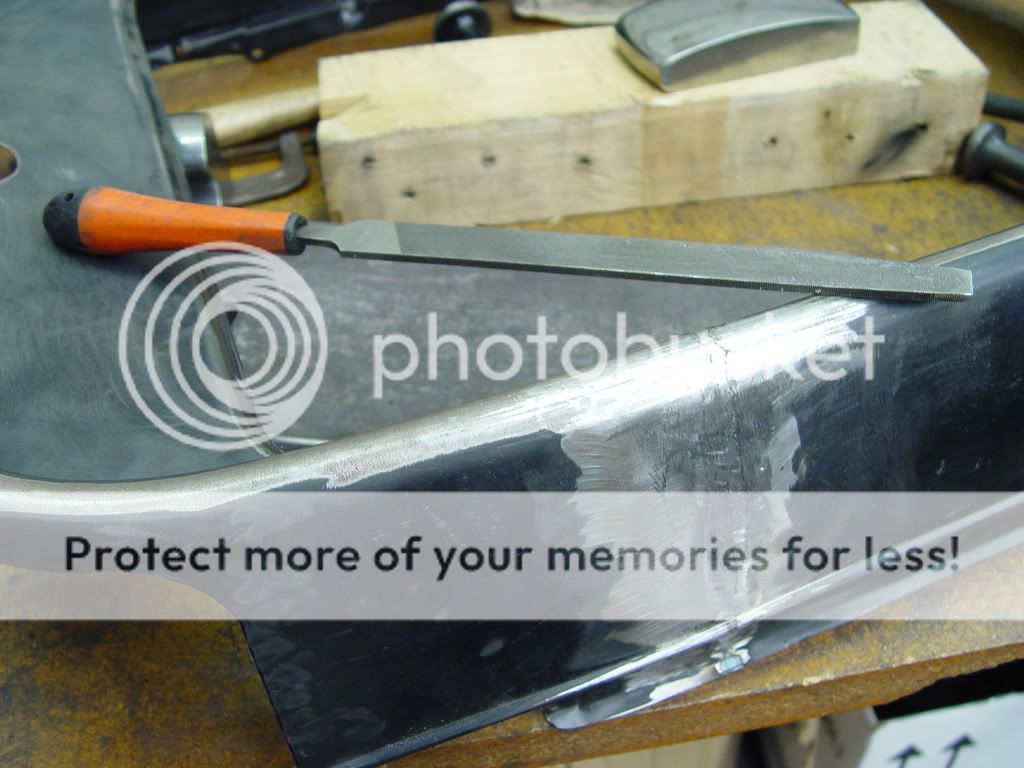

    Flat files also REALLY help for taking down welds carefully. Slow process, but will leave you with less of a mess in the end.
